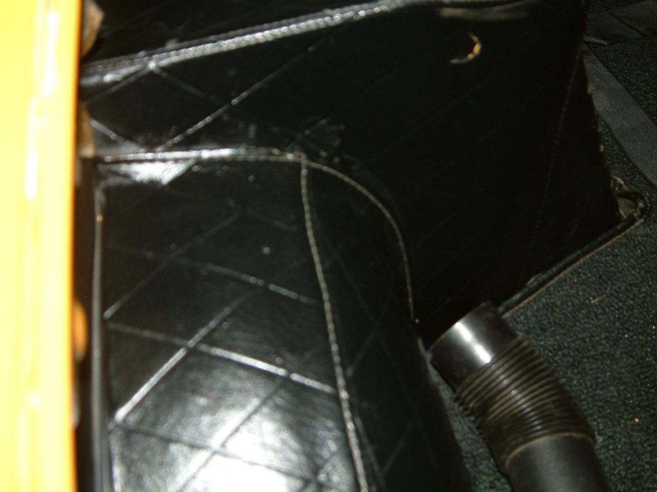

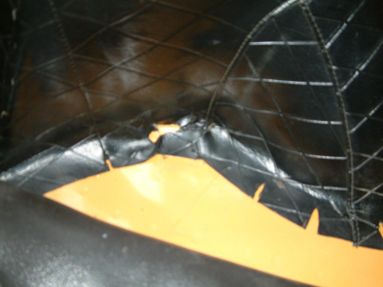

Well I did the strut towers and the came out ok. I used the spray adhesive included with the vinyl and it was a major pain in the a$$! The vinyl back kept sticking to itself and I had to keep pulling it up to try and straighten out the wrinkles. The vinyl was not a great fit but it will do for now. I think the other places will be easier because there are not as many angles and surfaces to get to line up. What do you do about the joint where the wheel arch and strut towers meet? Do you use a razor and trim the joint edges smooth? I will have to post pictures sometime.

The pieces will stick together no matter what adhesive you use. That is just part of the game. Like I said earlier, once you get past the towers the rest goes fairly well. I did not know you were installing new vinyl. I thought you were reinstalling the old. I have read here that the new stuff requires some stretching to get it to fit which is a good thing. Make sure it is warm, use a heat gun or blow dryer if needed and be patient. If you are having problems you could always apply adhesive to one area at a time then apply to the next. It slows the job down but you will get the job done confidently.
The wheelhouse trim goes on top of the strut tower edge. My original ones were seamed where they met the strut towers. So, the strut tower vinyl gets stretched down to the deck and slit in various places along the way to keep the vinyl smooth. Then the wheelhouse trim goes on top of that.
Do it in the order I said above.
Hard to explain, maybe the pictures will help.
