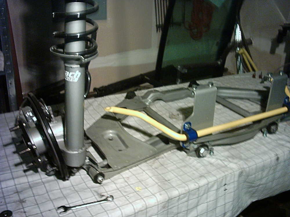

torker Posted November 2, 2010 Share #68 Posted November 2, 2010 For any who missed out on this group Buy, A friend of mine bought 20 of them, had them Media Blasted, Powder Coated in Black and is selling the R/T's as a Finished Kit with a Black Urethane Bump stop. Here's a link to his site, where he also sells some other 240Z ONLY stuff..........http://www.technoversions.com/DiffMountHome.htmlAt only $7 more, it's a hell of a deal.DaveDave , Thanks for posting this link. Still working on my sons car. Put a header on it for him and Got 2 1/2 " exhaust installed today:cool: Sounds great except for the "clunk". Found this old thread-yay. Still looking for pics of the rear lower control arms. I think someone flipped a left side arm and installed it on the right if that's possible. Link to comment https://www.classiczcars.com/topic/36492-rt-mount-group-buy-2nd-batch-whos-in/?page=6#findComment-334916 Share on other sites More sharing options...
Arne Posted November 2, 2010 Share #69 Posted November 2, 2010 Still looking for pics of the rear lower control arms. I think someone flipped a left side arm and installed it on the right if that's possible.Normal. The two are the same part number, one is flipped over. Link to comment https://www.classiczcars.com/topic/36492-rt-mount-group-buy-2nd-batch-whos-in/?page=6#findComment-334917 Share on other sites More sharing options...
Zs-ondabrain Posted November 2, 2010 Author Share #70 Posted November 2, 2010 What Arne said, no such thing as Left and right. That's what makes it a great part. Link to comment https://www.classiczcars.com/topic/36492-rt-mount-group-buy-2nd-batch-whos-in/?page=6#findComment-334918 Share on other sites More sharing options...
torker Posted November 2, 2010 Share #71 Posted November 2, 2010 Aha. It sure didn't look right. At the front bushing it is rubbing metal to metal. I looked at the rear one thinking it would have more clearance and maybe it was pushed towards the front but it is close too. On the drivers side with the a-arm flipped over there is a lot more room at the bushings. Link to comment https://www.classiczcars.com/topic/36492-rt-mount-group-buy-2nd-batch-whos-in/?page=6#findComment-334924 Share on other sites More sharing options...
Zs-ondabrain Posted November 2, 2010 Author Share #72 Posted November 2, 2010 Left side... right side.... is flipped over so the right side mounting tubes (that the bushings slide on) are the same as the left side in relation to front and rear. Confused yet? Try these instead, Dave Link to comment https://www.classiczcars.com/topic/36492-rt-mount-group-buy-2nd-batch-whos-in/?page=6#findComment-334943 Share on other sites More sharing options...
