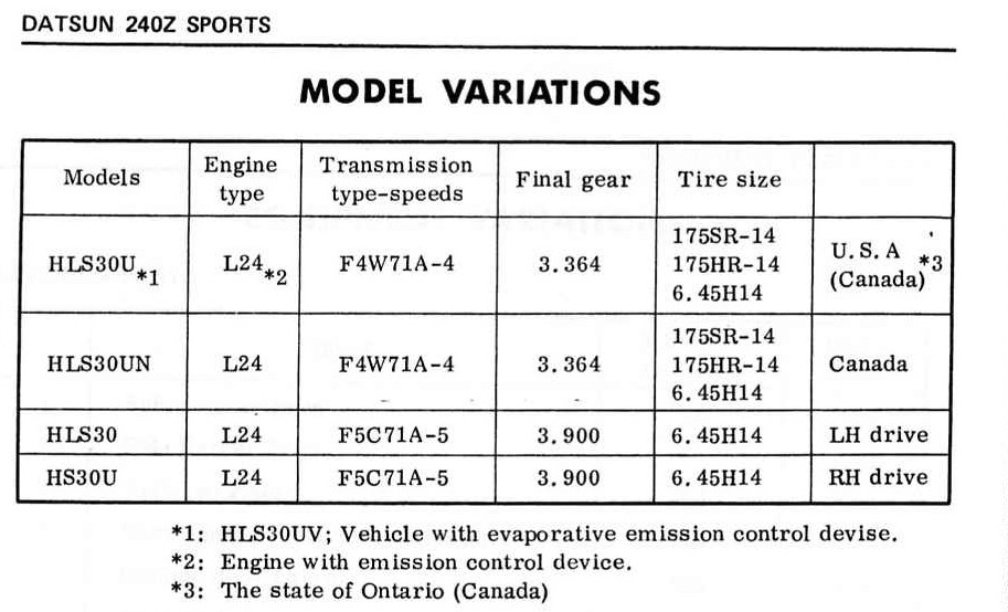

Dan and Ron,
According to Service Bulletin 125 (Introduction of Datsun 240Z Sports Model S30 Series), Ontario received the HLS30U model, which had the crankcase and exhaust emissions control devices, but not the evaporative emissions equipment (no expansion tank, different fuel tank, etc.). This is the same model as the low VIN cars in the US. The rest of Canada got the HLS30UN, which didn't have any of the emissions equipment. Later 1970 model US cars were the HLS30UV model with all of the emissions equipment, including the evaporative emissions equipment.
-Mike
