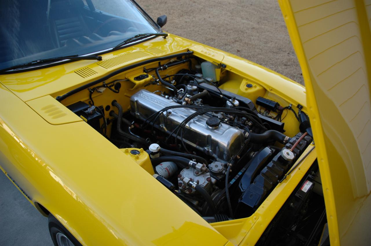

I've also seen louvers in the inspection panels to (apparently) help vent the engine compartment. These don't stand out as much as putting them on the hood, but I've no idea how effective they are. Mine car had these on it when I purchased it, but I've since removed them and have stock inspection lids on it now (you can see them in this pic, sorry I don't have a closer one)
