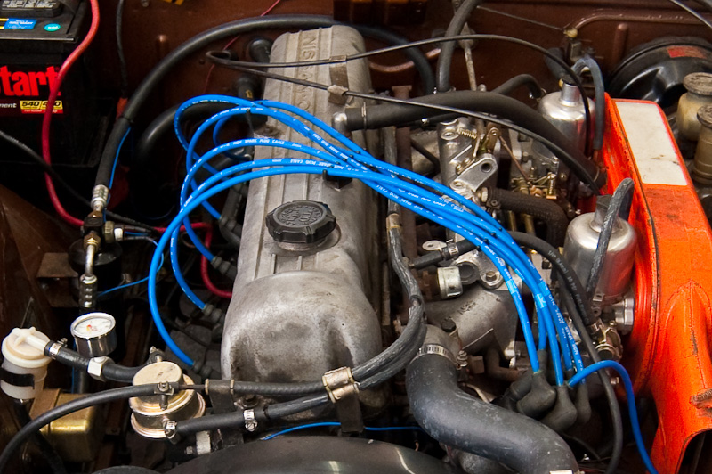

No direct experience, but on my carbed Z I couldn't touch the fuel rail on a hot day. I replaced it with rubber and also got rid of the mechanical pump which is bolted to the head, and between the two mods I never had vapor lock again. If you had an IR temp gun you could find out how hot the rail is and then determine whether it is worth addressing.
I slit a rubber line up the middle and used it to wrap my metal lines. That way you have the rigidity of the stock lines with less heat up

[ATTACH]37431[/ATTACH]
I daily drive my 240Z in south Texas and I have had no issue with vapor lock.
It's still bolted to the head though. Might be a good idea just to check how hot the fuel lines are underneath the rubber hose. If it's not a problem then it's not a problem, but I think getting rid of the connection to the head was an important part of what I did.
