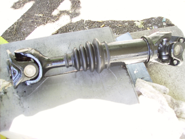

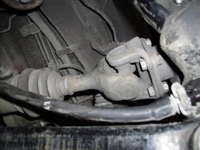

Took a look at the driveline, checked all the bolts, driveshaft as well, and found a little play in the passenger side half shaft. Pulled it yesterday & discovered alot of play in the inboard u-joint, bearings shot.
Had both joints replaced with Neapco joints at Drivelines NW (did a great job, 2 hr turnaround) and refurbed the rest of the shaft myself.
Got it back in, went for a drive and the problem is Gone!
About and 90% improvement. Very pleased, much smoother & no unusual noises.
Will pull & check the driver side shaft tomorrow for peace of mind.
Drivelines NW ... Recommended
