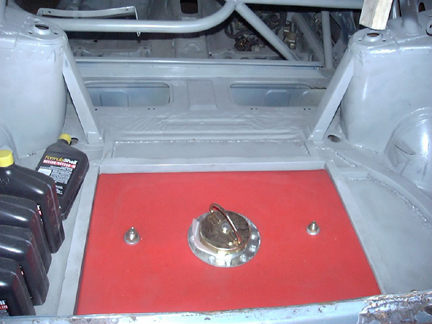

Ok so I have fabbed up and welded in a really nice NASCAR style cage for my fuel cell. I have welded it in and patched the floor areas surrounding where the cell is now.
Upon closer reading (read "first time") of the GCR, I need to bulkhead all of the inlets and lines.
How have any of you guys done this in the past? I am curious as to how this should look when done -- I definitely understand the purpose for this, but am not sure if I should just build a hinged cover over the whole assembly or not..
Thanks!

My fuel cell is low enough that I just cut a thin piece of sheet metal and screwed it over the area that I cut out. I cut a 8" square (approximately) access hole so I can get to my cap and mounted an access door to a hinge to cover the hole. I used one of the twist locks from the stock 240 access panels behind the seat to hold it closed. I've seen other guys, whos cell sits higher, build a raised box with a hinged door. Pretty much anything goes as long as there is a bulkhead -- there are no specs as to how thick. It can be steel or aluminum.

Yup, that's the way I did mine. Much less work if you mount the cell low enough to get everything under the floor board. Only time that would not be possible is if you were using a 16 or 18 gallon cell for enduro's. 12 gallon or less should be able to be mounted completely under the floor.
BTW, the lower you mount the cell, the lower the center of gravity, and if possible, try to mount it just off center towards the passengers side. It may help to balance the car by offsetting the weight of the driver.

16 Gallon cell is already in -- I was afraid to drop mount it below the floor pan as it would then hang rather low... In retrospect it would not have been such a bad plan but oh well -- it's mounted in more solidly than the original tank was...
So my idea of building a raised box type lid should be sufficient... I will hopefully be able to post pics this weekend!
