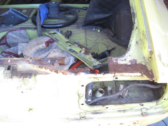

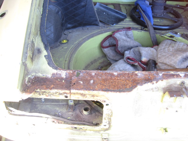

Surely you can find some rust free z's out there to cut up! Besides, yours might not be that bad.
I was starting to fab up my own structure as shown earlier in the thread and it was coming out pretty decent-and I'm not a body man. Though I do have a state of the art bench vise and 2X4'sLOL

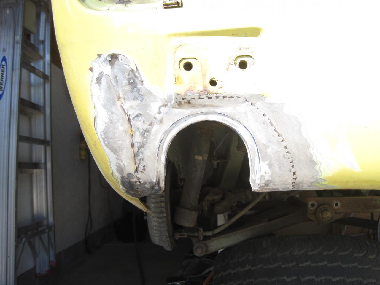

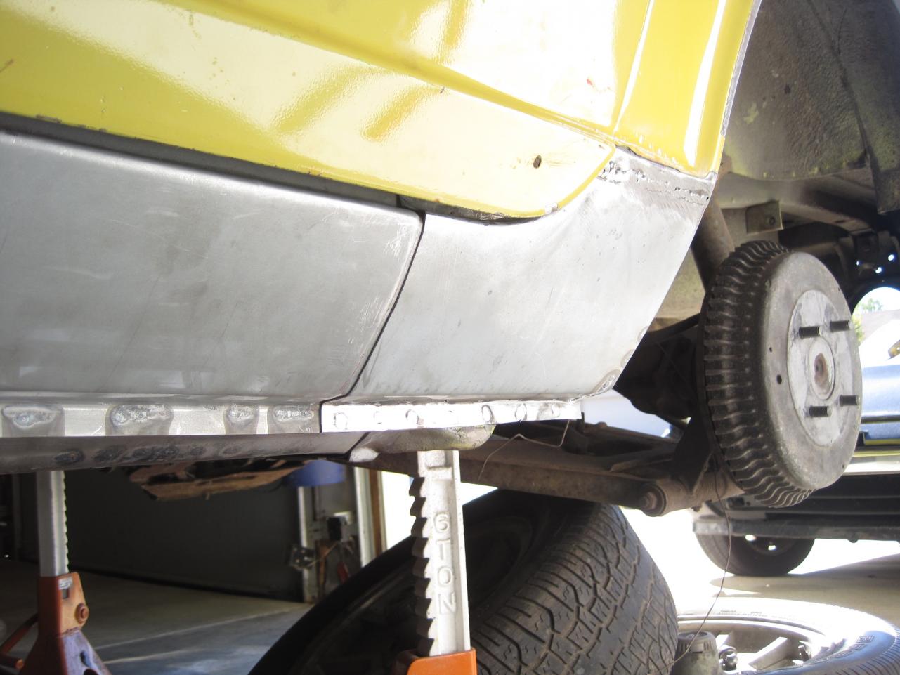

Well it has been some busy Z days around here. I am almost finished with the sheetmetal work done on this car. I was able to haggle with the vendor over the bad rocker attachment points and he refunded me 40$, so crying does help sometimes;)
All in all the rocker fits pretty well. The dogleg wasn't bad either, but great inconsistancies between panels. The passenger side had barely enough material and the driver's side had too much!

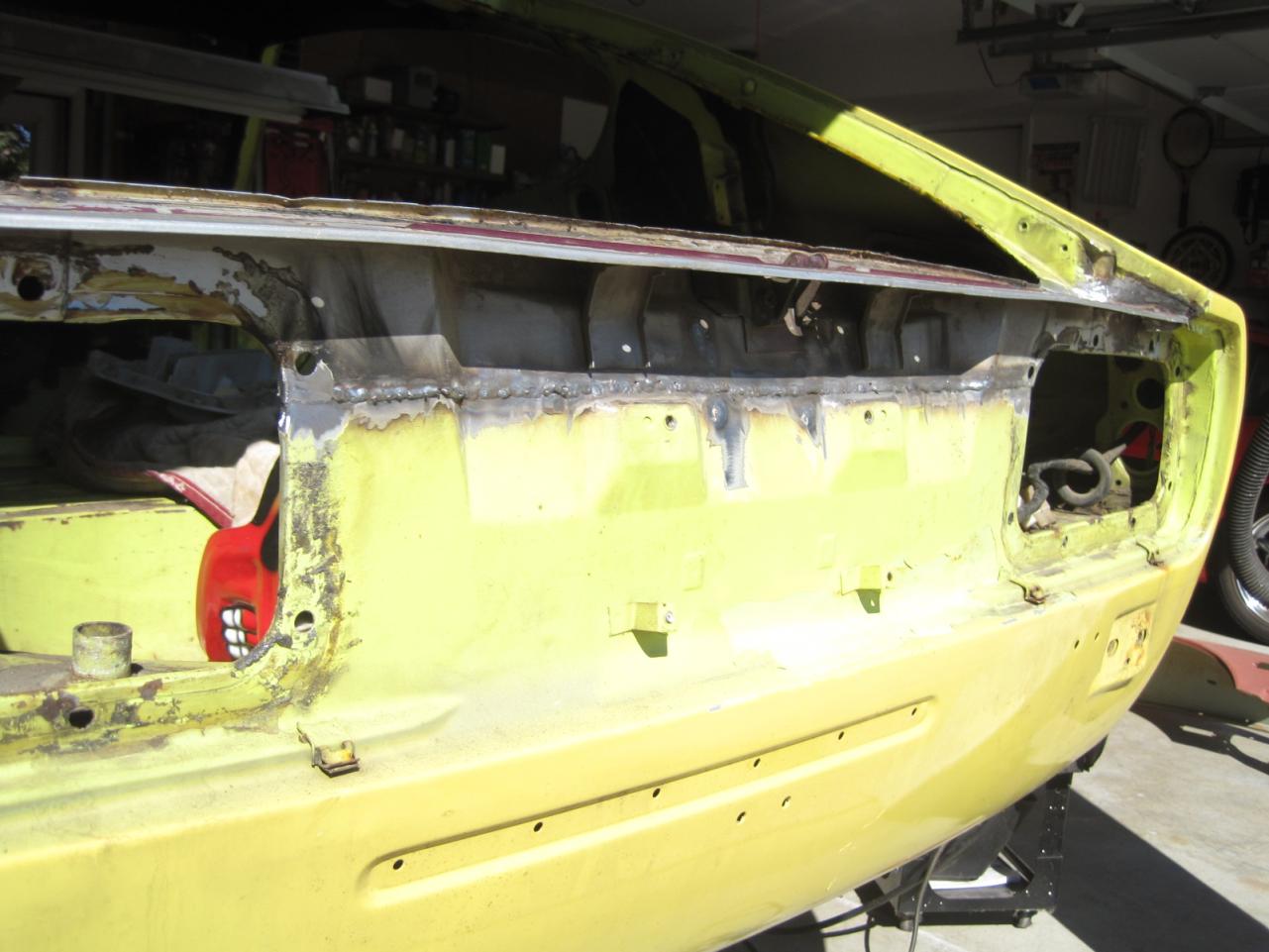

I finished up the hatch area and that panel was a lifesaver. The more I dived into this car I realized it was hit pretty hard in the rear. The rear frame rail behind the valence is 1/2" away from touching the rear valence. I'd say these repairs were done many years ago since everything was brazed together, but good welds though.
Also had to weld in an exhaust outlet since the old one was mangled-thank god for donor cars

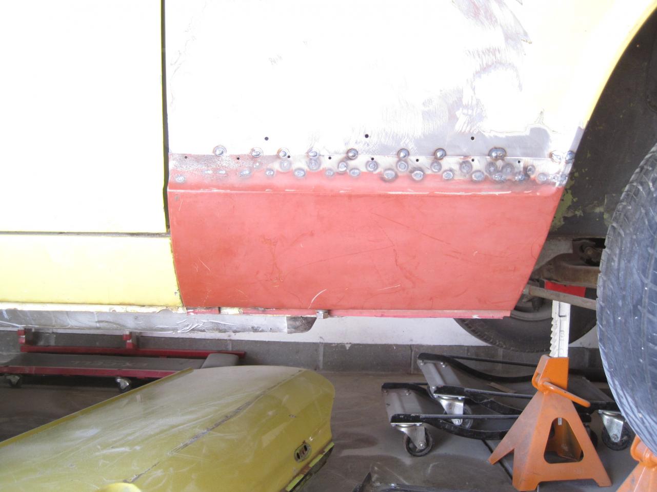

Well after a year of working on this car, when it fit into my schedule, it is about ready for the paint shop. The last hurdle was the passenger fender. There was a pound of bondo in the lower section to fill rust and damage. I was skeptical about patching in a lower, but it seemed to work out pretty well. A few more tac welds and I'll call her done.
Now it's time to do some metal prepping and seam sealing to keep the rust at bay for the rest of her life.
