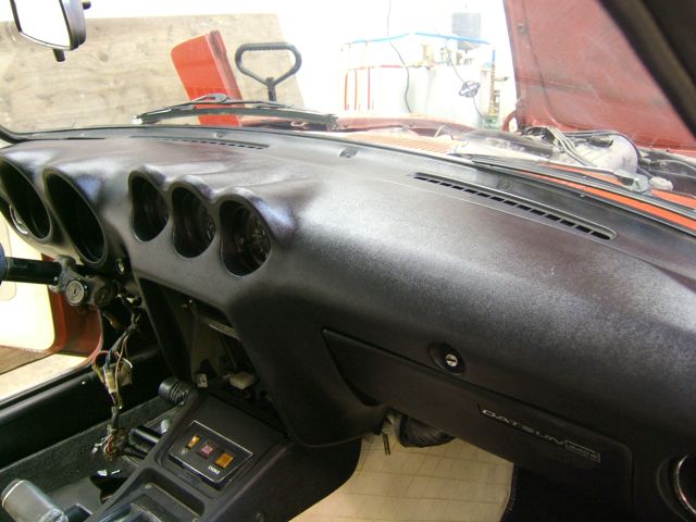

I stumbled into a crack free oem dash for my 72. It has been in the car and in a garage all of its non-driving live (43K miles). I don't know what, if any, care it has had previously. I am terrified if I park the car in the sun one afternoon at a show and shine event, it is going to crack. What do I put on it? Armorall? Something better? Any thoughts?

At the time these dashes were manufactured, PVC sheet could not be used due to its stiffness, so "plasticizers" were added to the PVC compound prior to extruding to make it more flexible. Adding enough plasticizer resulted in Naugahyde for furniture. The plasticizers, unfortunately, outgas from the material over time and at elevated temperature, causing it to become brittle and subject to cracking. UV damage also plays a role, though I'm not sure how much. Modern automotive interior components no longer use this PVC material, and tend to last much, much longer.
While there are many products on the market claiming to restore plasticizers, that simply can't happen. Many products are silicone based and provide a longer lasting shine. However, adding shine won't help stop plasticizer outgassing.

A note regarding the silicone oil technology. I've read that the original formulation for Armor All and other silicone oil based protectants used a variation of the silicone oil that would bond to the plasticizers in the plastic, and that when the silicone oil would leach out / evaporate / gas out, it would further extract those plasticizers it had bonded to. This was the biggest reason that at one company I worked for, that sold PVC Strip Curtains that we would specifically discourage the use of Armor All on the clear PVC. The biggest reason was that it left the PVC cloudy and could cause a traffic hazard, but also because it aged the PVC faster and warranty issues came into play.

Would you care to "tempt fate" and press your thumb down hard on the top of your dash between the Tach and Temp Gauge to see how flexible it remains? I have a couple of old dashes, from Texas 240Z's and the vinyl is still flexible in the front and sides, but very brittle on the top. It cracks with little effort. Don't get me wrong, I'd be very interested to know how long you've used ArmorAll and if your car has been garaged most of the time, etc. If you search the Internet you'll see a raging debate going on about the effectiveness of these "protectants". More data is always good. Thanks.
