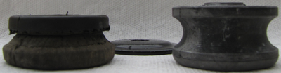

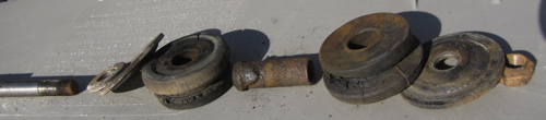

The two new tension rod rubber bushings I bought from the local Nissan dealer (and 4 from MSA) are thicker than the originals (see pic) and seem thicker than can be accounted for by the old ones being under compression for a long time. Is that because the new ones were made for people going to the one rubber, one polyurethane bushing install and not for people like me who want to use all rubber with no polyurethane bushings? I am installing these on a 240Z, MFR date 1/70. I wound up with 6 of these bushings because Nissan at first said they didn't have the part and then two showed up later even though I had ordered 4. Maybe I got the last two from somewhere? The Nissan dealer and the MSA part appear identical as far as I can see. Thanks for any info.
Mike
I put new rubber T/C bushings on both my '70 and '71 and they were both a challenge. I remember pushing in the rubber and washer while turning the nut at the same time. I will need to do my '73 here shortly, so I will try the jack trick.
Regarding the bushings in the pick, mine were pretty thick; as thick as the larger one. I am not sure if they compress over time.

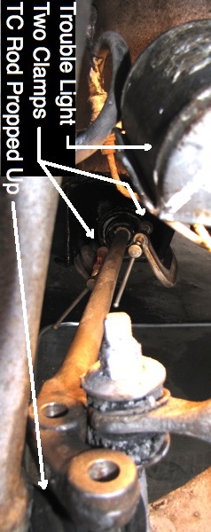

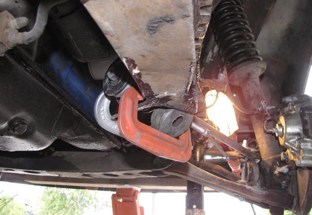

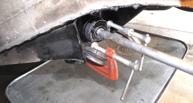

Thanks for the idea on the C clamps, I happened to have a couple of 6 inch C clamps and got that to work for me once I had the large steel 2 inch washers flipped the right way so that the smaller contact surface was toward the rubber. I used a spare bushing to keep one of the clamps from slipping off the steel washer. Attached are pictures of the position of the clamps and the position of the wheel end of the TC rod propped up with a 2nd spare bushing to maximize how much of the TC rod threads stuck out of the end with the clamps for the nut to grab onto in case that helps anyone else.
I put POR 15 on any metal in contact with the rubber (2 inch steel washers, frame mount point and 2 inch metal cylinder bearing inside the bushings on the TC rod) and put grease on everything else.
Mike
