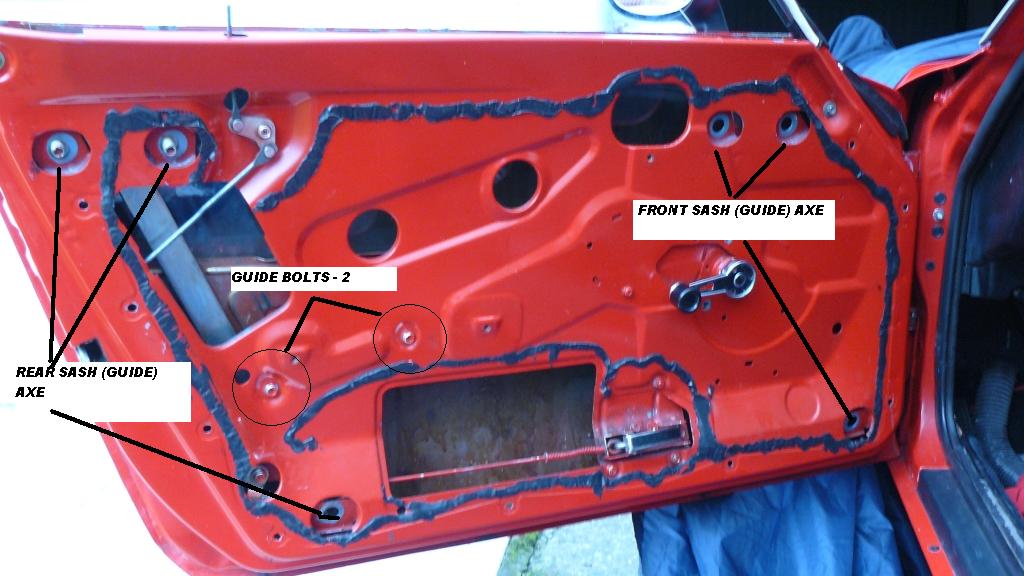

Well. in the haynes it said to first remove the front axle, which is the right one. The way you say it, to remove the guide channel in the middle first seems more logical. I´ll take another picture of the entire door itself. if possible, can you point out on the picture where I need to remove ?
I must say that the layout of the door is a tad different than the layout in the Haynes.
The two bolts circled hold the GUIDE CHANNEL to the door frame.
Removing those will allow you to remove the glass from the door and then have access to the mirror bolt.
