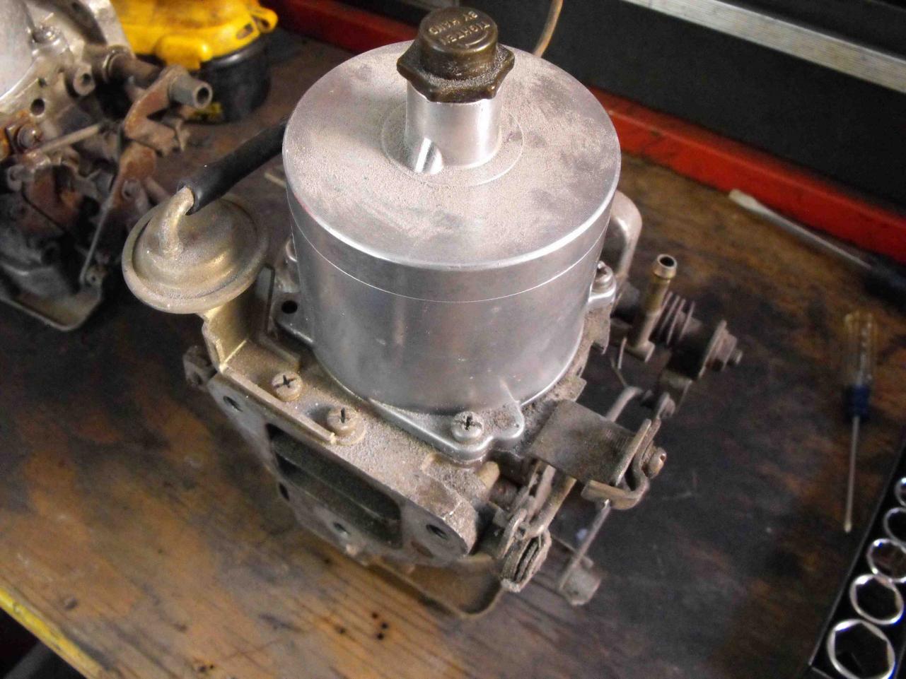

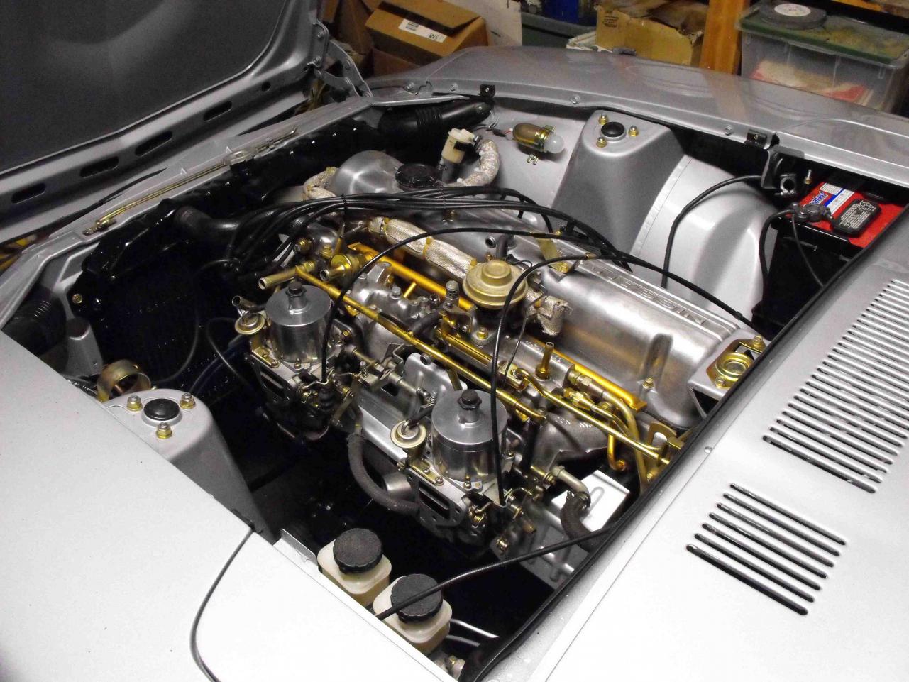

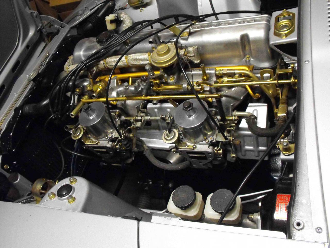

Carbs are just about ready to install which is great news. I picked up a pair of sweet looking flattops from 'grnsky' for just $20, such a deal:classic:. (My old ones would have required quite a bit of work to prep - but I will keep them as spares). The zinc looked good on the new ones, so no reason to re-zinc. I just cleaned them up with a little lacquer thinner and Nevr Dull. I polished the domes and then mounted the carbs temporarily in place. I want to re-zinc the bar in the center before I do the final install.

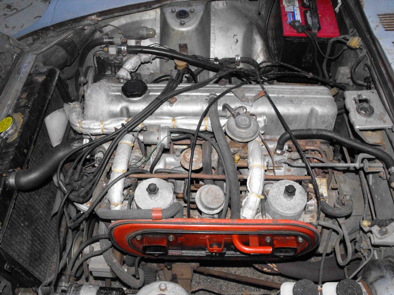

Its nice to see the progress. Attached is a picture of the old carbs and the original engine bay.

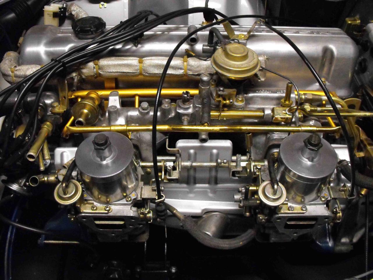

Do you mind sharing what brand of insulation you used? :) Are my eyes messing with me or did you use gold colored zip types to match the zinc?
The insulation and zip ties are all the original parts. I just used a little Windex to clean the insulation. ( I wonder if there is asbestos in that stuff. I will make sure not to eat it or chew on it :ermm:)
The zip ties are just real old. They are kind of vanilla colored in person. I was thinking of replacing them with new ones, but really haven't searched to see if they are available. I think I will just leave them as they are for now. Although, if I could find some NOS ties in good/white condition I would probably replace them.
Looking great! I bet there aren't many examples of well running flat tops in such presentable condition. My hats off to you. I remembered reading about two different types of insulating wrap that was used in the "Modification Plus" manual, so I looked it up. I have a couple of them in storage that I am keeping just for reference.
