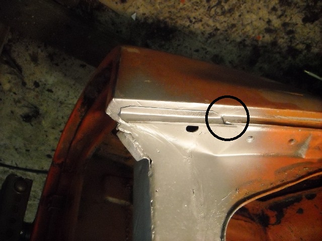

I removed what was left of the panel in question on my project 260. After patching the body underneath I made a new one out of 16ga. galvanized sheet metal. It hasn't been installed yet but the plan is to raise the forward part of the panel so it slopes to the rear of the car. I've fitted it & it appears that it will work fine.
The body, in that section, appears to have rusted from the bottom up. Much more work to be done at the rear of the car. spare tire well etc.
I am about to do the same repair on my 240z, and I saw a thread along time ago about welding an extra part on the original "gutter".
Link for the thread: http://www.classiczcars.com/topic/45387-what-to-do/?hl=%2Bhatch+%2Bdrain#entry411736
I am going to do it with a bit more original look, but i really like the idea that Grannyknot posted  :)

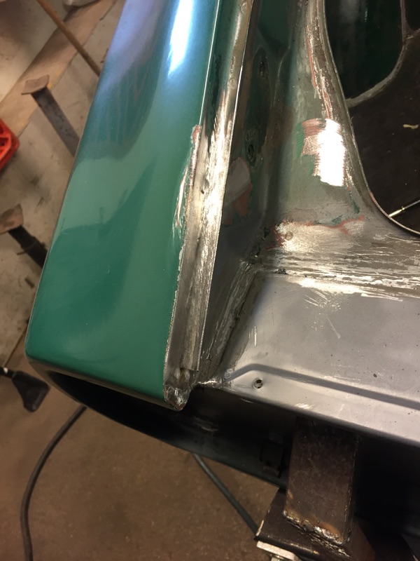

Werup, thanks but I just want it known that it wasn't my idea, I just stole it off someone else on this forum.
But it does work well and I think the added chanel wouldn't even have to be welded on, some seam sealer would probably do the job
Chris
Do you mean to put a thin line of seam sealer to create some kind of channel?  The OP wanted to extend the gutter to the bottom so it drains directly out of the shelf, and the only thing I can think of is to use a bit of square plastic tubing.

So here is what it looks like on my car, welded in to look original :) A little rough at the moment, but are going to the sand blaster within a week.
