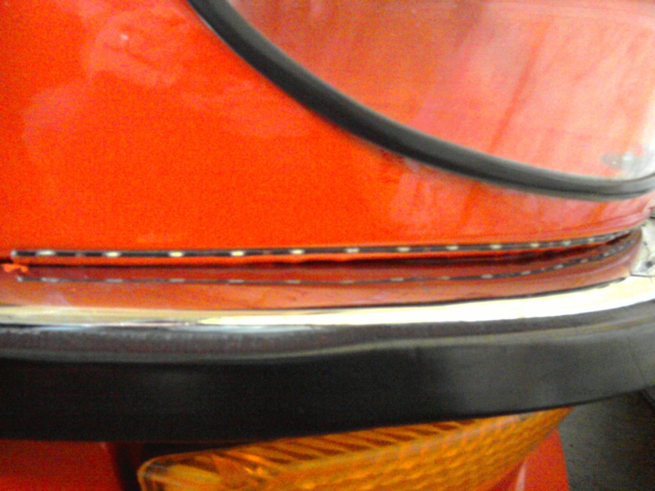

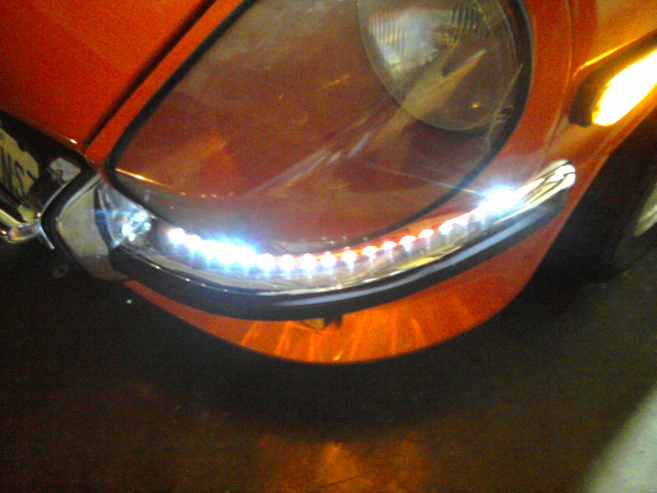

I used a paper towel with some rubbing alcohol on it and cleaned the painted area just above each bumper on the headlight buckets. I installed the new strip LED lights in the tight area between the bucket and bumper and had to use a plastic window stick to push it back and into place. Then used a roll of 1/4" painters tape to cover only the LED's on the strip, taped off the bumper and headlight buckets and painted the rest of the strip the same color as the buckets so the Black strip wouldn't stand out as much.

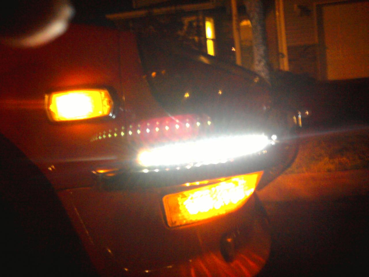

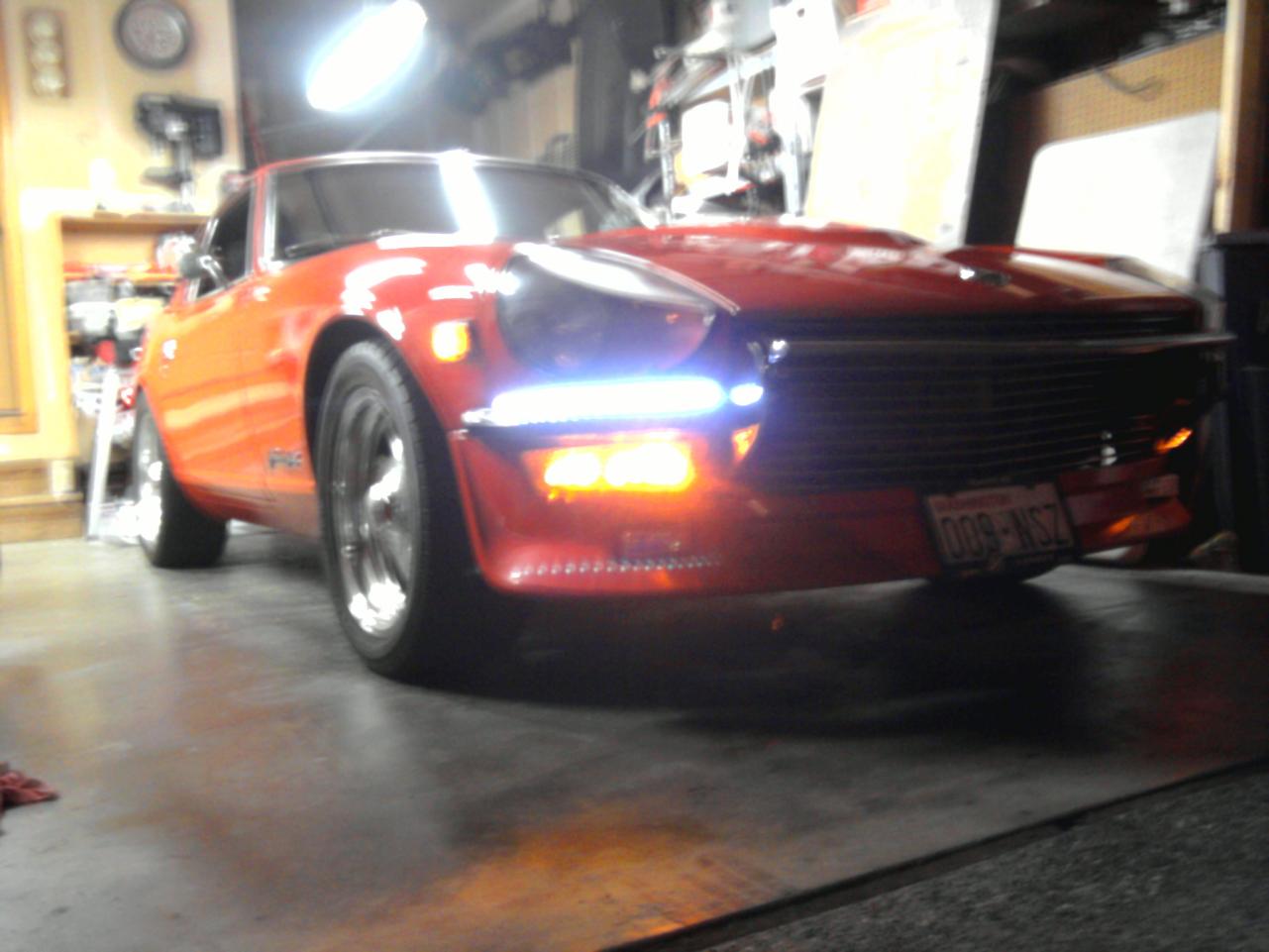

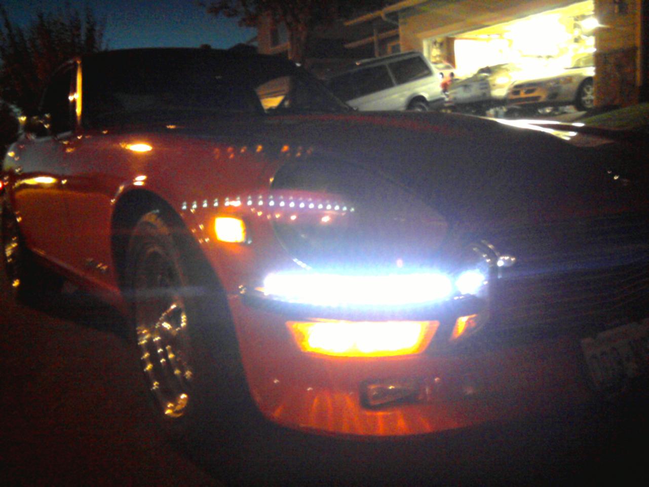

Wired them into the Sidemarker connections in front of the radiator and waited till it got dark. The camera phone needs a glare filter as they look SO much better in person than on film. My Kodac broke so phone camera is all you get for now.

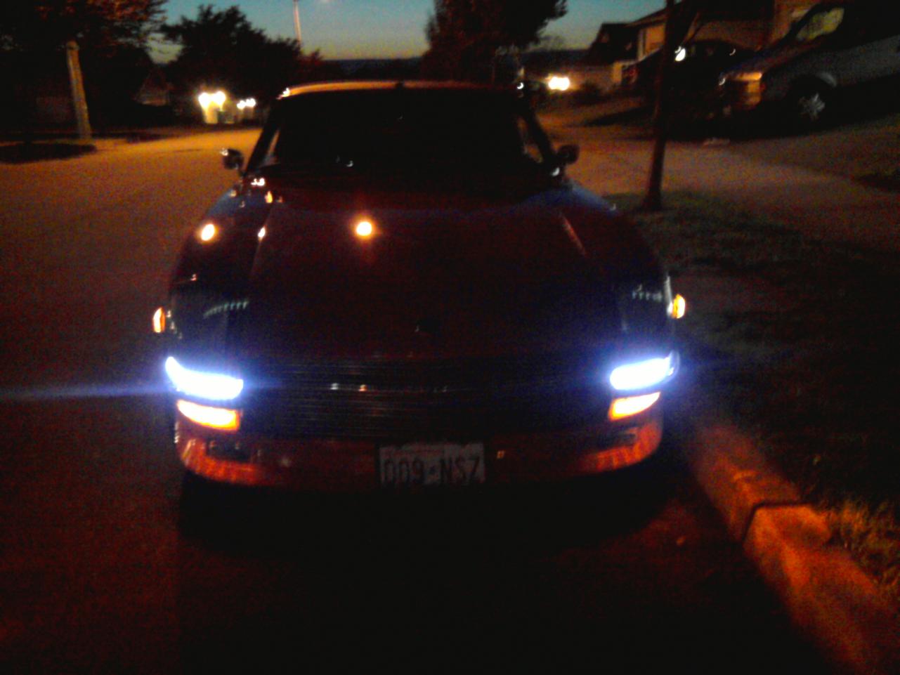

They look sweet without the headlights on, right around sunset. The wife told me that so it must be true. in a few of the pictures, you can see there are 18 white LED's in a few of the reflections, which are closer to what they really look like. Damn I need a new camera with a filter.
