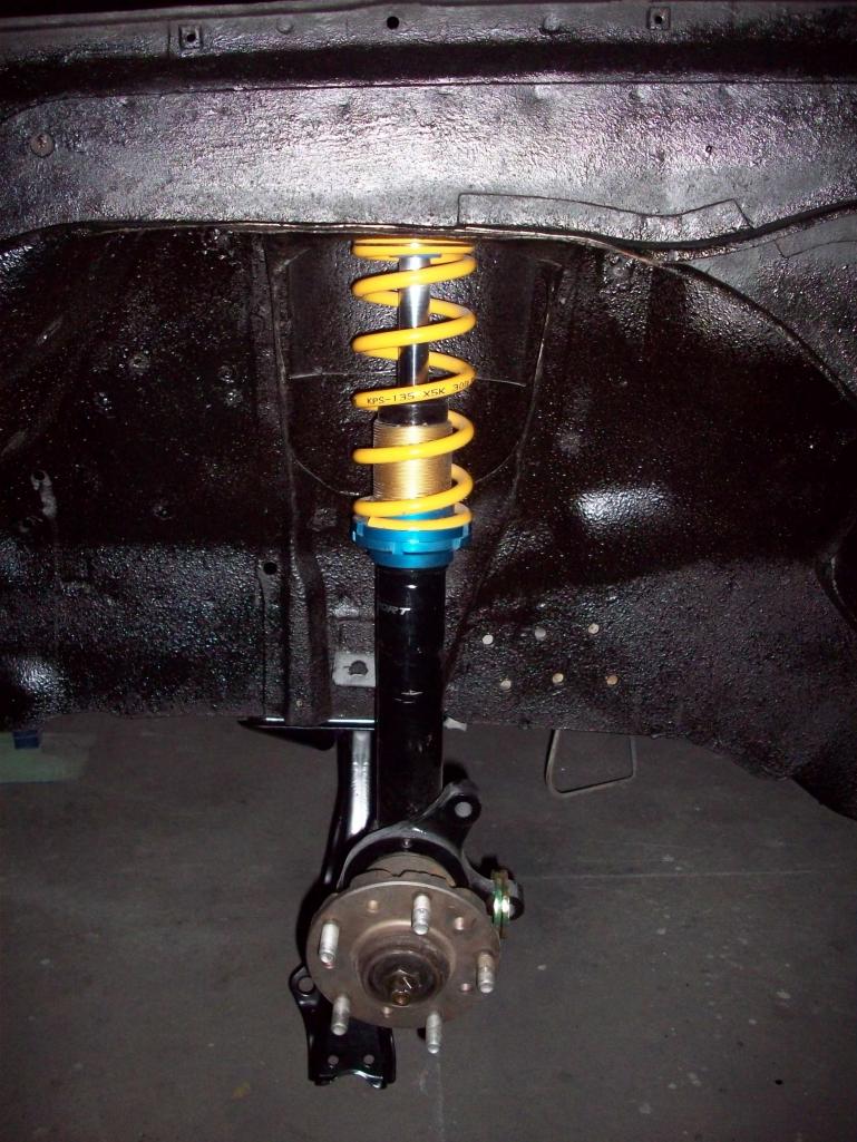

Iam looking for lowering coil-overs for the kgc110
so for the front I can use the 280zx ones
and how about the rear coil-overs ?
http://www.z31.com/mods/coilover.shtml
at the bottom of that page there is one method of putting adjustable height suspension in a non coil over shock type rear suspension
The conversion I used on QWIK was to use a z31 you can also use a r31 strut, the little difference between the two is the spacing in the rabbit ears for the brakes, the z31 will let you use the z32, r32, r33 brakes without any ear extensions. It dosen't matter if you use z31 or r31 strut you still use the z31 inner suspension, these are about 1 inch lower than the standard 240k and you can get them as HEAVY DUTY, a z31 coilover kit fits straight on them.....This was the easiest way of converting and lowering the front.....This also passes engineering, expesically if you want to use twin spot calipers......
i would love to see that get through engineering :)
seriously.. would it? looks a little "unsafe" to me..
im not sure, personally i would change it a bit like weld on a better seat for the spring but the idea isn't 1/2 bad, i wish my engineering knowledge extended to car laws... :<
