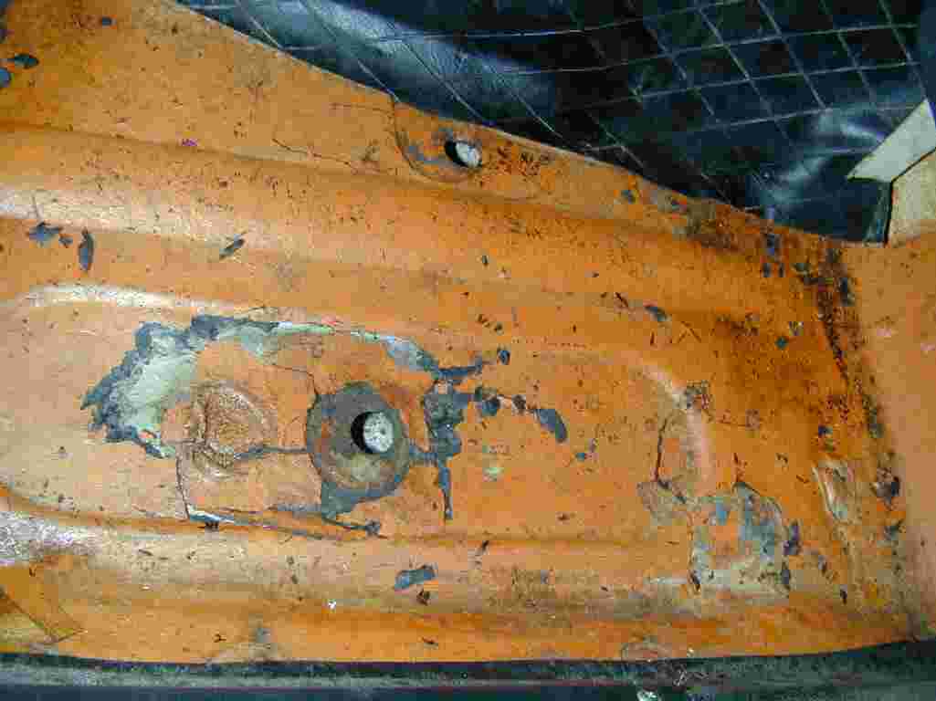

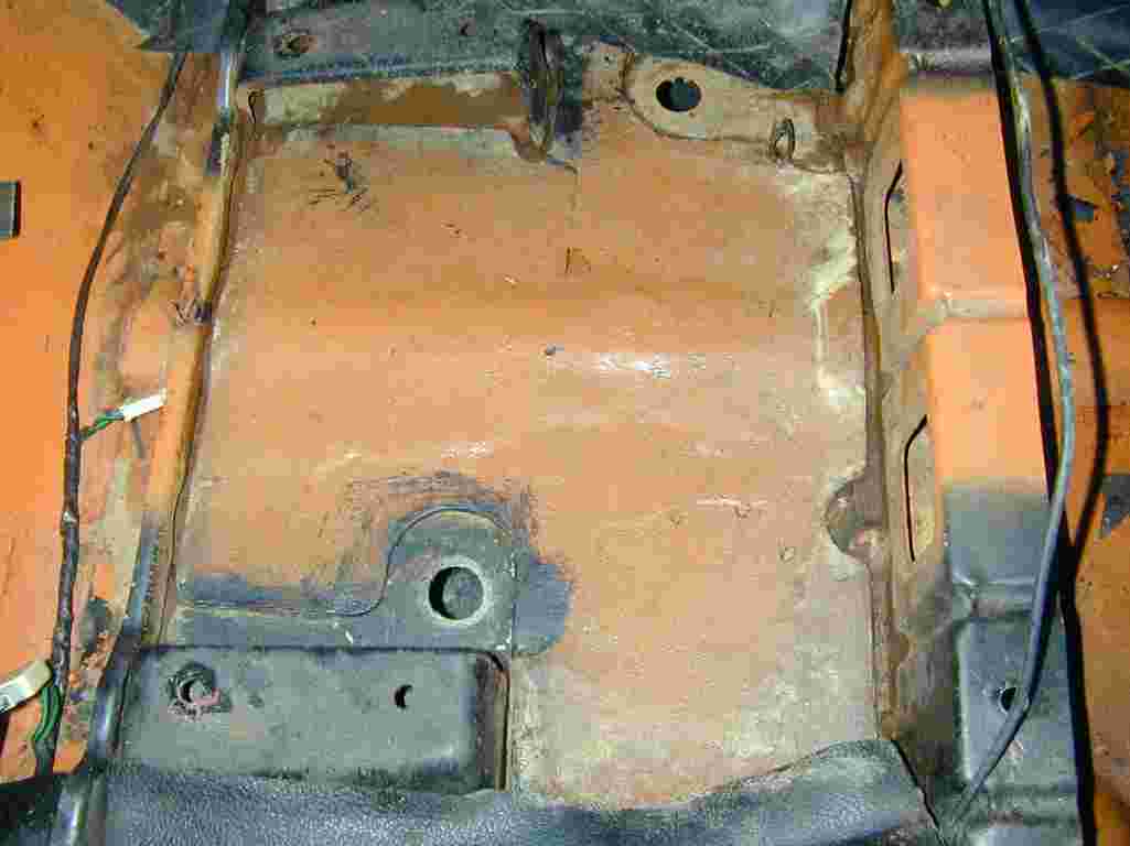

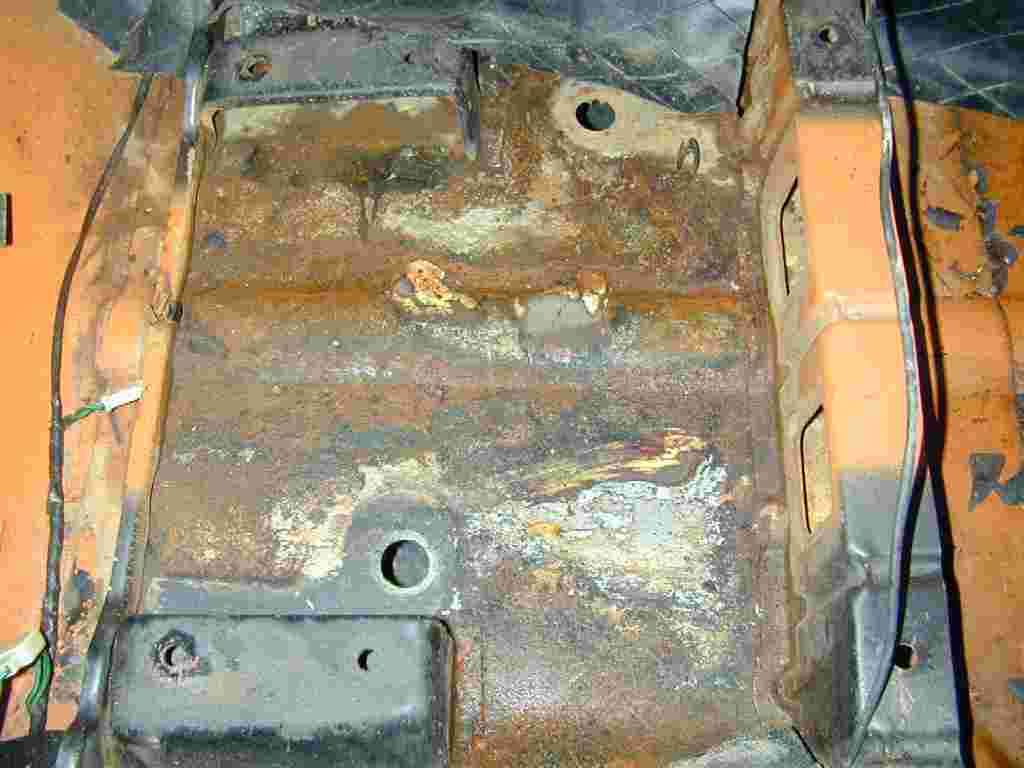

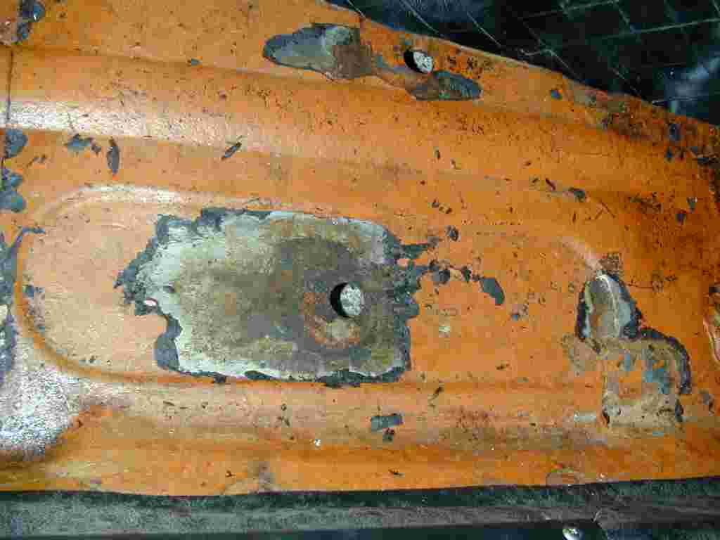

When you say "there is paint under it and no rust", I cringe.
Here are two pairs of pictures. One pair shows the passenger's foot floor area, the other shows the area under the seat.
While there was some indication of rust, it didn't seem to be as bad as the actual problem ended up being. You may definitively want to look at the floor's condition. If your car is a Concourse competition candidate, then you may want to consider if losing a couple of points is worth having a rusty floor.
As far as the padding, go to either a Marine Supply house or specify OUTDOOR use carpet padding. Just be careful of getting the reconstituted sponge rubber padding, as it really is pieces of sponge rubber all glued togetherl, and you don't want to put a sponge in contact with your sheet metal.

What E is saying is that just because it looks rust free, it may not be. In the photos he provided, you can see "rust free" ... er, well... not so rust free once the paint was removed...
