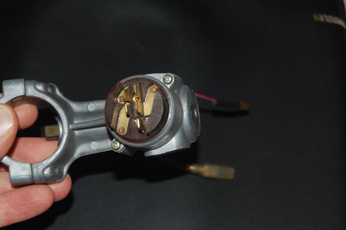

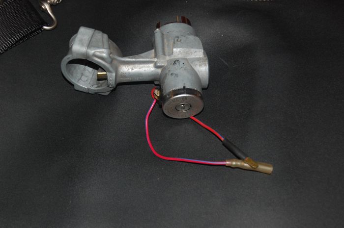

OK, that's tougher. First, I'd need to pull the column cover of, then try to get my honking big camera back in there to try to take a meaningful picture.
But this is really pretty simple, as the ignition switch/lock only has one large connector (5 pin), and two small wires (generally red w/blue trace) for the key-in-the-ignition squealer. There's really nothing else to it, and not much that you can mess up.

This is from the 73 FSM. Chances are that your wire colors are the same.
Expect a six wire plug with five wires and the following colors:
Black with Yellow stripe
Black with White stripe
White with Red stripe
Blue with Red stripe
Green with White stripe
There should be two other wires, one with a male spade and another with a female spade. One of those wires is red.
Download a copy of the FSM and look at the Instrument Harness page in section BE for details on the plug.
