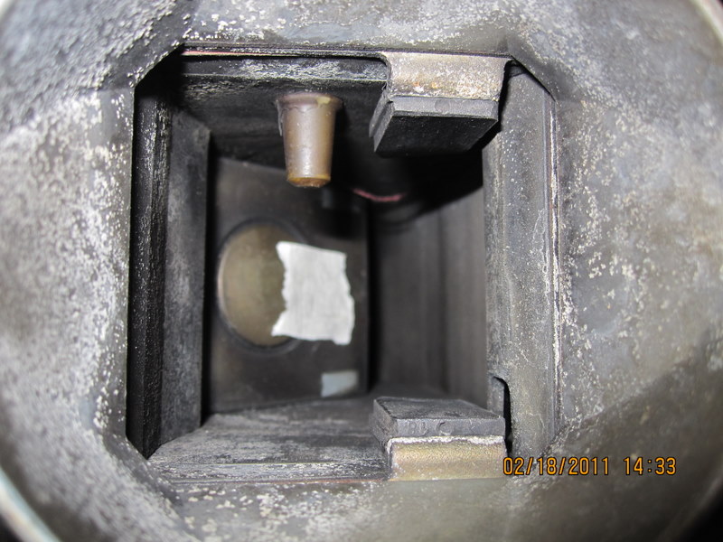

Zed Head Posted February 18, 2011 Share #248 Posted February 18, 2011 Here is a single mid-vane data point if anyone ever has the urge to see where their AFM falls in comparison. 1978 AFM 9.62 volts across pins 9 and 6 Output measured at pins 7 and 8 AFM bore pointed down and leveled Mid-vane measurement taken with a taped roll of 28 quarters hanging by a thread from the edge of the vane. Vane Closed 4.74 volts (49 % of input) Vane Open 0.12 volts (1.2 % of input) 28 quarters 0.488 volts (5.1 % of input) The first two measurements tell about the potentiometer and the last one tells about the spring tension. The vane was only partially open with 28 quarters hanging from it. I tried 20 quarters but the thread rubbed on the housing and I could not get a consistent number. I have attached a picture so that you can see how far open the vane is with only 5.1 % of the input voltage going to the ECU. This might seem like some nonsense but it's pretty interesting. If you consider that the ECU is also using small resistance readings fromthe various temperature sensors also, it's easy to see how things can go wrong. Note that this AFM ran well on a parked car, and had normal (100 and 180) resistance readings but I have not actually used it under load. Except for starting the car in gear on jack stands and applying the parking brake while the wheels were turning, to test it. It sounded good. Fun, fun, fun... Link to comment https://www.classiczcars.com/topic/37707-76-280z-question-on-distmanifold-vacuum-dist-timing-fuel-pressure-brake-booster/?page=21#findComment-346462 Share on other sites More sharing options...
