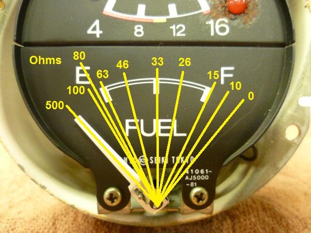

To answer your question about how much current goes through the gauge for the different readings, here's something I whipped up for a later year. No guarantee that the numbers are the same for your 72, but I suspect they are. This is sender unit Ohms vs needle position:

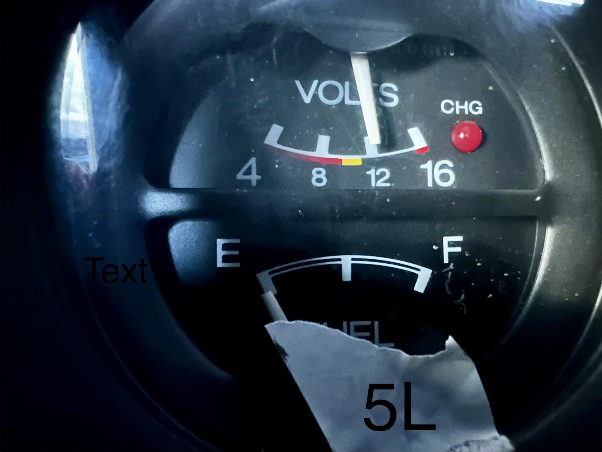

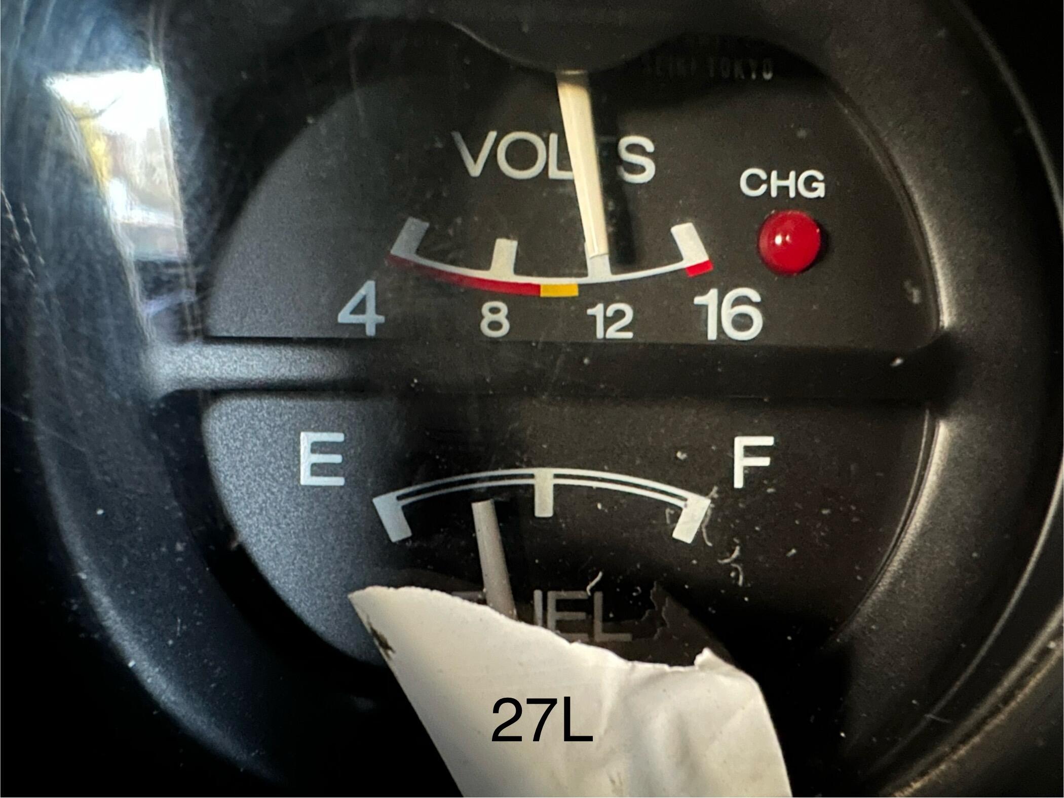

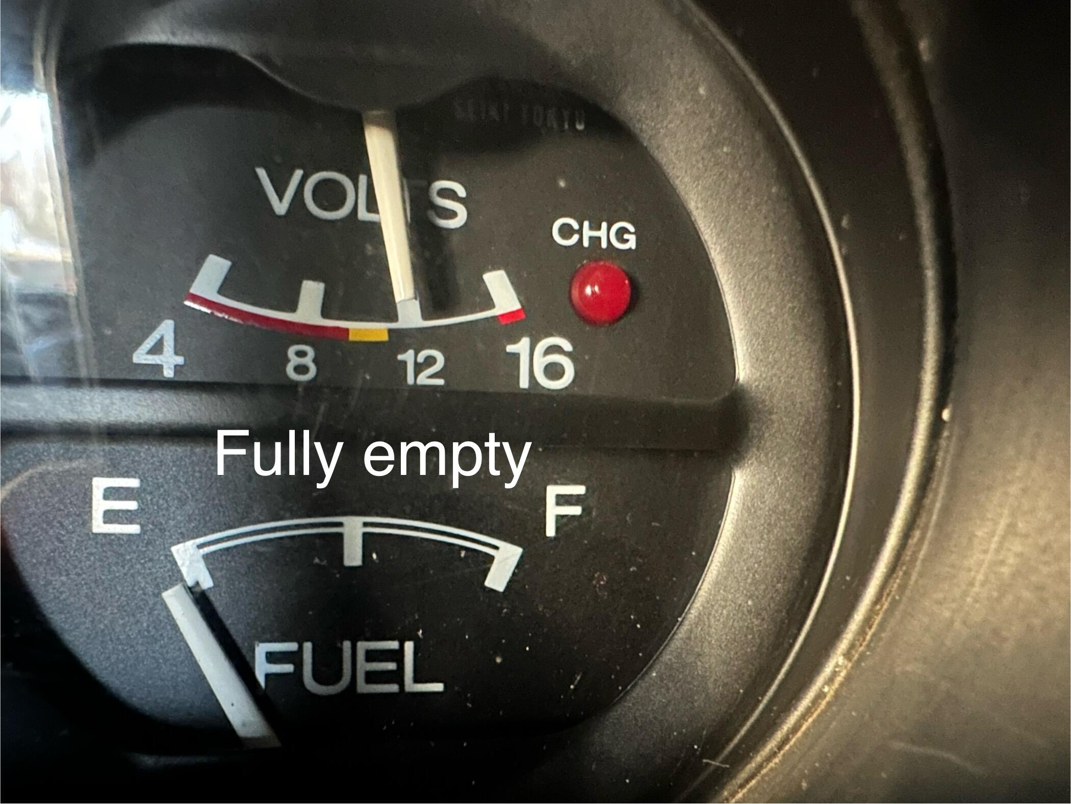

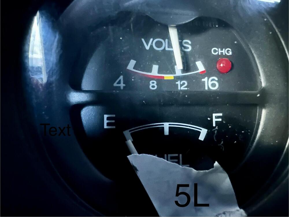

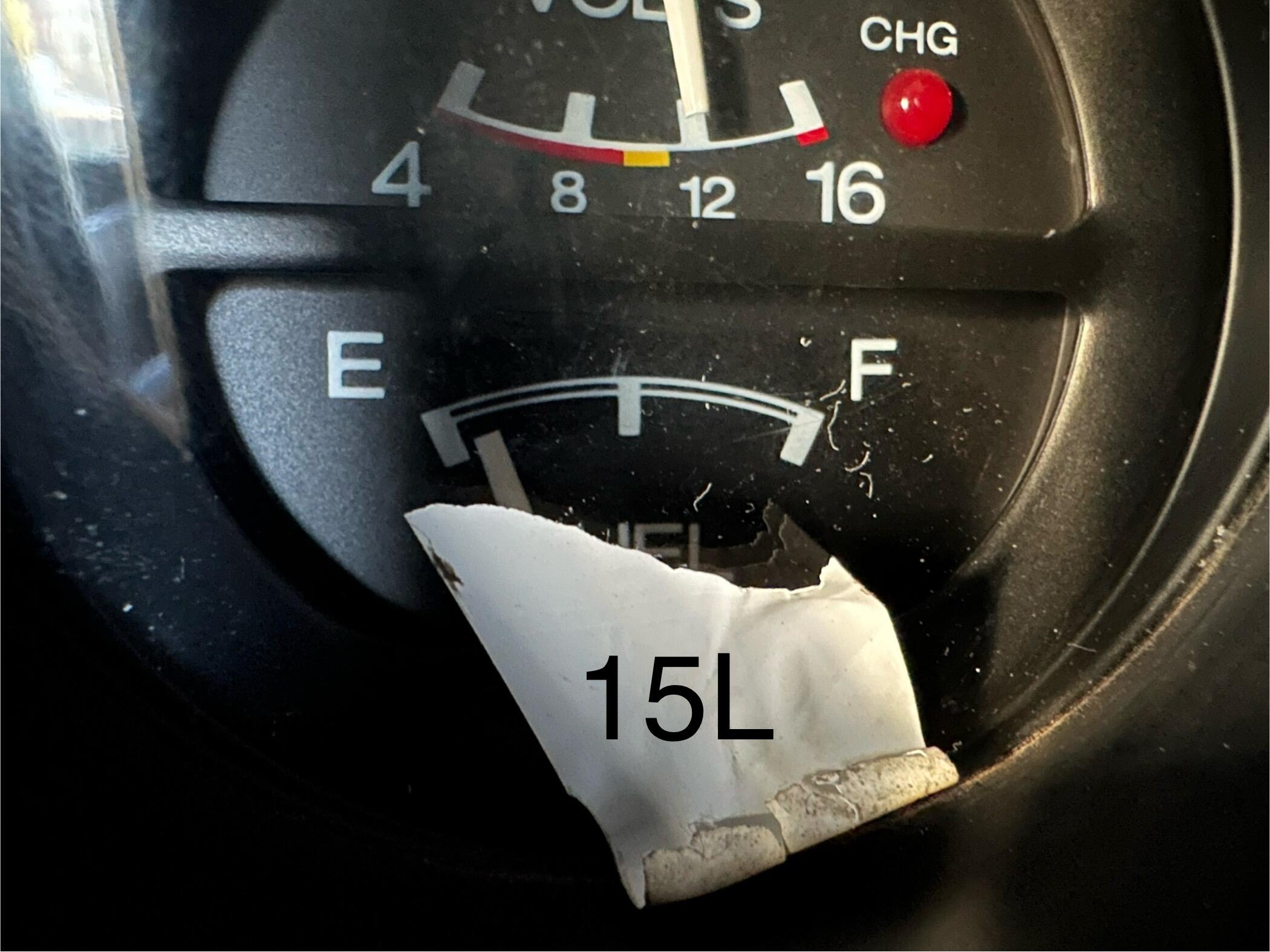

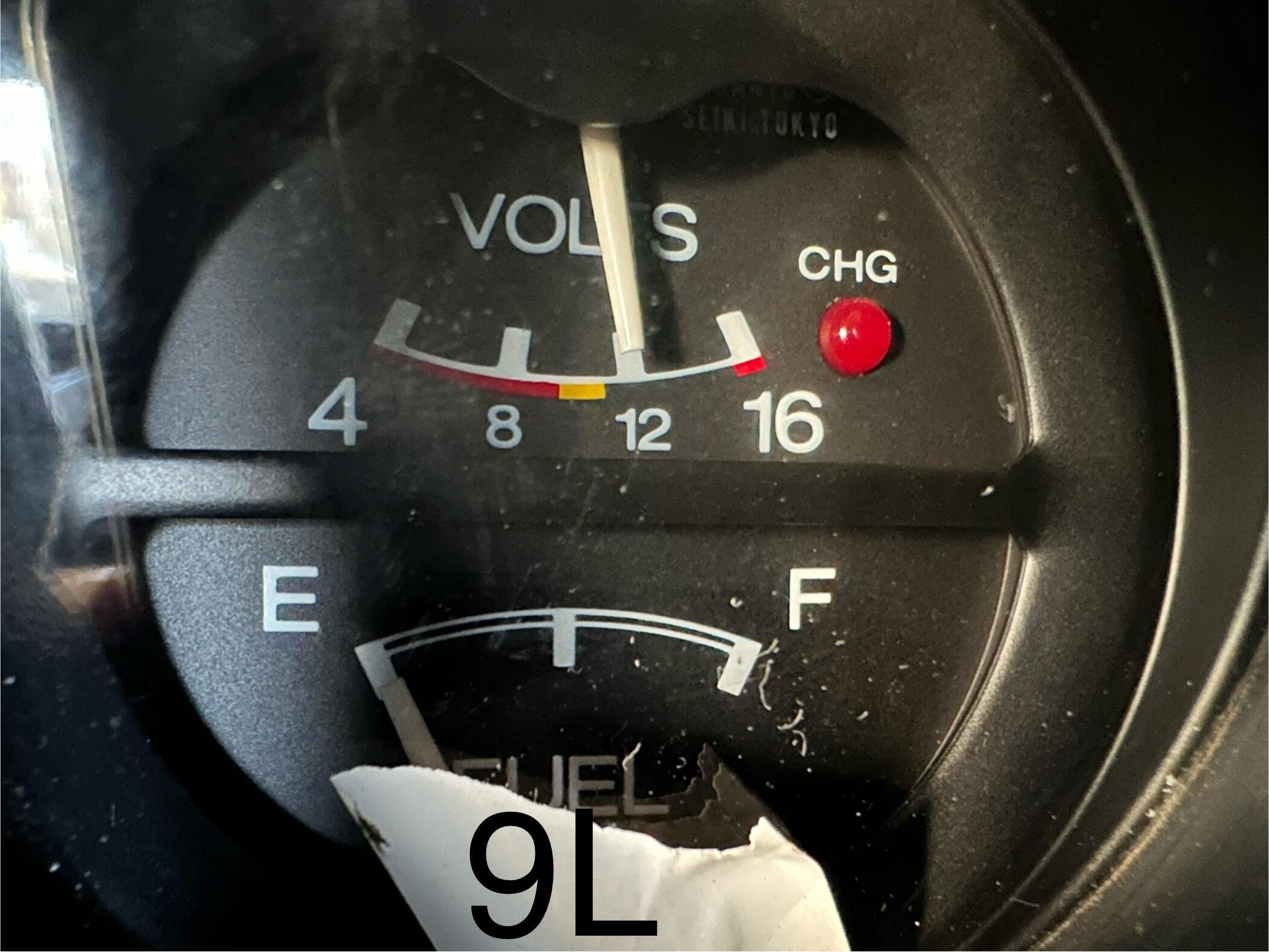

So I started by draining the tank completely and adjusted the sender bend for fully empty to not be way below the mark but “just” below.
Then filled up and observed the needle in 5L increments.
9L is c. 2 imperial gallons (5.54L / gal). Knowing my typical 15-17mpg average (with a heavy right foot), that gives me a safety margin when on E, but an uncomfortable one that I won’t be visiting unless it’s an emergency - as it would suck all the potential crud at the bottom of the tank.
The edge of the white tape aligns with needle position at totally empty.
I really wanted to know the 15L position as that is roughly 1/4 of a tank and I tend to fill up before that. But I now know where a true 1/4 tank is.
Finally at 27L with all the fuel I had to hand - I believe a full tank for a European 260z is 65L (tested by shoe horning 63litres at the pump) so another 5L and it’ll be roughly at half a tank.
This is progress as I will now trust the gauge more. With another 5litres, the needle will be pretty close to half. But I suspect it will be shy of it.

I'm not sure what year your Z is. Up through 76, I believe the specs are 60 L for fuel (15.85 US Gallons) for the North American model. I would assume a 77 or 78 260Z (if they exist in the UK) would have the larger tank like North America. The problem is that I don't think the sender does anything to account for the shape of the tank. I'm not sure if the adjustment screws would help, either. The top 2/3 has only about 1/2 the width of the bottom third.
To simplify things due to the fact that I have a simple mind, we can model the tank somewhat like this:
So the darker grey top half is about equal in volume to the light grey bottom half. Since the tank is 60 L, that means each portion is 30 L. That means 15L would be 1/6 of the way to the top of the tank, and 27 L would come up to a little under 1/3 way. It looks like the gauge readings are somewhat consistent with that.

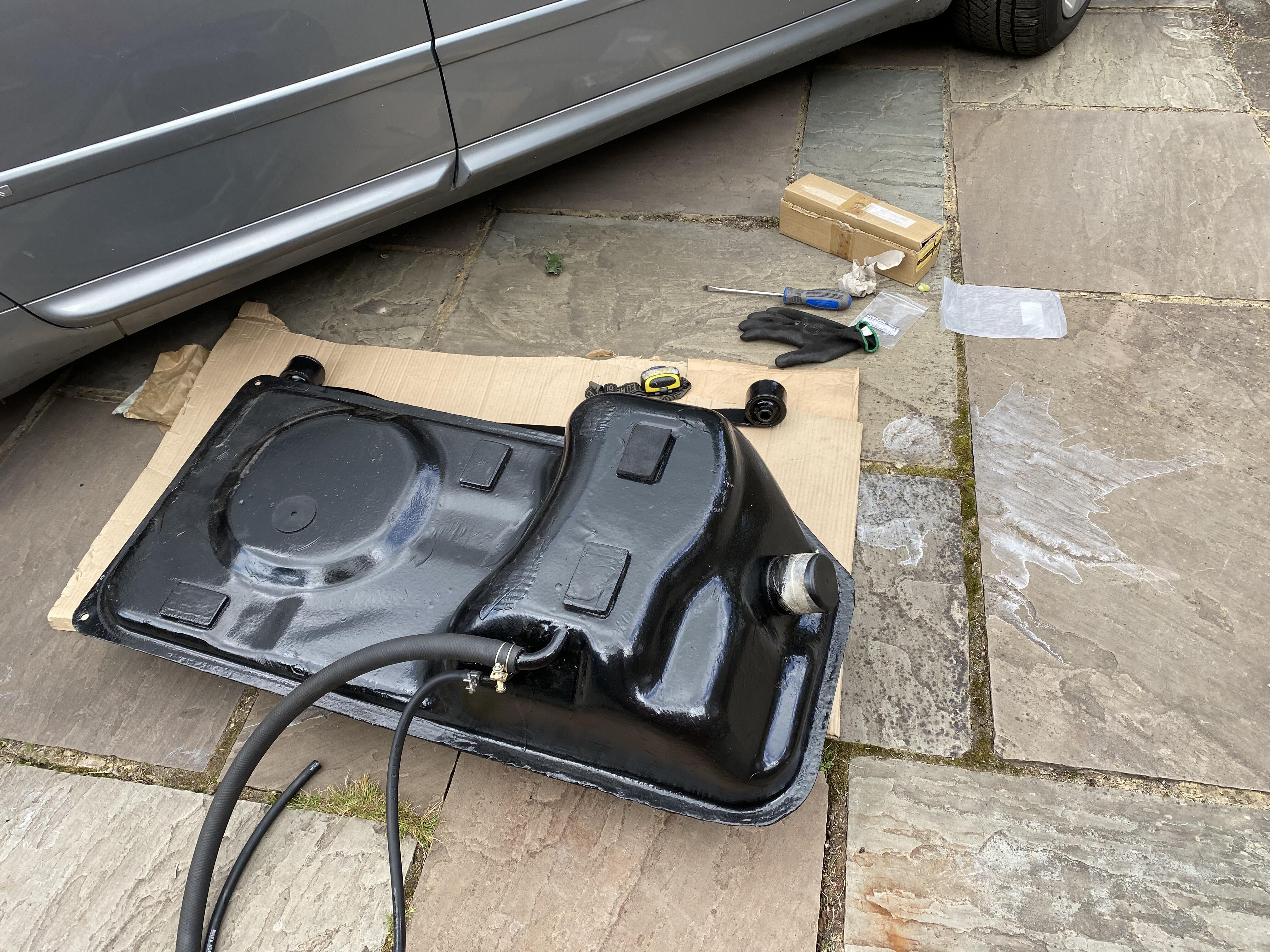

It’s very similar to some 280Z tanks that I’ve seen advertised on eBay. Here’s a pic from when I was refreshing it during lockdown.
That top breather hose with the crazy 180° loop was crushed on mine and instead of buying a reproduction one for a small fortune (which likely will go again over time), I opted for IIRC 17mm ID hose and inserted a 15mm pipe bending spring into it. Or was it larger? I can’t be sure.  Regardless, the stainless steel pipe bending spring works a charm and will never let that pipe crush again. Before this fix, the top part of the tank wouldn’t fully fill and the needle only went to just over 1/2. I suspect it was because it got to the level of the smaller breather pipe just below it. Made filling up a lot cheaper 😛

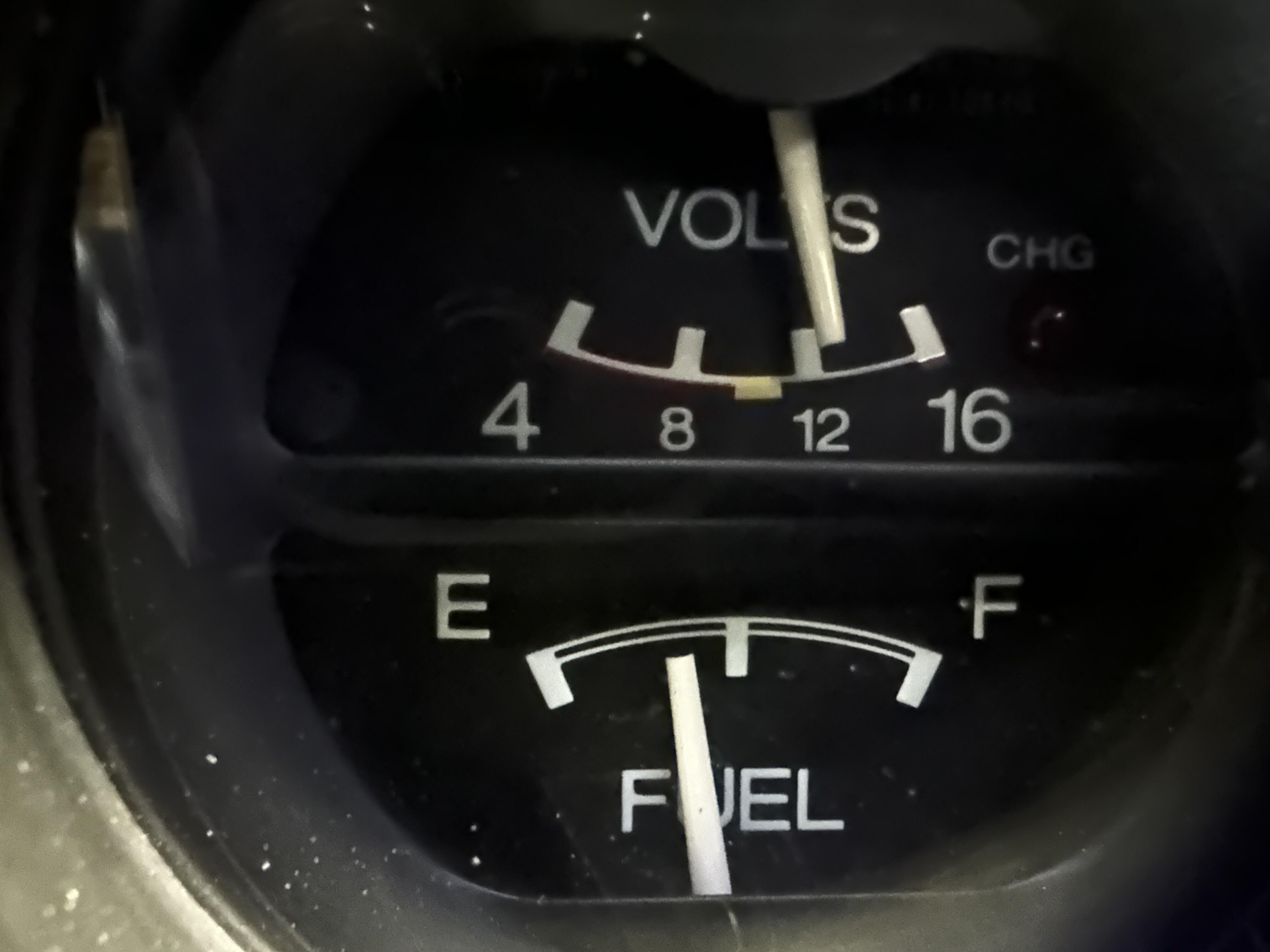

And here it is with 32L in - as suspected, not quite at half way but the best it’s been ever.  I’d rather leave the adjustment where it is so that I’m certain about the 15L and the 9L positions.IMG_4533.jpeg
edit: one of the guys in the UK club who’s had Zs for 40 years was saying that apparently they read differently when warm! I suspect it’s something to do with the voltage regulator electronics inside the gauge!
