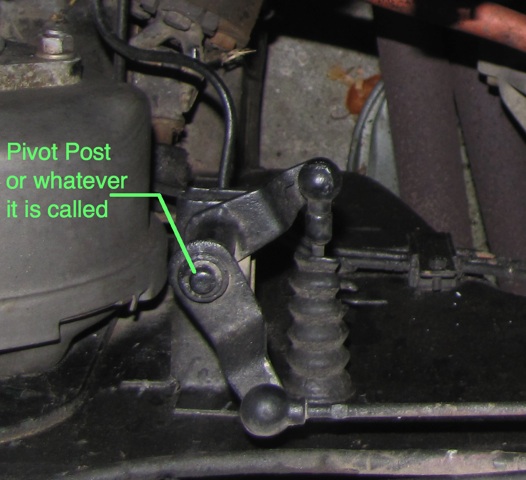

My 71 did the sudden takeoff off from idle. I had cleaned the linkage and didn't get improvement not that that would never work I imagine. In later years I wondered if the throttle butterflies had dragged on the inside, on the side of the carb but that car was only 5 years old back then and I wouldn't think it would have done that at that mileage point. My current 70 240Z doesn't seem to do that for some reason and the linkage is still in the stock configuration as per Ron's posted link to a solution involving a modification. One thing I didn't do on my old car (as opposed to my "new" 40 year old car heh heh) is to take the "pivoting post" off and lube it.

I had the same problem you describe in post 17. I cleaned (removed and polished the inside of the plastic and the ball with a Scotchbrite pad), lubed (white lithium grease) & adjusted the throttle rods. The rod from the bell-crank to torsion rod was on spec (7-3/16") but the rod from the pedal to the bell-crank was long. It was readjusted to spec at 4-1/4". This mostly cured the problem.
Believe it or not, the final thing that made the on-throttle transition much smoother was a clutch adjustment. My clutch was engaging too high and when I lowered the engagement point the high break-out force of the throttle wasn't as noticeable.
Sorry, I was unable to view your video. However, I went through a similar situation with my car, where there there was a sudden "jerk" upon acceleration.
Any point at which you can increase the radius of the "driving" member, and decrase the radius of the "driven" member will assist in smoothing out the transition. I believe there are at least 3 adjustments in the system where I bent the linkages to accomplish this. I even took off the accelerator pedal and bent the heavy rod beneath it so that my foot would contact the pedal further down. All of these together really helped the problem that I was having. I also rebushed the linkage that is attached to the firewall.
