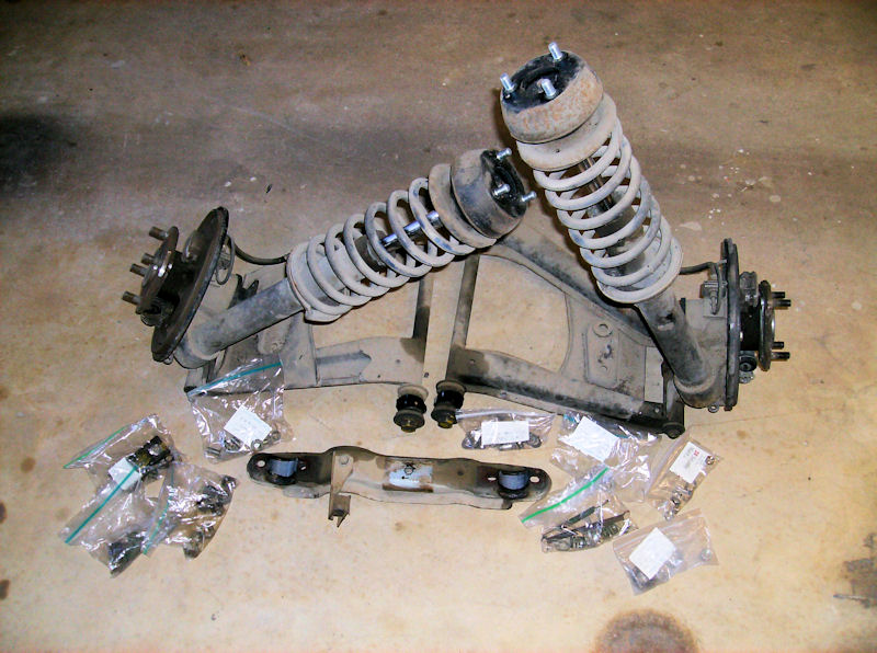

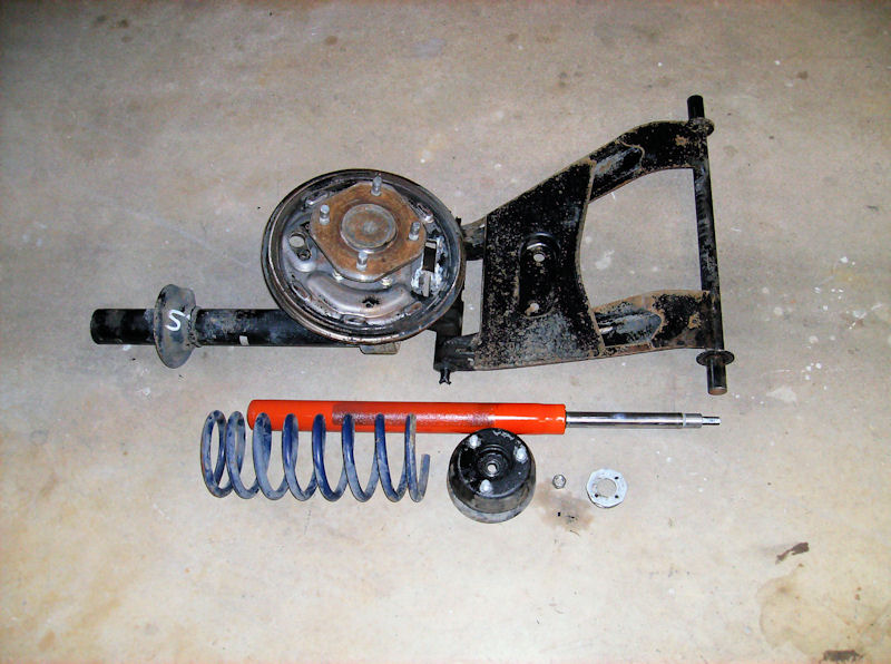

Geof - to clarify some terminology, what you probably bought was a strut or shock insert, not a strut. As 5th says, the insert will go inside the strut tube after you remove the strut assembly from the car. I've attached a couple of photos to give you a better idea of the parts involved. Note that my strut assembly is totally broken down, including brake parts removal. You do not need to go this far just to replace the insert.
Caution, do not attempt to separate strut tube from the transverse link unless you are prepared for some major work. Extracting the spindle that connects the two pieces is a major PITA, usually involves a machine shop with large press or other specialized tools. You should only do this if converting to urethane bushings or similar.
Hope this helps.
Jim
