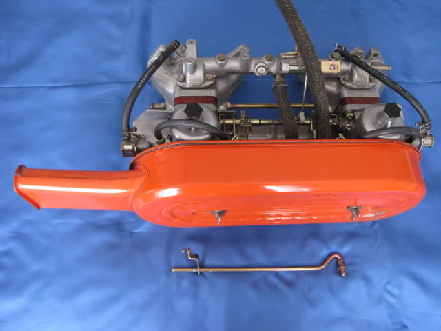

Everything on the car is the is still original except it has a 5spd instead of the 4, i'm pretty sure the attachment pic i got is the same kinda carb. I think its a mechanical fuel pump but i'm not sure, how can i find out? I'm super new to the whole datsun thing but i been reading through tons of threads trying to learn as much as i can but i know a whole bunch of you guys are crazy experts. i don't know who rebuilt the engine but if the cam is off by 1 or 2 teeth can advance or retard the timing it get it in sync or does that not matter?
