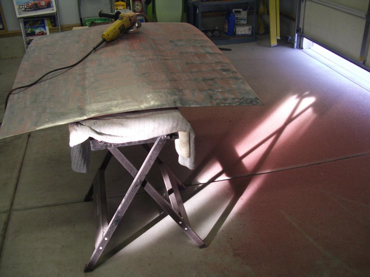

Thanks Esmit! I really lucked out on this rotisserie thing... some guys in the Z Club of Southern Oregon loaned it to me.. Your 3/72 project looks like a handful but you are coming along nicely! I ended up using an electric random orbital palm sander with 80 grit pads to get the paint off the large, unsupported metal areas before taking it in for media blasting. The guy that's doing that work for me said the media (or sand) can warp the metal, especially in areas that I mentioned above. So I made sure the roof, hood and larger areas of the doors were stripped prior to the blasting.

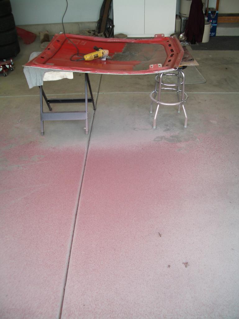

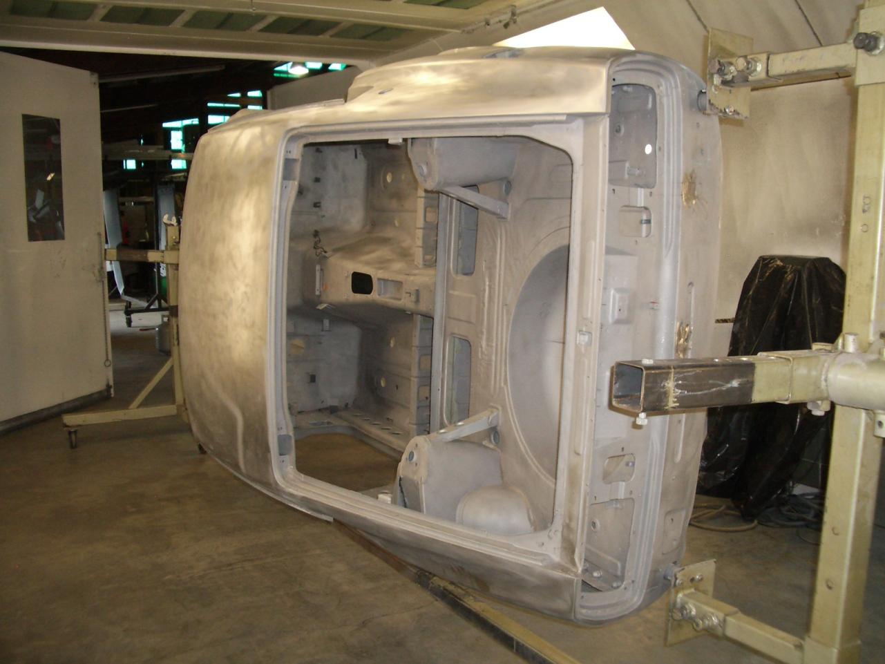

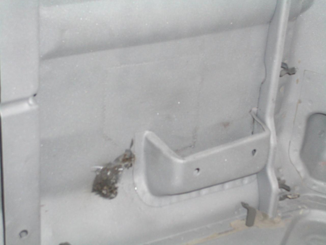

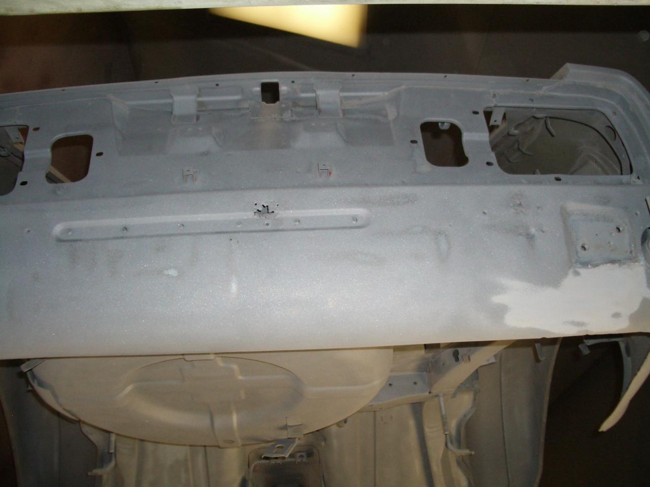

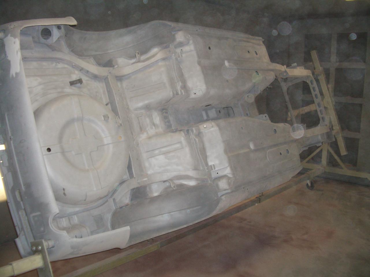

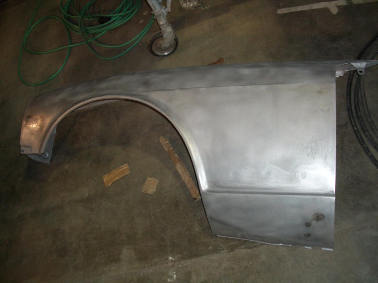

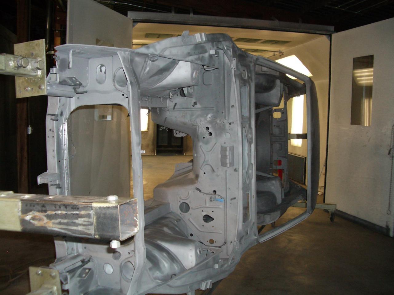

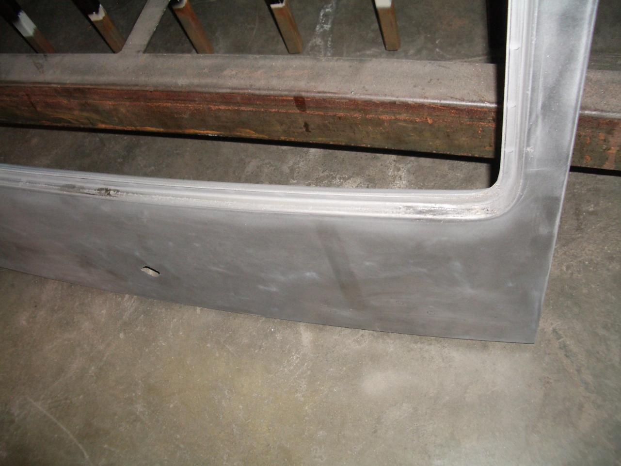

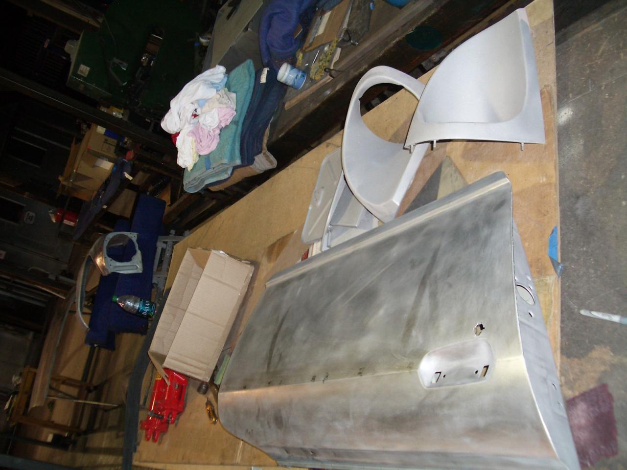

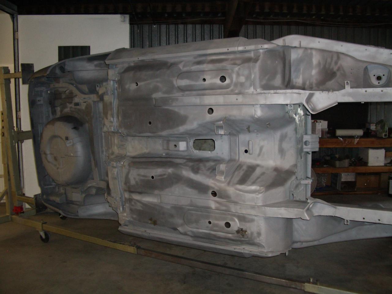

I can't go more than a few days without visiting my car, so here is an update after a visit to Ferguson's last night. Most of the repairs are complete now and the chassis is nearly done with the media blasting. The pros at Ferguson's have 'massaged' the areas of one of the doors and one of the fenders where some old repairs had been made, filling holes and pulling areas that had previously held lots of filler. Have a little of that to do on the rear of the body as well.. Overall it looks awesome!!
Pics start with a couple of the mess I made in my garage removing as much of the old paint from the unsupported areas of the hood and doors prior to the media blasting. I'm still cleaning up after that business!! Next time I'll use drop cloths to cover the busier areas of the garage... except there won't be a next time.. With any luck that is!!!

Thanks for reading... Here are the photos. Enjoy...

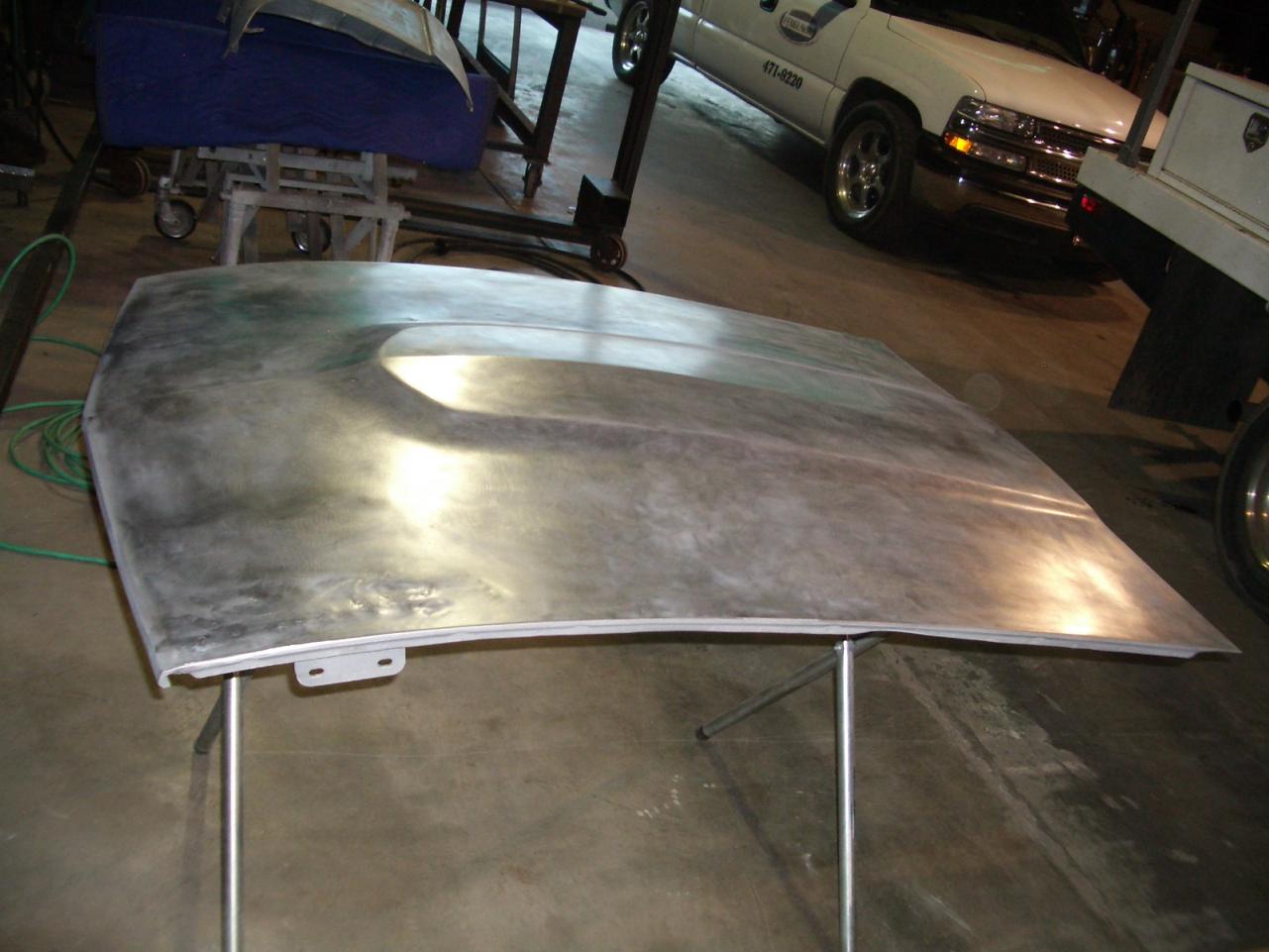

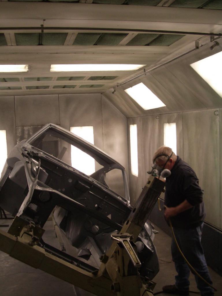

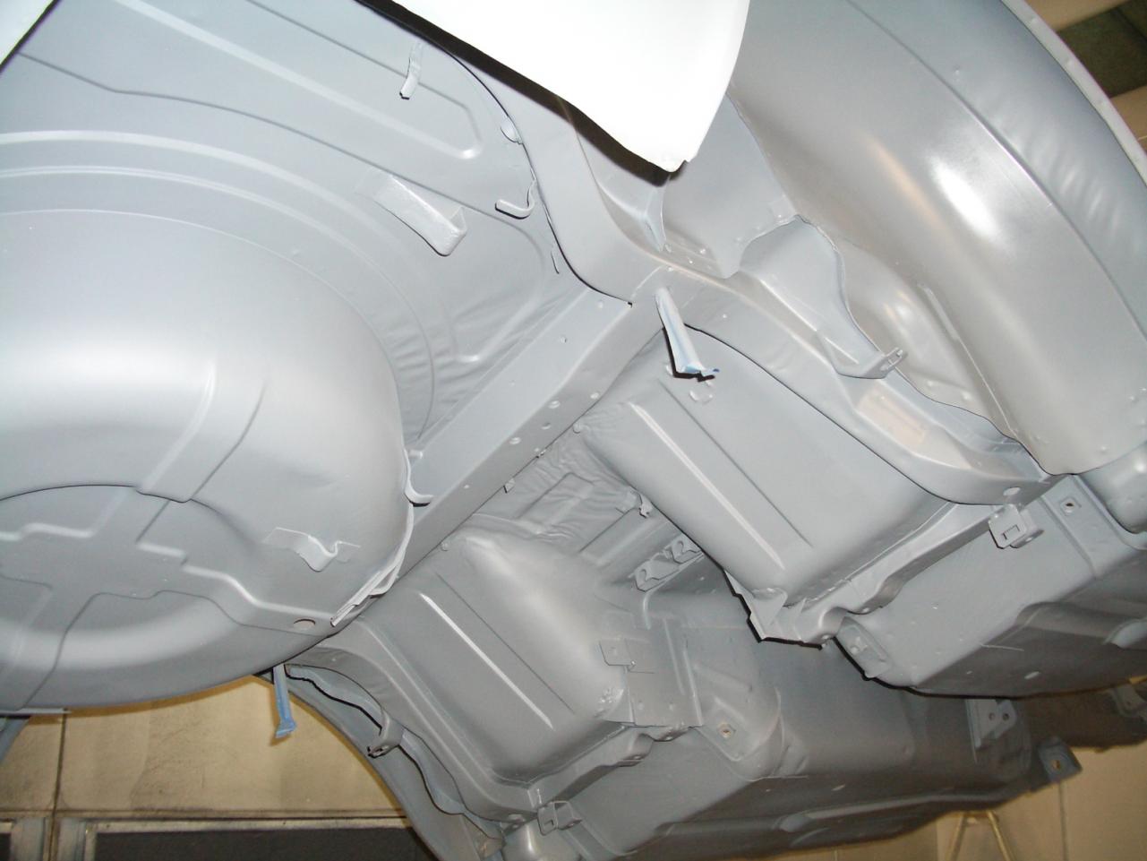

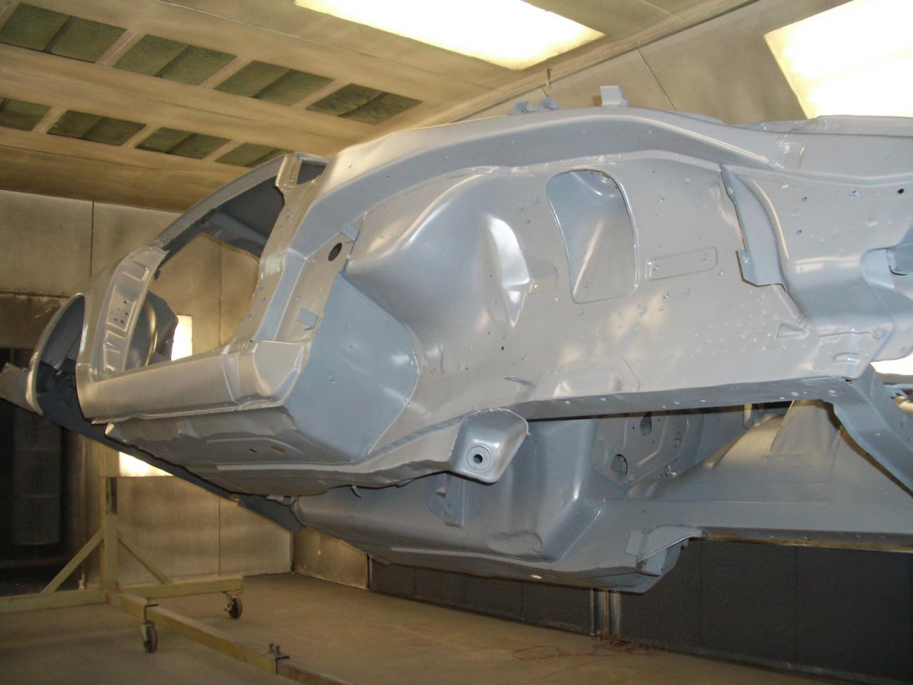

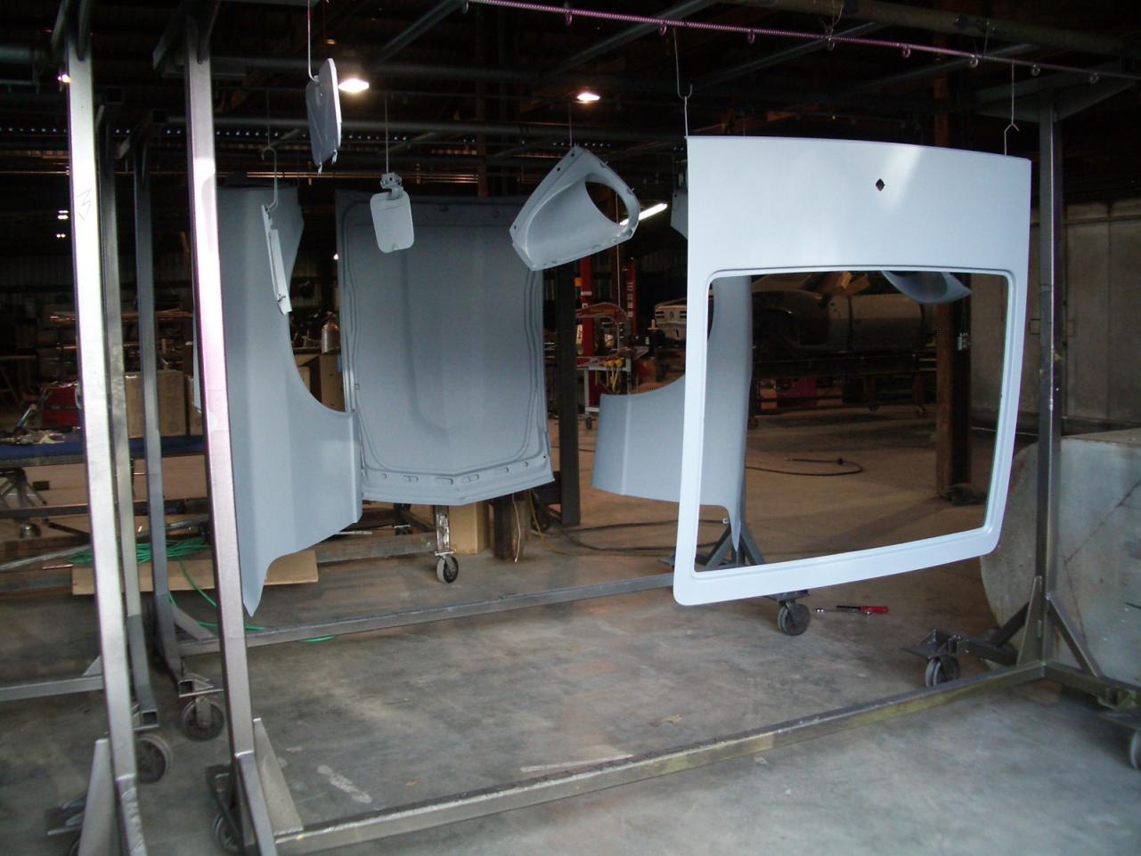

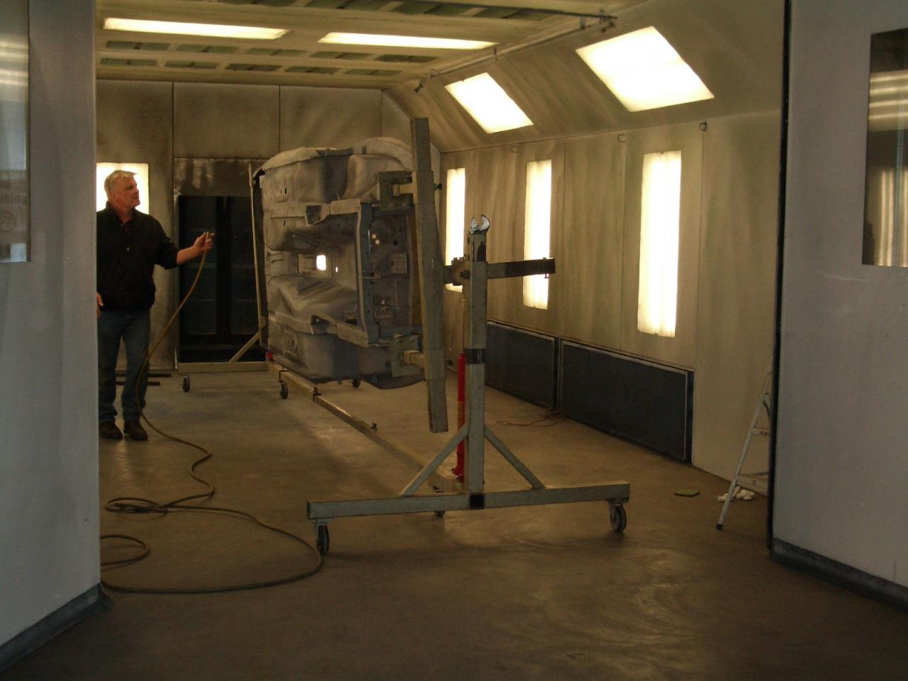

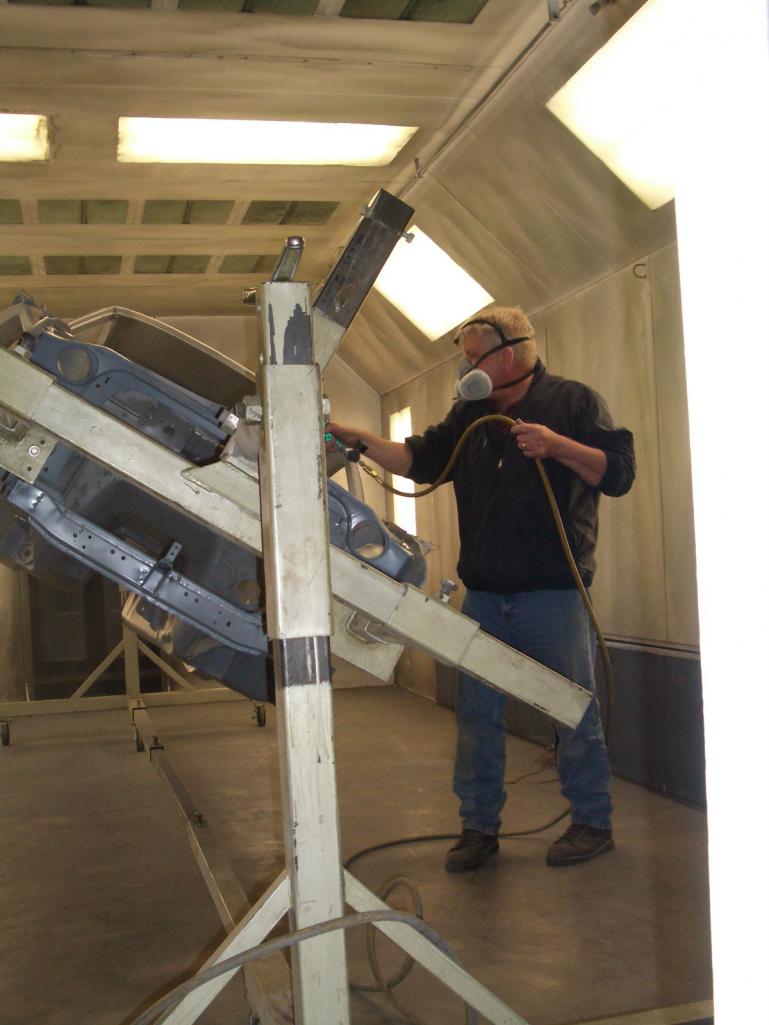

So the 260Z is sealed in two part epoxy primer! After ten days of media blasting, a little rust repair and plenty of metal massaging, the A-Team at Ferguson Fabrication is nearly finished with my car. Will bring it home tonight, closing this chapter in the refresh until I my next time off period beginning next month.
Still need to figure out a solution to fitting the fiberglass 240Z bumpers to the car... So I may take it back to them for a few days next month to sort that out.
Will take some pictures of it on the trailer, so one more post before I go back to work..
Here are the photos, as always there are more at my photobucket account as noted earlier.. Enjoy.
