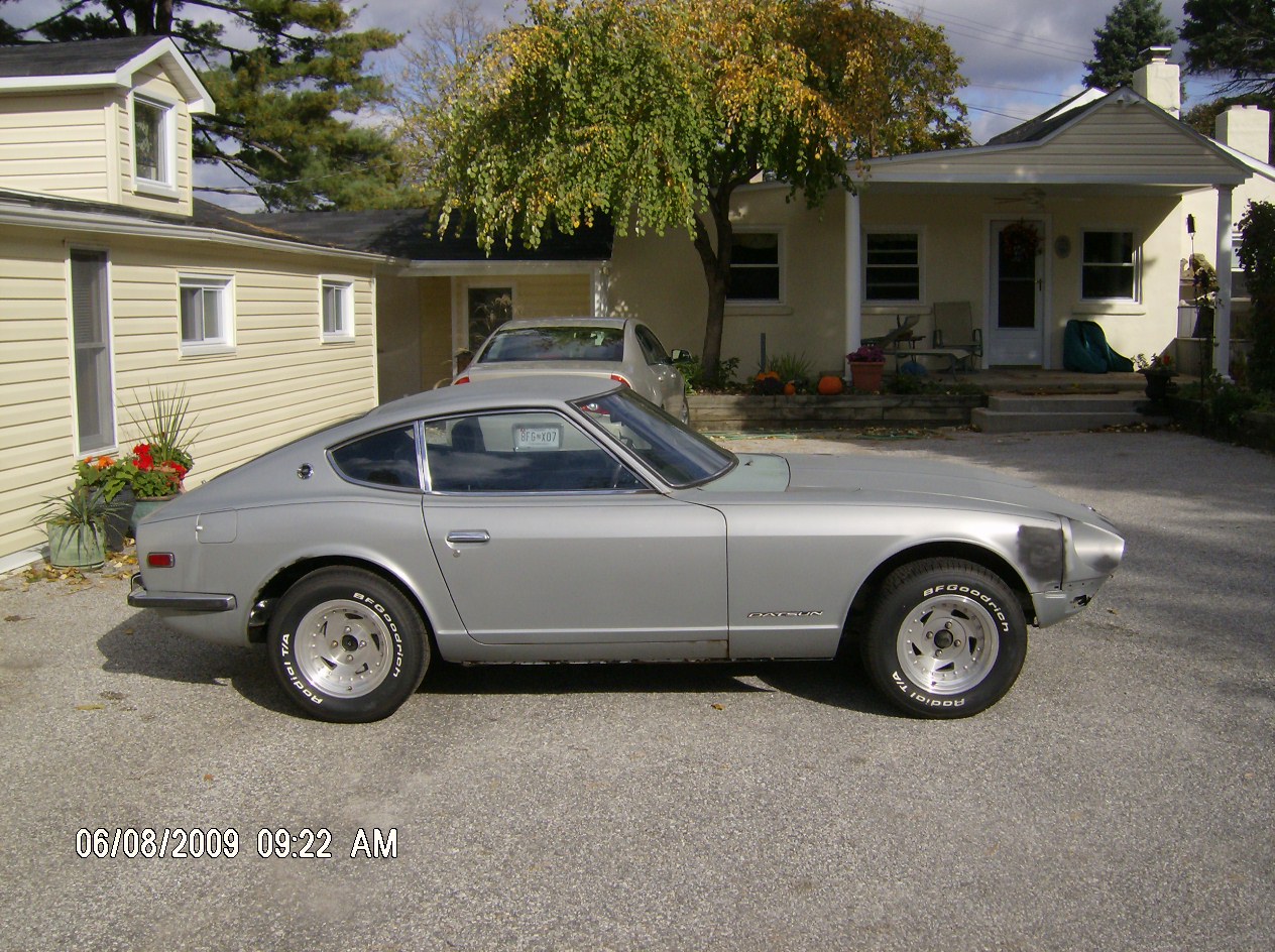

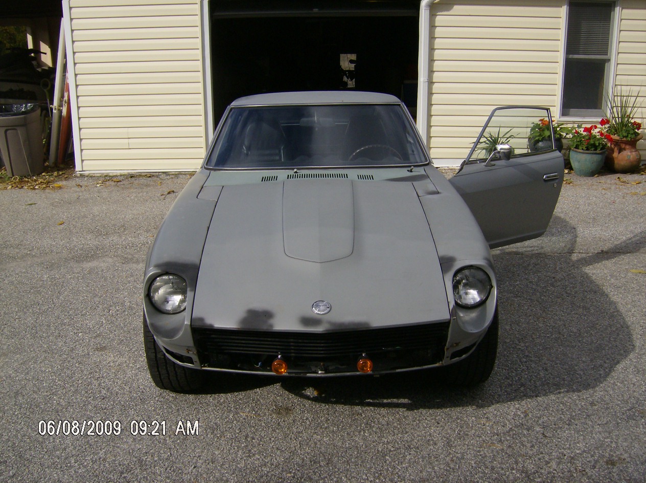

My Z has a brand new set of Michelins on it, that I'd rather not replace. However I'm considering a 14x7 rim as an option. I know that the stock tire size should fit on the rim, but I'm wondering if it will look a bit off with the wider rim or if it will still look natural. Does anyone have this setup or a pic of a 14x7 rim with said tire ?
Thanks,
Eric
https://www.classiczcars.com/topic/37872-19570-14-on-a-14x7/
7X14 Appilance with 195/70X14 Michelin
Thanks Chris. I'm assuming yours is lowered and the wheels are offset a bit? Looks close to rubbing?
Do you think your tires look like they are being stretched out on a wider rim from the front or rear angle? Hard to tell on our pics.
Thanks.

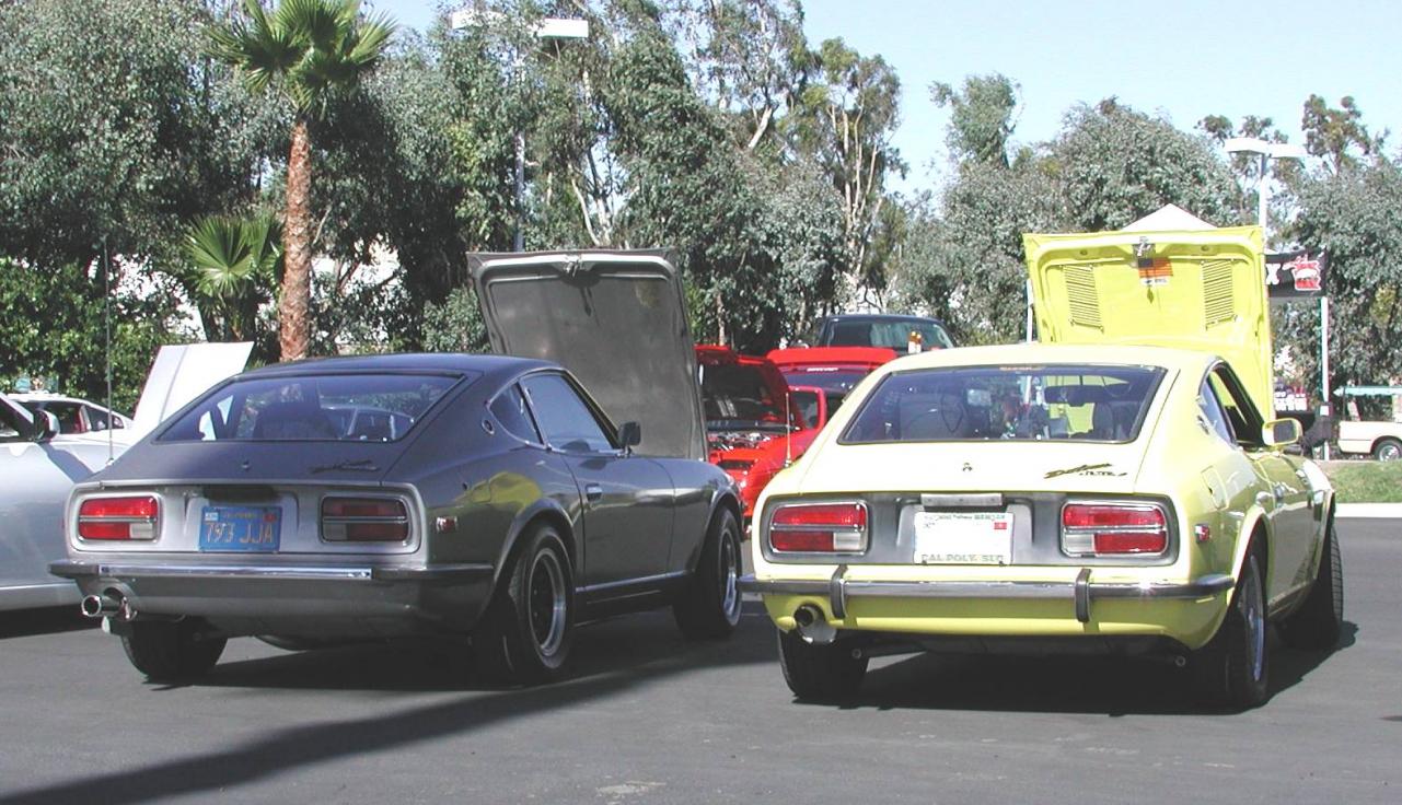

My car (the grey one in the pic) has 14x7's with 215/60's on them. Once I wear the tires out, I plan on putting on 16 inch rims. I'm still debating on 16x7's, 16x8's or 8's in the rear and 7's in the front. I plan on Rota RB's.
You don't like them ? clearance issues ? Does it have lowering springs on it ?

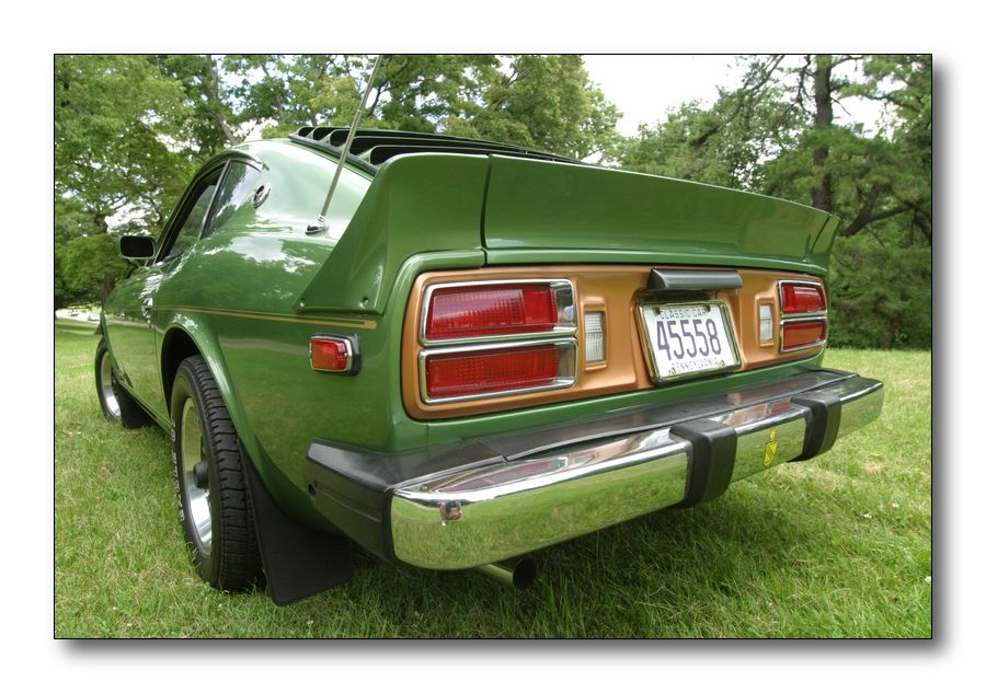

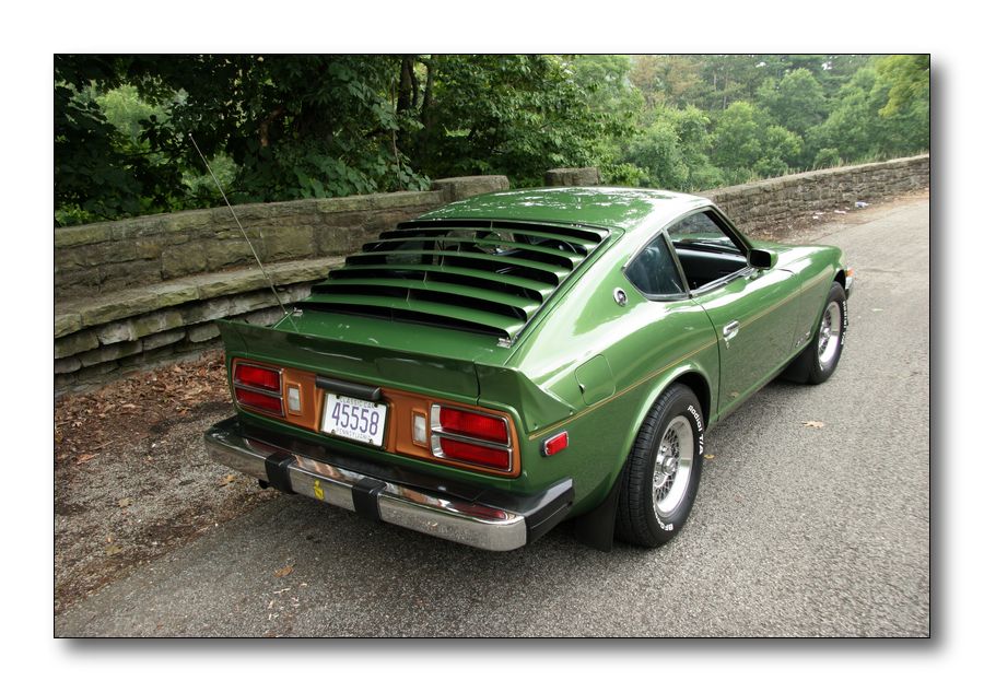

Cozye, FAIW, I'm running 195/60R15 Grids on 15x7 Panosports. The PO had 215's on those rims, as I recall. I had to go skinnier to clear the wheel well. Anyway, I don't think the narrower tires look weird on my 15x7 rims, and if they don't look weird on mine, the same width shouldn't look weird on 14x7 rims, particularly with approx 1/4" greater total tire radius:

Cozye, FAIW, I'm running 195/60R15 Grids on 15x7 Panosports. The PO had 215's on those rims, as I recall. I had to go skinnier to clear the wheel well. Anyway, I don't think the narrower tires look weird on my 15x7 rims, and if they don't look weird on mine, the same width shouldn't look weird on 14x7 rims:

Thanks for the input. It may work out. Your tires are the same width as mine, all thought the sidewall is 20mm shorter. FWIW, tire size calculator says your speedometer reads about 3mph faster than the stock tire, so you can do 82mph instead of 79..;)

cozye, sorry man for not responding, i will have to dig down and see if i have a photo of my Z from the back, my Z i also covered at this moment, not in snow but in my garage at my summer house.
Regarding the streched look, it all depends on the tire, so what you should do is to check the with of the "pattern" before ordering tires, my Michelin, is not 7" wide so they do look a tiny bit streched, on the other hand, if they haven't been like that i wuld have had some rubbing (offset)

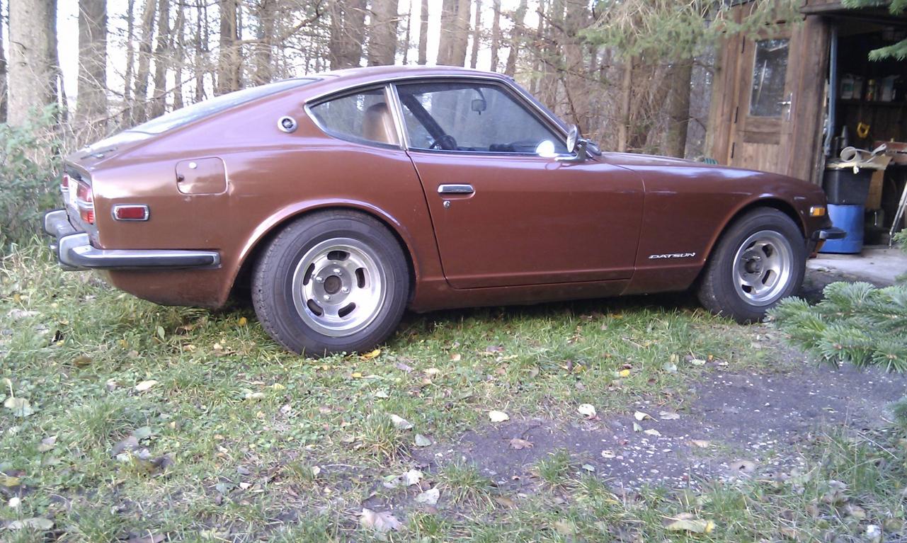

Here are 215 - 60 - 14 (first picture) and 205 - 70 - 14 (second picture) on my stock height 280Z on appliance 6 1/2 or 7 inch appliance wheels. The tires are Goodyear GT radials (first picture) and 205 - 7- 14 (second picture). The wheels I purchased with the car when I purchased it new in 1976.
I went with a taller tire to fill the wheel well because my car is stock height and now both front and back are the same size, before the fronts were 205 and the backs were 215.
