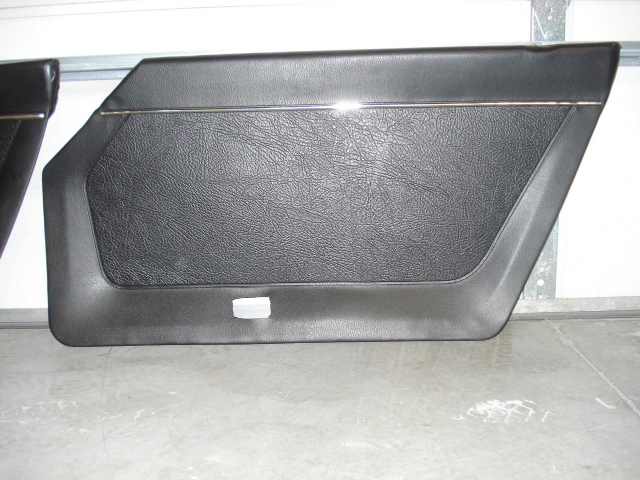

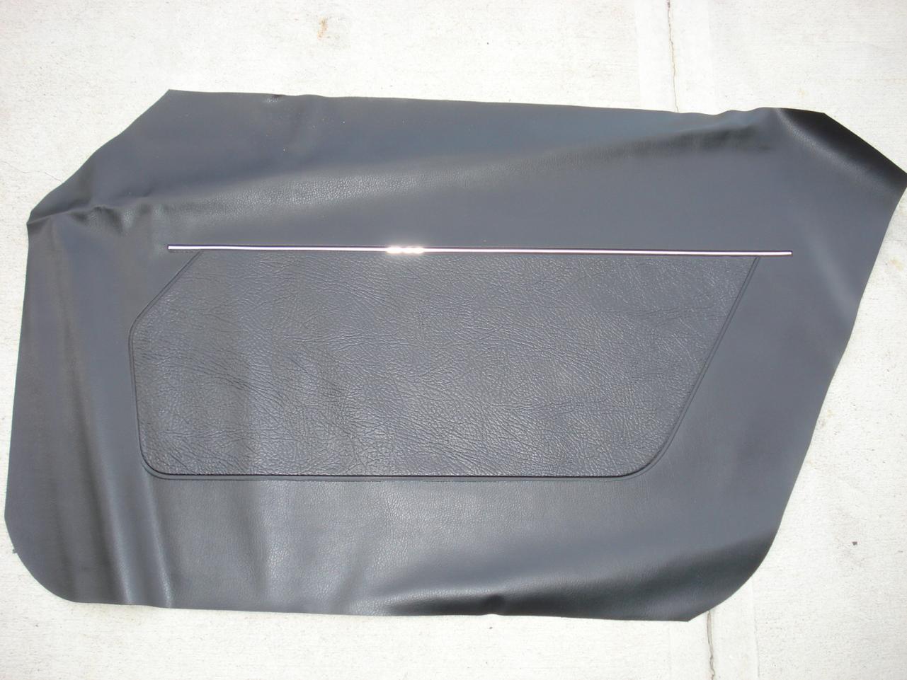

I recently purchased some new door panel skins from DatsunParts.com (http://www.datsunparts.com/2334). I had a local interior shop repair the old door panels and install the new skins. They turned out real nice!
That is the kit that Classic Datsun makes, right?
I bought some from Classic Datsun (www.classicdatsun.com), and comes in different colors. Very high quality.

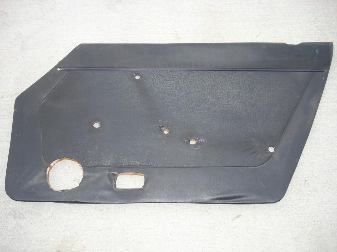

My 73 off-white panels were in storage for 26 years. The majority of the chrome 'foil' had peeled off from back to front, leaving about 3 inches. The blue plastic was a pleasent surprise. It makes for a nice accent to a blue car. :love:

The skins that Les sells at Classicdatsun are very nice and look just like the originals. They even get the fuzzy strip back on correctly.
