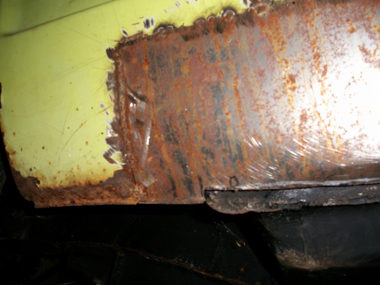

If anyone has or gets a chance to take a picture of the bottom rear front fender where it mounts to the body...it would be a great help. fenders were rusted so bad i cant tell how the bottom is supposed to look. im not using a repair panel so a picture will help me get it close to right. i probably should have put this in help section. sorry

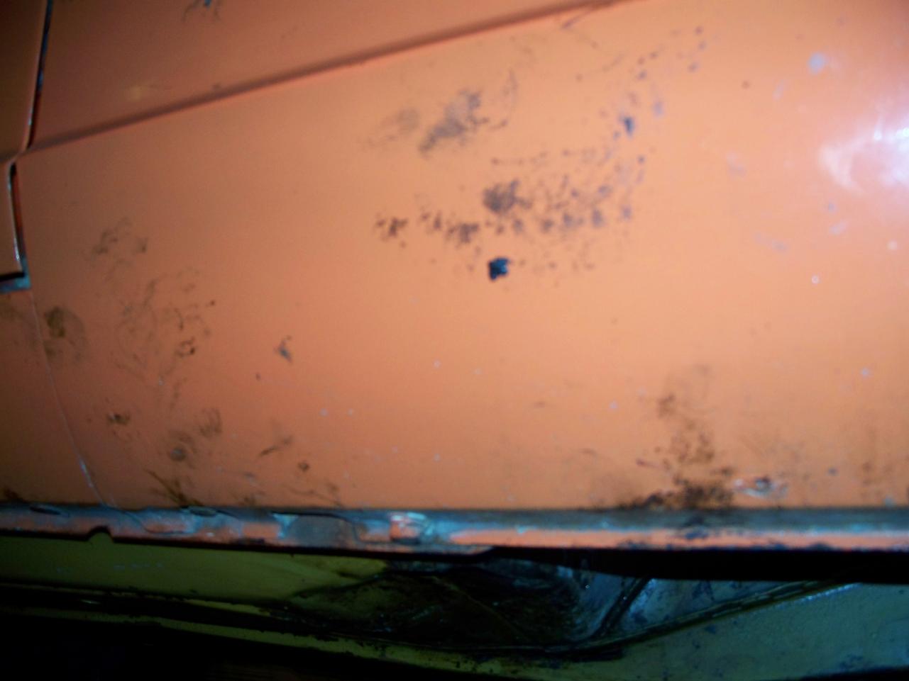

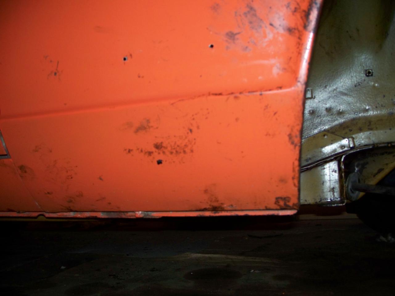

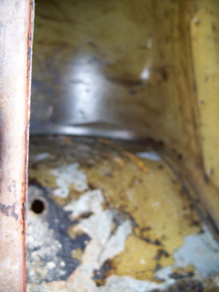

I have pictures, lots of pictures of my car and I might have the one you are looking for. My car is less than 25' from my bed so I can get pictures if not. To help can you take a picture of the area in question so I can get what would help you out the most?

here is the front left fender. curious as to what it should look like. pretty sure i cut to much off bottom of new(now rusted) metal.
It is to dark now and cold I'll take some pictures tomorrow. It loooks like your missing a bracket that the fender bolts to you'll see tomorrow

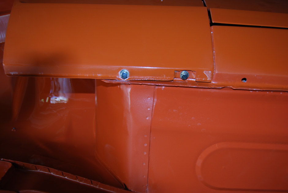

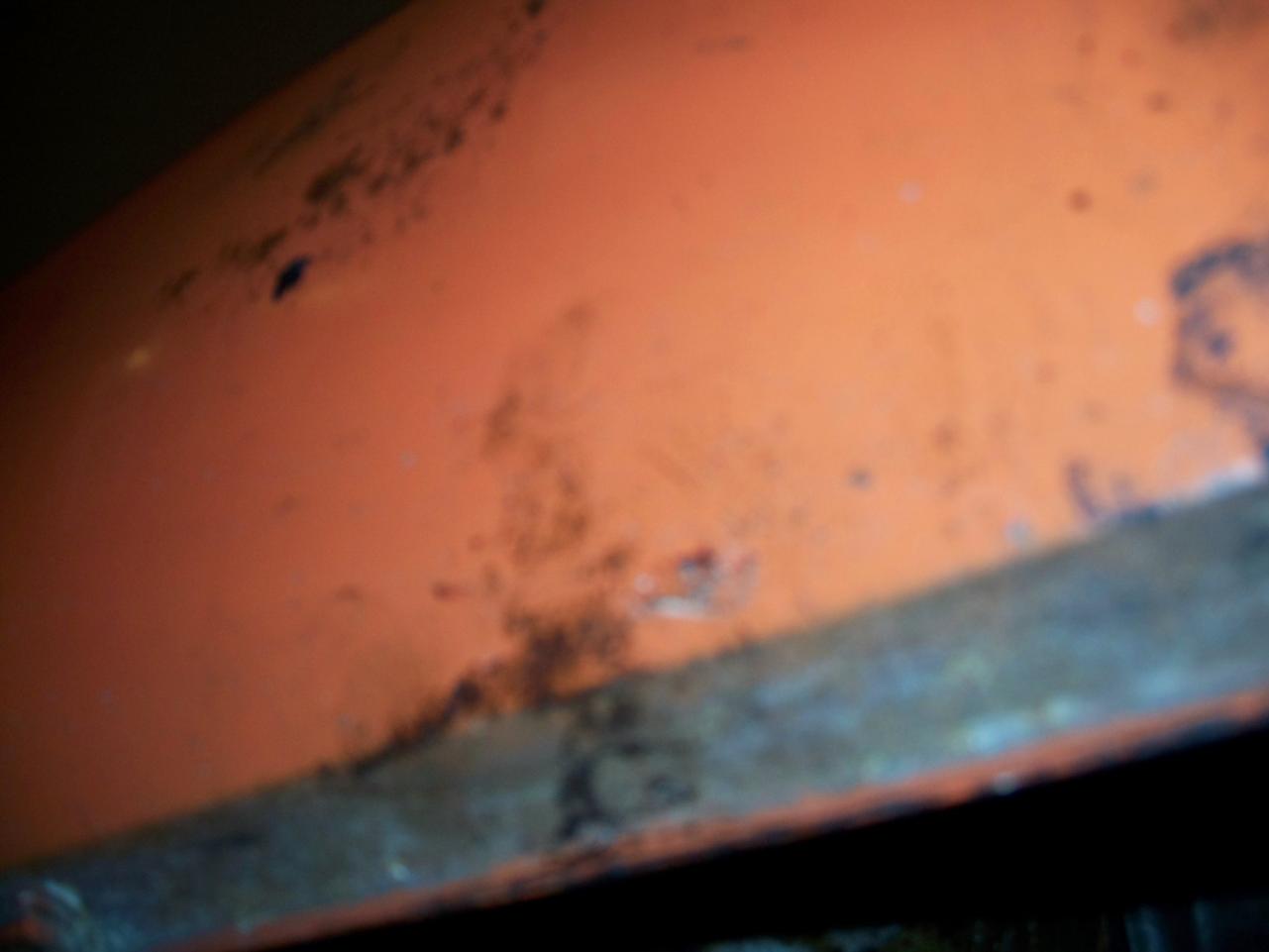

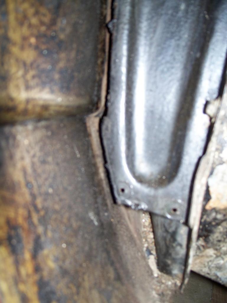

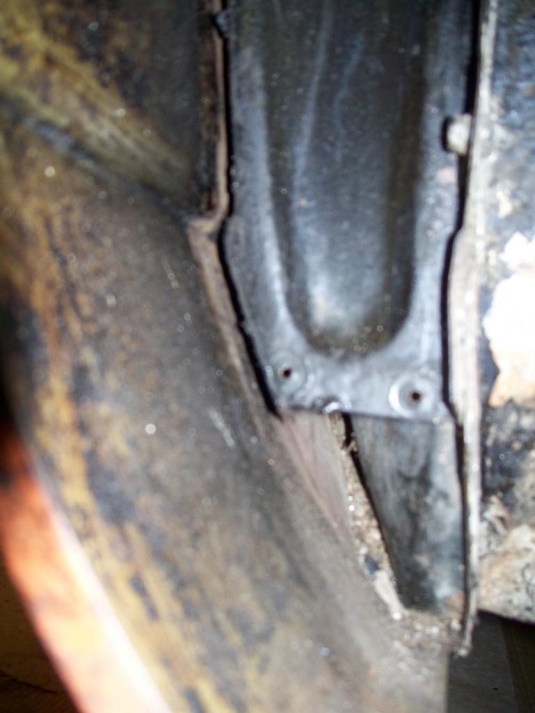

Hear are some pictures I took them from the right easier to get to in my garage I some of the back side in case you might want them. Besides Carl was first with the underside picture

cool thanks for the pics. theyre all helpful. wasnt sure if i needed the lip on the bottom all the way across but now i see. your right i need to weld that bracket in for the back bolt. carls car looks too clean...i would feel bad driving his as hard as i will drive mine if i ever get back on road.
