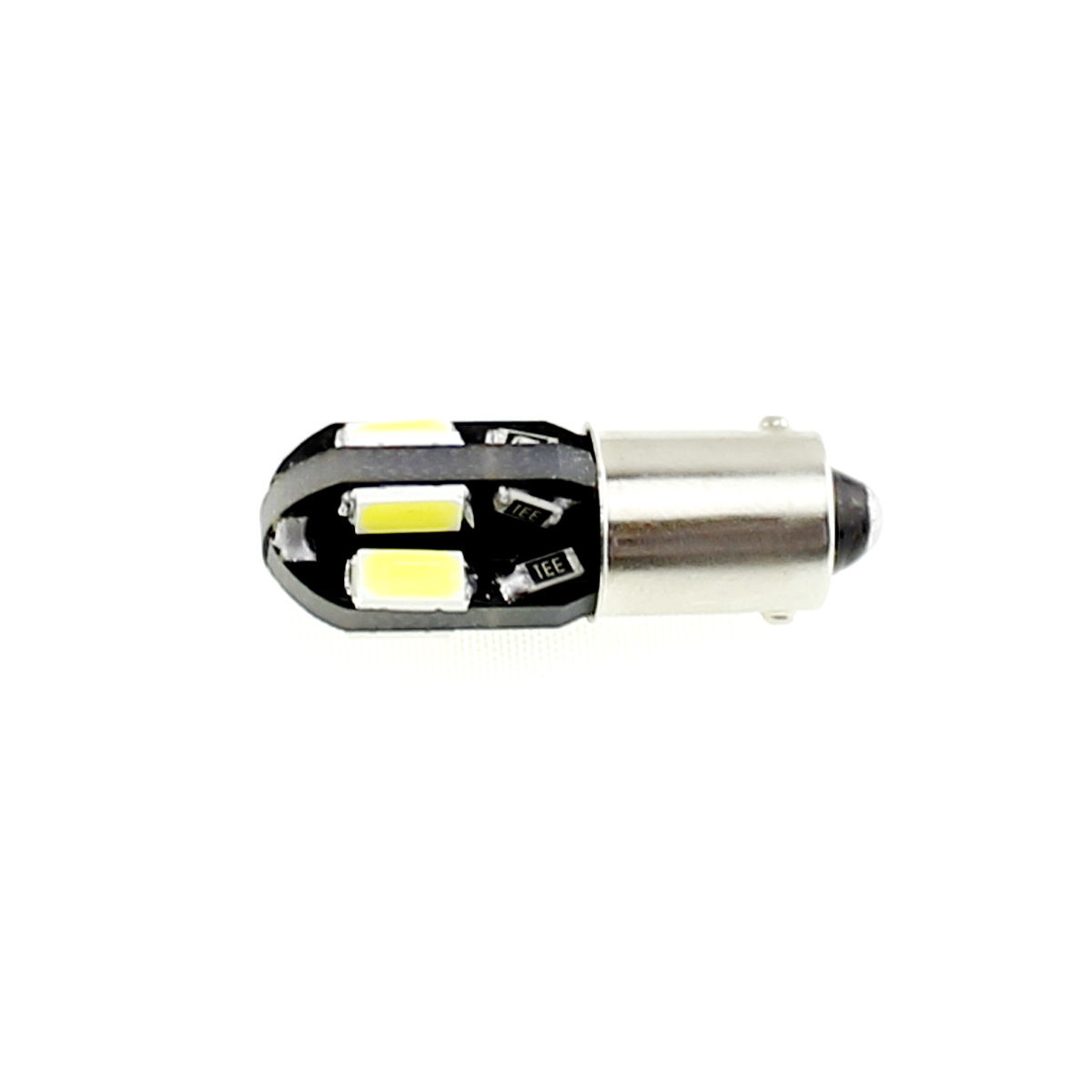

This is a chinese wedge LED:
Edited by TomoHawk

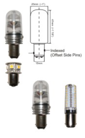

Anyway, I took out the clock, because it out to be the easiest gauge to work with , with only the one bulb, and I installed both the tower style (with 10 chips) and the 'wedge' style (with 8 chips.)  I powered the bulb using my 12V AA cell pack.  Overall, there wasn't much difference in how well the face of the clock was illuminated, so I'm going to conclude that having the two LED chips on the end of the tower didn't have any affect in the illumination of the clock face
.  Granted, the gap for the light to get to the clock face was small, but the design of the clock  had the light reflecting to  the clock face.  I think the other gauges are of a different design.
Tower bulb with 10 chips:                 'wedge' bulb with 8 chips
Edited by TomoHawk
I did the LED swap in all the dash instruments and AC controls using 10 chip tower bulb types. I used a flat CREE panel for the glove box. I did have to remove all the green plastic domes in the instruments to allow the bulbs to fit. The resulting illumination is evenly spread over the instrument faces but the clock is not quite as bright as the others (gauge design?). I used white bulbs and the color of the light ended up having a slight bluish tint which I actually like during night driving. My dimmer knob works but the difference between minimum and maximum brightness is not as noticeable as with the incandescent bulbs.
BTW, you will notice light from under the dash onto the floors. I used two white LED strips attached under the dash and connected to the instrument lighting lead to achieve the subtle so called "ambient lighting".
Edited by dmoralesbello
I've spent a bunch of time working on the LED conversion, and here's some of what I've learned so far. For the discussion, I'm going to call the style you posted at the top of the page "paddlewheels" because I think that's what they look like.
I've found that the paddlewheels have very good light dispersion inside the gauges. The only problem I have with them is that I think they are too bright. Other people can't seem to get enough brightness, but I guess I like my dash lights dim.
I've found that the five emitter tower styles are not as bright as the paddlewheels, but are still too bright (meaning that I don't think you would need to resort to ten emitter towers). But I also found that the tower styles created a "hot-spot" where the forward facing emitter shines it's light. My solution was to modify my five emitter towers into four emitter towers by razor knifing the top emitter off of the assembly. Now my towers broadcast to the sides only and do not broadcast directly towards the gauge faces. I think the light diffusion and dispersion is much better. In fact, once I cut off the top emitter, I find that the towers and the paddlewheels both seem to have about the same quality of light dispersion.
My final hurdle at this point is dealing with the brightness. I've actually spend considerable time trying to come up with an alternative that is less bright and what I think I have decided to do is use my four emitter towers in the gauges and to insert a current limiting resistor inside the BA9S base to reduce the brightness. I've got a bunch of bulbs done and am almost done. It's a pain, but I should only have to do it once. Ever.
And yes, I also disassembled all the gauges and popped out the green lenses. Don't forget about the HVAC assy. And I warn you... It's not a easy as the gauges because they glued stuff together.
Edited by Captain Obvious
I agree with you on all the points.    I tried both bulb styles, but I used the paddlewheels in everything so far.
I couldn't think of any place you would really want to hot-spot from the tower bulbs, except for things like the turn signal or high beam indicators, but I also didn't think you could cut off the end emitters. You can get LED bulbs with only the face or end emitters, if you need them.  What if you glued the green cap (or part of it) over the end?  I used a green '"Sharpie"  marker to color the 7V bulbs that are in there now- could a bit of colored marker dim the light to taste?
Otherwise, I think if the gauges will be slightly 'too bright' than I won't mind, as I am the only person to notice, and they don't check the illumination of the gauges at car shows,
It will be interesting to see how you can put a resistor in the base.
