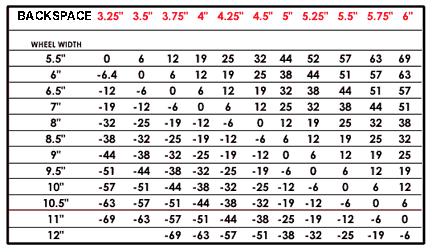

If I could remember where I found this graphic I would give the person credit. I didn't make this. I believe I saw it first on hybridZ

Here's one I've used a lot. Remember to keep backspacing in mind if you're staying with stock struts (not coilovers).

What have become known as the 'group buy RBRs' were originally made for the HybridZ group buy. They have 4.5" backspace so they fit with the original struts. 4.5" backspace is what I would consider the safe rule of thumb when you factor in inner tire clearance.
