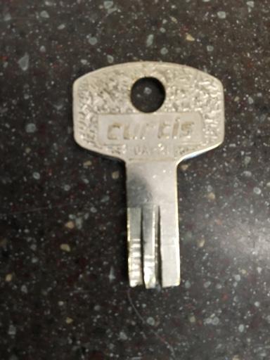

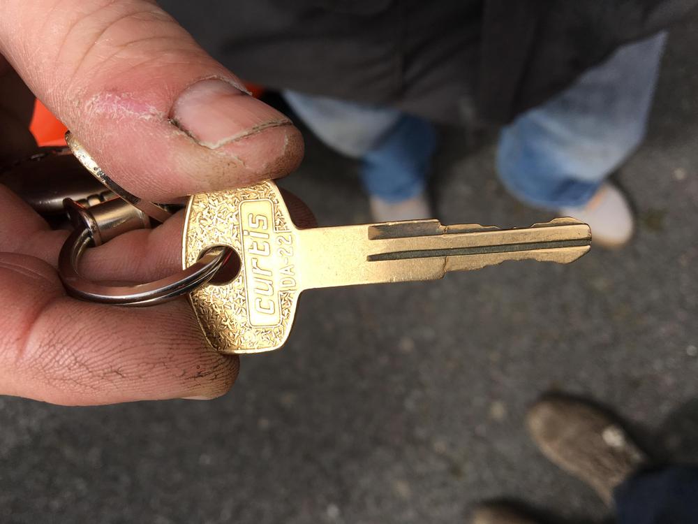

On a slightly different note - I urge everyone to check their keys for this weak spot. A few years ago I was 150 miles from home and as I locked the car at night the key turned to chocolate!!! Thankfully the boot was still unlocked. The remains were easily pulled out of the lock with two small watch screw drivers though - but please check your keys!!
bd2ad491bdf77643cad3246b6ec90153.jpg&key=cc302f1916c763841ffae7f3372939cb05207fddceac5fc895469157a0a7d5c1
And here are pics of my spare key at the time and another member’s key who was at the same event!!!
d3a9f16114607b9435a0bfbb5b6fa4e2.jpg&key=a19dd99a7ec1b2b8af32f0bbfc20f2a3bc1bf33b63161f373b25c8c69eb37c48eb371542ad9ddcd5feb63698dd7afe76.jpg&key=cbbc35d1651a1058dfd4b612efcdb422641727863d071fb6da64ffa337e091cd
