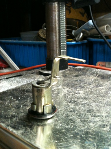

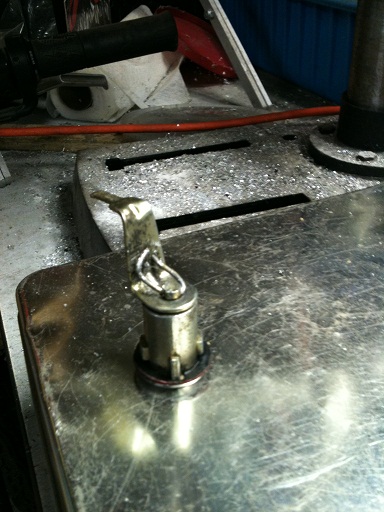

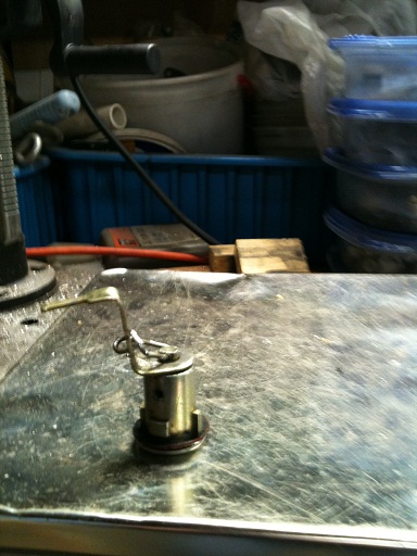

Because the lock cylinders are made from soft metal there is a little shoulder that moves the leaver up and down and after time will shear off (these cars were never built to last this long, they are getting old like us) so this little piece of wire projects down into the lock cylinder about 3/32" of an inch, when the lock cylinder rotates, it than makes contact with the wire and acuates the lever, and yes mine still operate just fine. It will make the locks feel very solid and direct when you lock or unlock your doors.
Hope this helps.
If anyone would like for me to repair your locks with this fix I have come up with, I will if you send your locks to me, I would charge around $30.00 per set which would include return shipping cost (I need to check into the shipping cost), if anyone is interested.

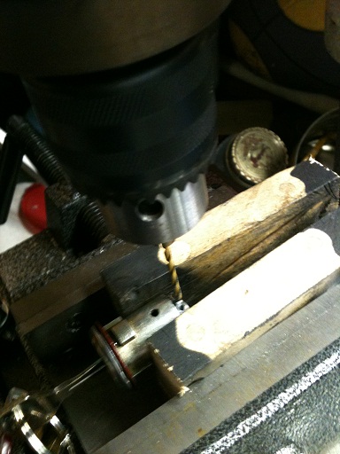

My fix isn't so pretty, but works good. I was planning to drill and pin it, but discovered after drilling it that I located the hole 90 degrees offset. Doh! :stupid: So had to use the coat hanger wire. Hole size is 3/32". Just exactly the dia of my coat hanger. Not elegant, but it works! For now at any rate.
