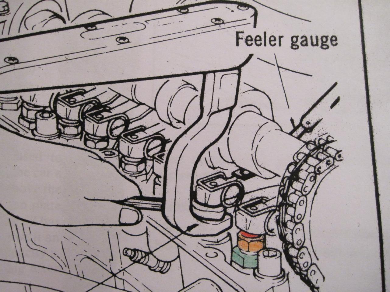

Please see the attached drawing I magnified and colored for a reference in doing this job.

4. The drawing in the FSM and Shop Manual (see below) show a feeler gauge off to the right on the driver's side of the hood. Is it better/easier to measure valve clearance from the driver's side?

10. In the drawing below, which nut is which? Is the nut being turned by the left hand with the combination wrench the locknut or the adjusting nut? I'm guessing that "special tool" from Nissan is turning the 15mm locknut and this tool also has a torque readout on it?
11. I color coded in green, orange, and red what I'm trying to decipher from the drawing. It'd help reassure me if you guys could tell me what I'm looking at in those three colors. Thanks!!!

4. Passenger

9. 17mm is the lock nut
10. lock nut is on bottom
11. orange adjust, green lock, red nothing.
