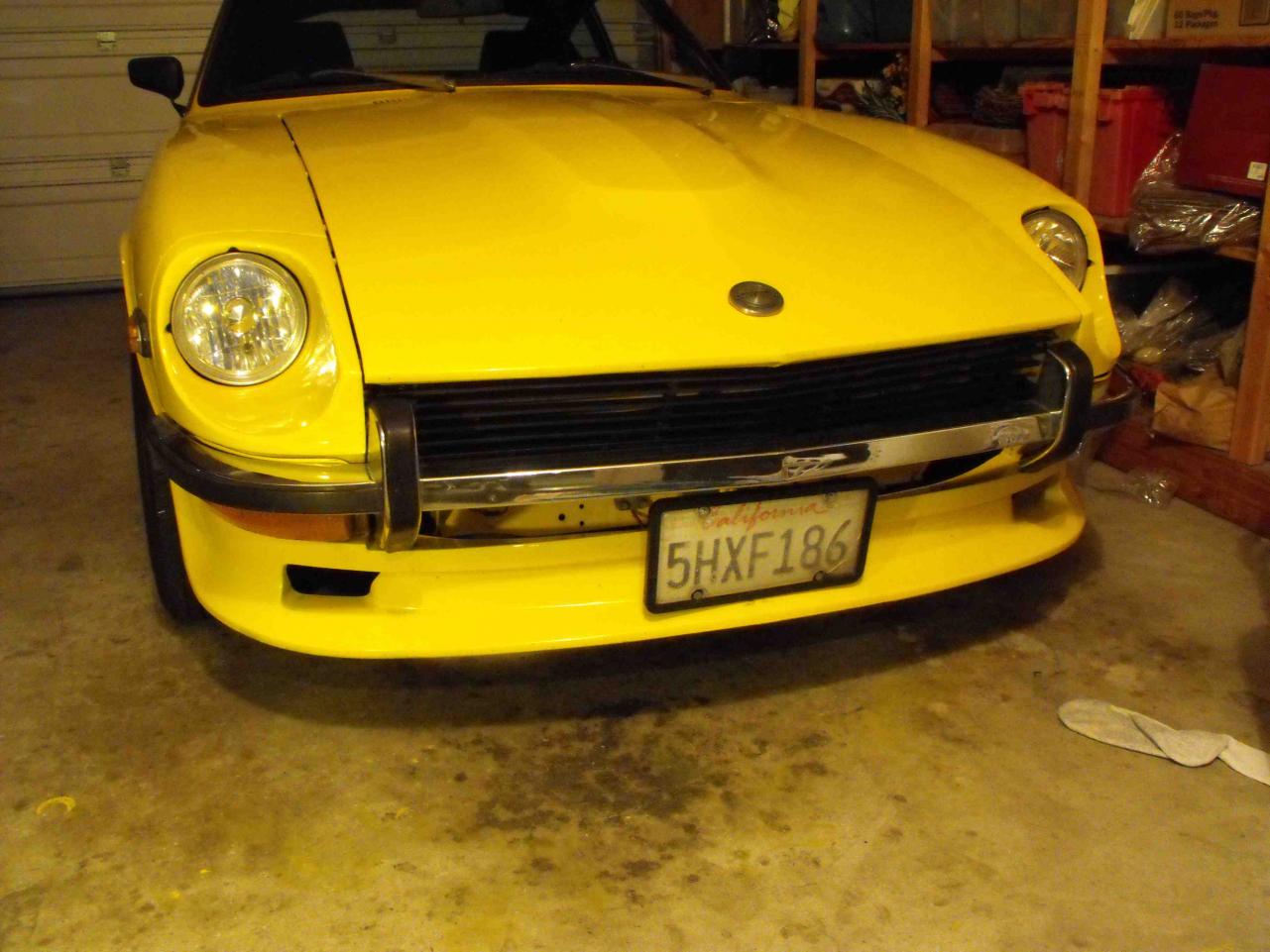

More progress. This was done a couple weeks ago, I'm actually working on the drivers side now. Very close to getting all the major repairs done. Also the air dam is a urethane type 1 I purchased from MSA. It's just clamped up in the pic for mock up, I haven't actually mounted it yet.

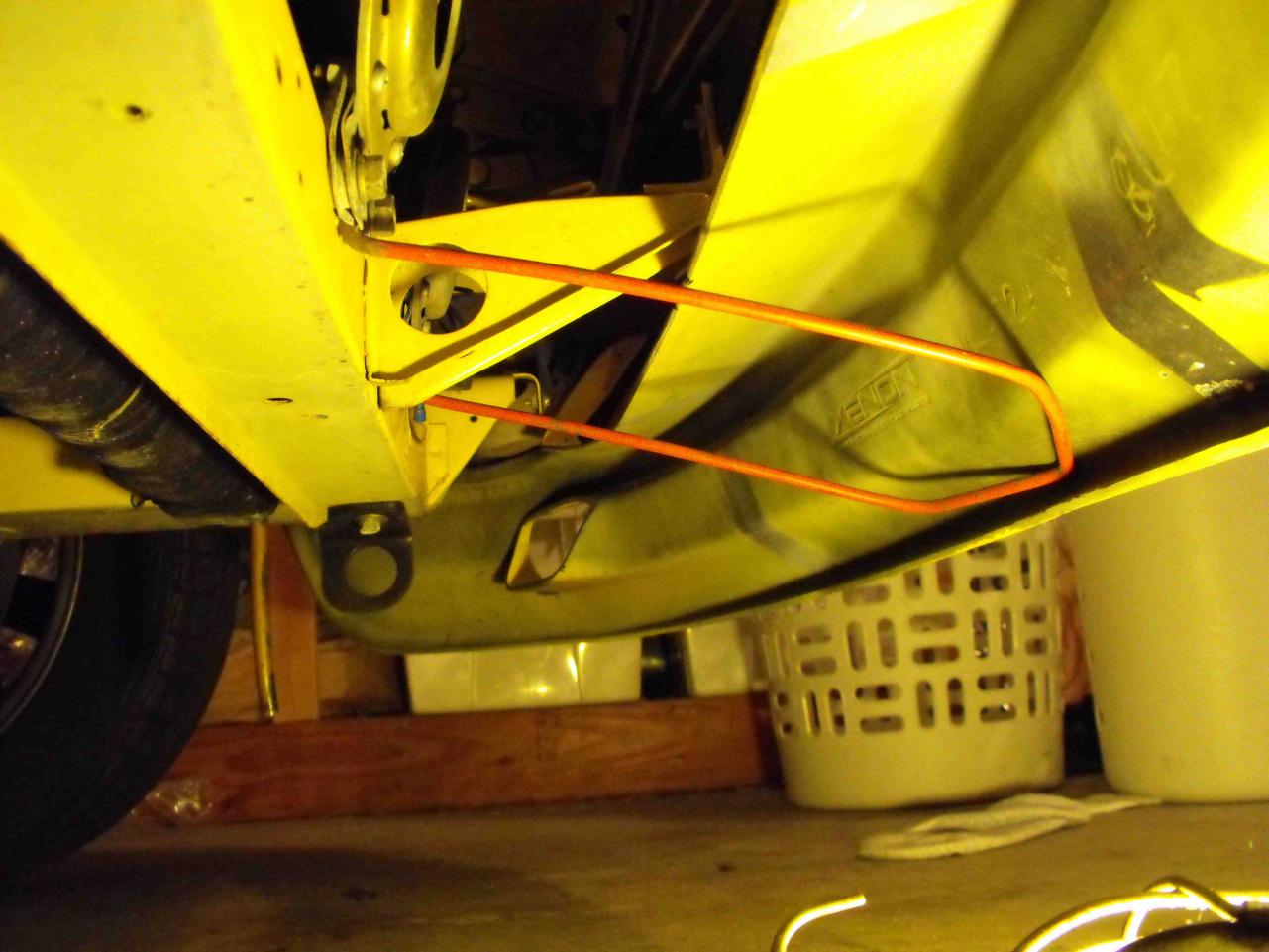

The passenger side "pocket" behind the original fender was quite rusted. I had to cut a bunch of it out and fabricate new metal in behind it. I just picked up some 8mm nuts from lowes and welded those in behind the sheet metal for the fender bolts.
Also, the new Nissan fenders fit pretty well, but they do take a bit of tweaking. The tab that bolts on behind the windshield was off about a half inch. The reinforcement on the back side was tack welded too tight and has the fender bowing out about 1/4 inch too much, I had to drill out the welds and loosen it up a bit before welding it back.
Overall it did fit as well as the original.
Looks like you have the same Urethane front spoiler that I do. It is a bit flimsy and deflects at higher speeds, causing cracks in the paint. I added a steel support structure in the center to prevent the flex. I have not had any problems since. It's not pretty, but it works well. You might want to consider some kind of support for that.
Rich
The sock is optional :)
Rich
Interesting. I considered adding a support anyway. Just out of curiosity, did you add a flex agent to the paint ? I had heard that the urethane air dams would flex some, but I was actually kind of surprised on how this one seemed sturdier in the middle than I would have thought.
I doubt the spoiler had a flex agent applied to it. It was painted at the somewhat local Maaco shop. Other than the spoiler, everything else came out great. The spoiler had some major peeling at the flex points.
I touched up the peeling by doing some light sanding of the area and adding 'bulldog' adhesion primer. I then put the touch-up paint over that. That, combined with the center support, seems to work pretty well.

Almost there. Only have a few more small dings to take care of and cleaning up the grill. Will start trying to find a local painter to spray it for me soon. Spent this weekend doing final fitting and adjustment of the bumpers, so that when I do get it painted everything will be ready to bolt right up.
