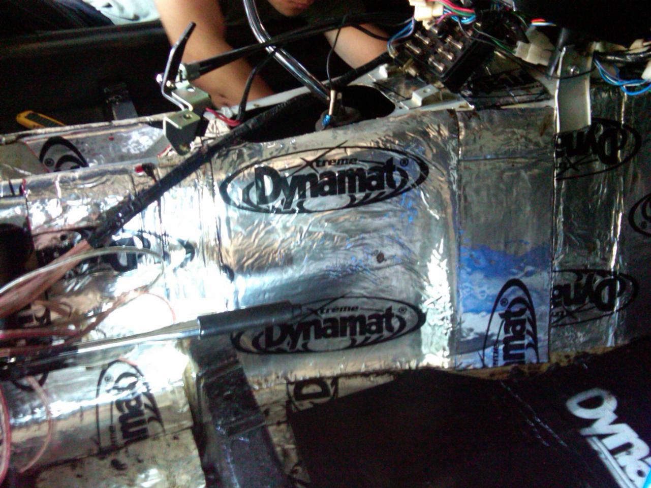

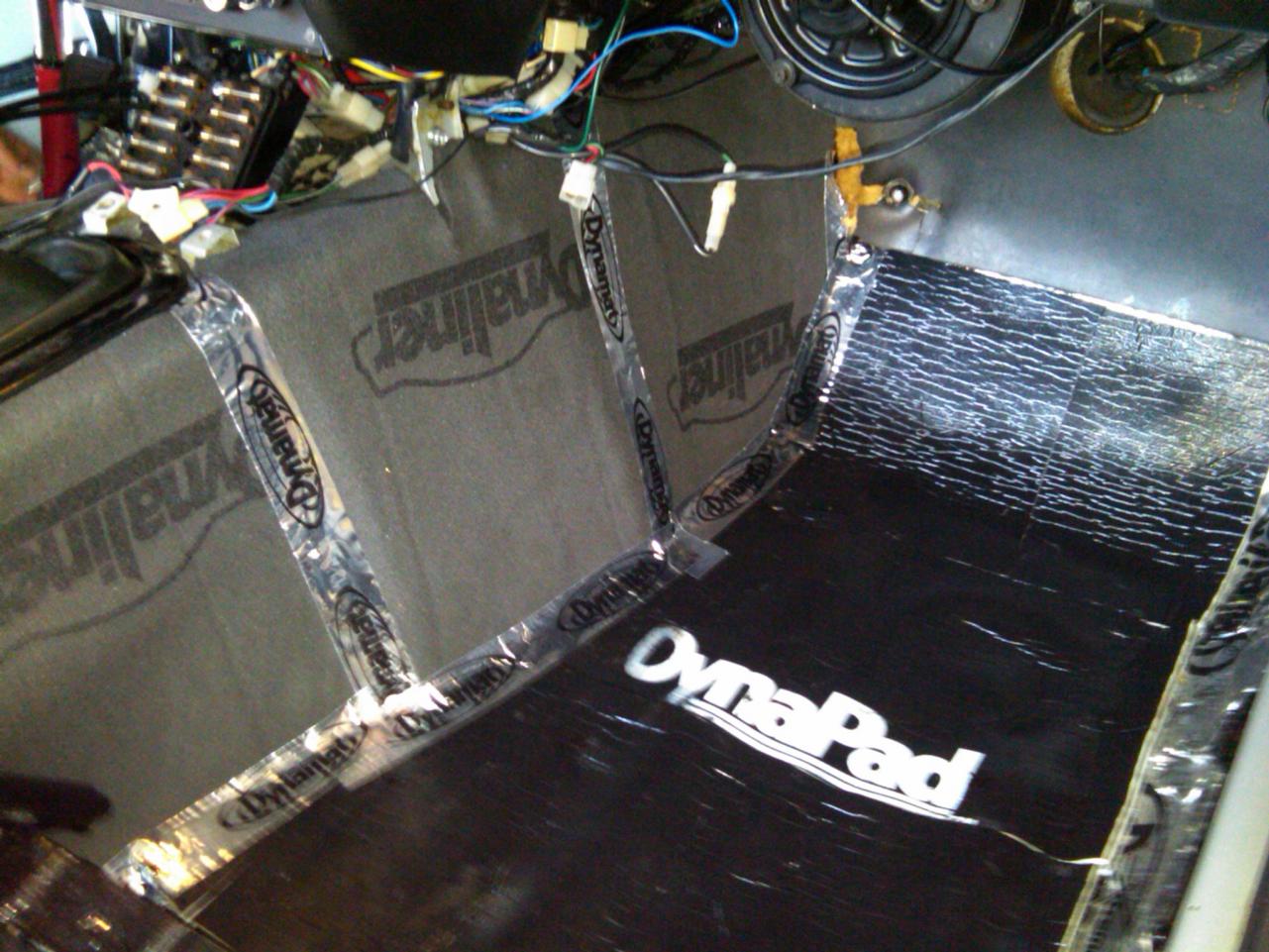

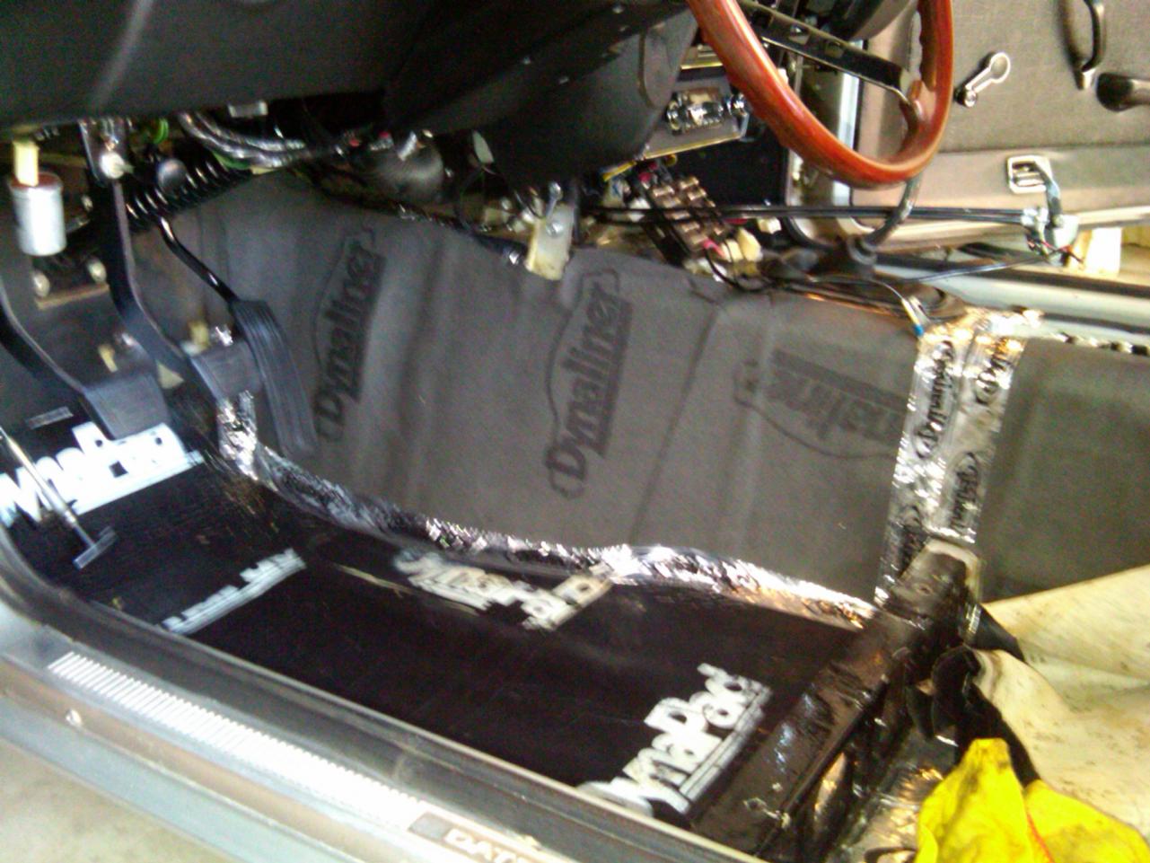

After using POR-15 on the floors of my '73 I installed Dynamat Extreme. This is the peel and stick that many of you have used too. After that I put Dynapad on the floors and under the seats. I used the .5" version that must be glued down. The Dynapad is composed of several layers and makes a great under-carpet cushion. It really cools down the floors too.
Initially I didn't plan on disturbing the vinyl on the transmission tunnel, because it was in perfect, orginal condition. However, after driving the car after doing the floors I realized that the tunnel was generating tons of heat. I carefully removed the vinyl and then installed Dynamat Extreme after removing the tar (tip: use adhesive remover). On top of that I used the .25" peel and stick Dynaliner. This is a soft foam that is perfect under the vinyl. I taped the seams before putting the vinyl back.
The photos show the results. If I were doing it again I would do the tunnel first - makes the floors easier.
