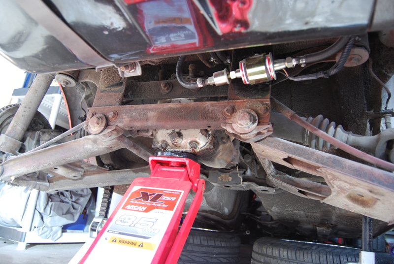

Interesting, it had crossed my mind to ask of the car had the limiter strap over the diff, and if it was broken. I, for a moment, suspected that the front diff mount might have failed at some point, slamming the diff back into the cross bar. Not sure that's even possible, but it crossed my mind when I first saw the picture.

Geezer, yes it does. I wish my parts looked that good - maybe in time. I did find that I do have the limiting strap and mounts so I think everything is there and only the bent member needs work. There is a broken piece of a bracket or something that was mounted to the front cross member. I will have to get a photo and see what it is.
Can't remember exactly, but there was an exhaust hanger on my front x-member. This may be your broken piece that you are talking about. You can see it on the left side near the jack head on the attached picture. Not sure what else might have been mounted in the area.
