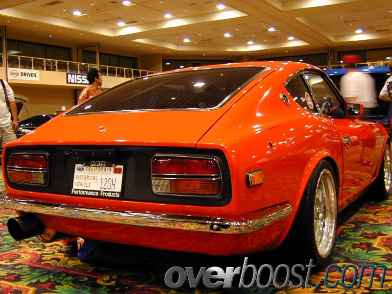

Just adding a comment. The vertical defogger glass is hard to find and worth quite a bit too. I remember having a conversation with Lindsey Drife(forgive for incorrect spelling if it is). At the Zshop here in Melbourne and he was saying he has 1 and no it's not for sale :( I'll include an image in this post so u can see the vertical lines.
PS: It's TOD Kaneko's 240z I love this Z. (Forgive spelling again if wrong).
