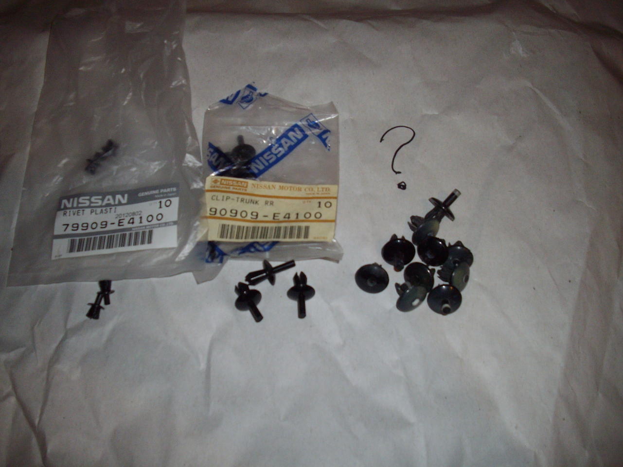

exterior taillight trim piece plastic rivits?
Found these at the local hardware store in the section where they keep all the little specialty items (nuts, bolts, fasteners, etc). The box had a part number of 58659 and was probably from Hilmans. It says "Push fast variable depth" 7/16 flange X 5/8 stem. The head is probably 7/16 and it is about a milimeter in diameter narrower. The length is 5/8. It also says "Ford/GM"
The picture isn't focused very well (automatic camera wants to argue over what I am taking a picture of). The rivet on the left is the new one, the one on the right is the original.
I couldn't find anything like original so I used Stainless Steel finish screws that sit in a SS cup. Looks nice on the charcol/grey/black trim. The one IdahoKid shows would work and removable without losing the little pin.
Bonzi Lon

Found a reference to a Subaru part that is supposed to be the same. Can't find much on the web so you will have to check with Subaru if it works:
Number : 665533000
Name : RIVET, LUGG SLF
Brand : Subaru
Price : 0.04 USD
Weight : 0.00 lbs.

Car parts manual site gives:
RIVET-PLASTIC,BLACK 90909-E4100 qty=16 for 240z interior plastic panels
RIVET-PLASTIC,BLACK 90909-E4100 qty=8 for 240z interior tail light access plastic panel
RIVET-PLASTIC 79909-E4100 qty=8 for 240z exterior tail light/license plate metal finisher panels
RIVET-PLASTIC,BLACK 90909-E4100 qty=10 for 240z interior hatch vinyl finisher panel (air vent cover)
for 260.280z
RIVET-PLASTIC M5 90909-E4100 qty=6 for 260z/280z exterior tail light/license plate metal finisher panels
08510-52097 from 7702 qty=4
RIVET-PLASTIC (BLACK 90909-E4100 qty=14 for 260z/280z interior plastic panels
RIVET-PLASTIC BLACK 90909-E4100 qty=16 for 260z/280z interior plastic panels
