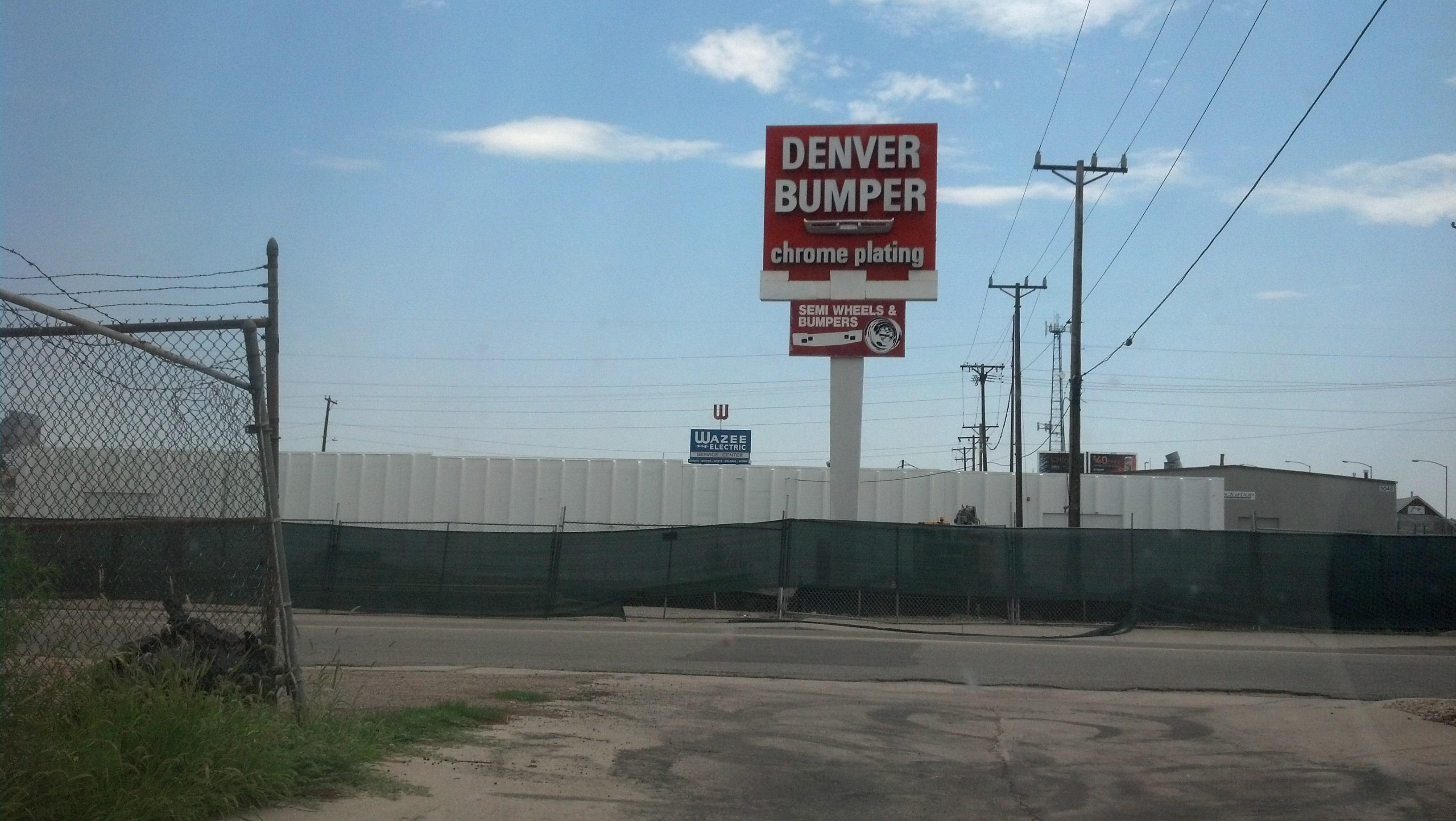

Does anyone know if this Denver Bumper is still in business?  I tried the number I found Googling it but says its been disconnected. Don't know if I had the right place or not.
Unfortunately, the owner of Denver Bumper Works sold the land and the building to a pot company and the owner retired. The new owners of the property razed the building and built new grow houses. Here's a picture that I took soon after the building was razed in July of 2014.
I really miss Denver Bumper. I don't think that there are any other chrome shops here in the Denver area.
