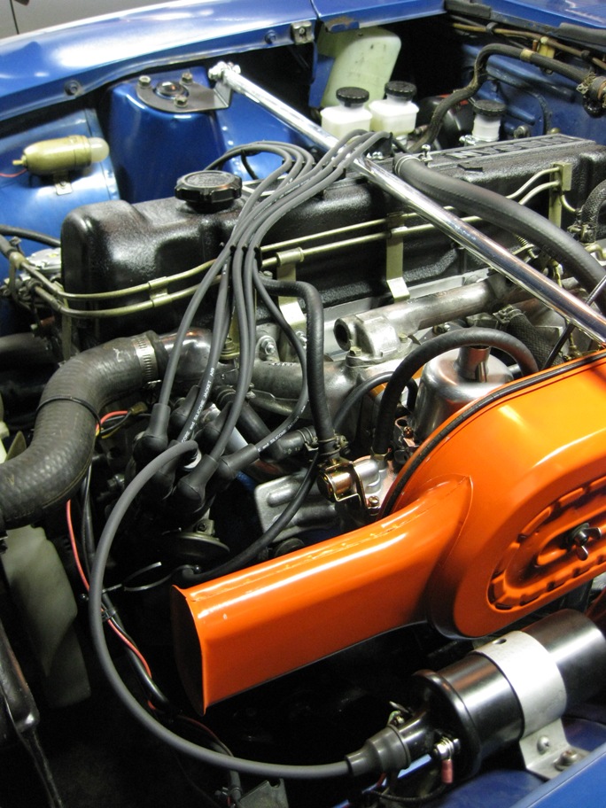

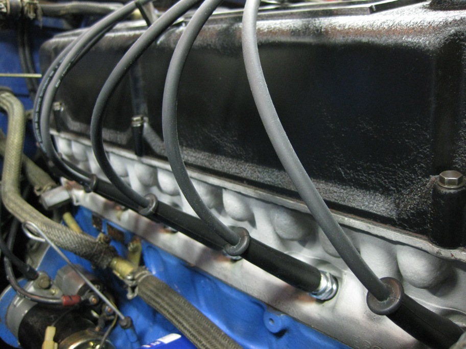

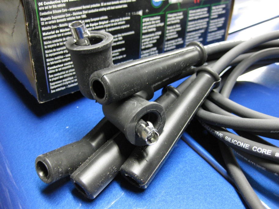

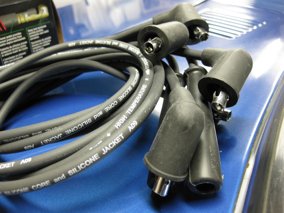

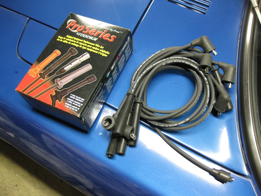

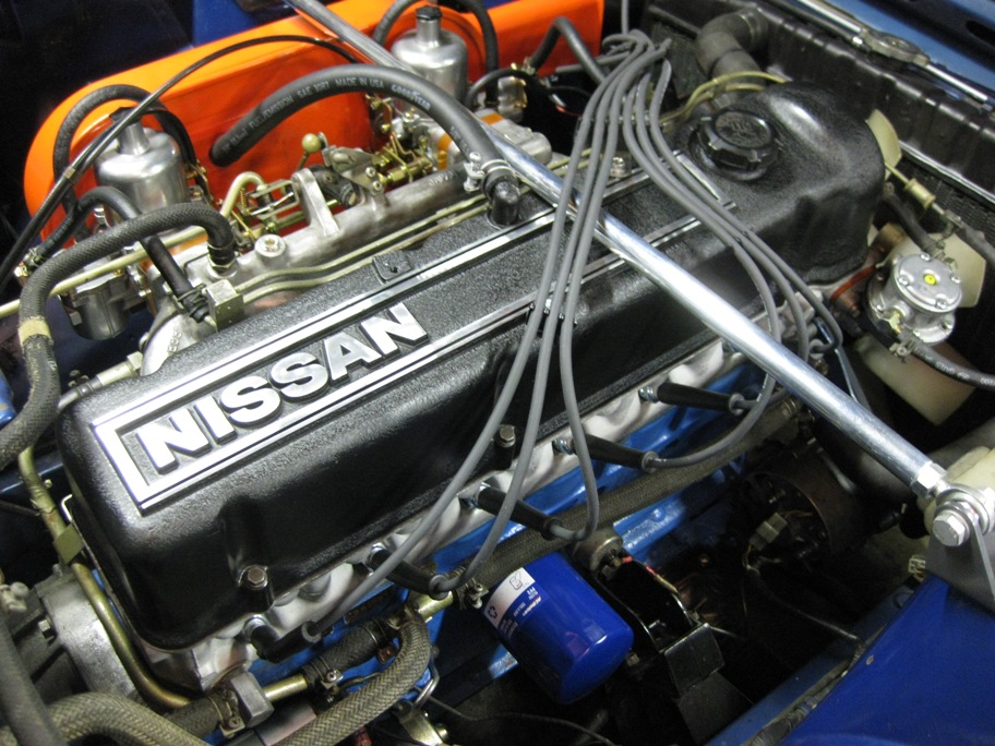

spitz17 Posted February 2, 2011 Share #10 Posted February 2, 2011 I found a set of black spark plug wires with black boots that works with our Z's. They are labeled "Pro Series by Federal," made by Standard Motor Products. I just got them at my generic auto store (Winchester Auto Parts) here in San Jose. The black wires may be mistaken for gray as in the picture the light was shining directly on them. The set also has one angled spark plug boot for the hole closest to the firewall. Link to comment https://www.classiczcars.com/topic/38414-wires-matching-numbers/#findComment-344268 Share on other sites More sharing options...
