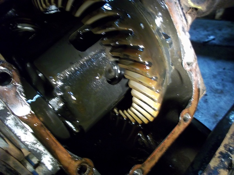

Rotating the tires and counting drive line rotations, it came up at 4 1/2:1. No one around here had ever heard of such a thing in an r180. To end a bunch of local arguments, I pulled the cover off . The numbers on the ring gear are 37 X 8, which works out at a 4.50.
Can anyone tell me from the picture what I actually do have, such as a brand name, or a type or how I can find out? (It is a 180 isn't it?) 4.5 seems pretty deep for a driver, but it will have an 83 5 speed in front of it (this is all in my 72 240 with an L28).

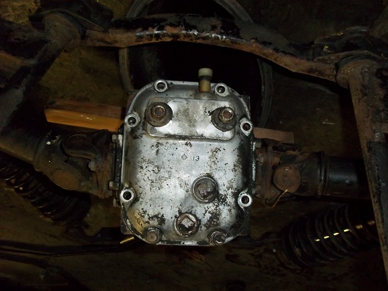

I've got a pic of the diff cover now. If I can identify what the carrier is, the next step would be to find out what other gears I can go to. I'd really like to keep the posi as it was a "bonus" with the car. I don't have a traction problem with any of the other three Z's, but bragging rights and the cool factor and all:cool:

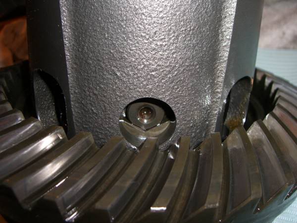

It's probably an old Nissan LSD, if the cross pins look like this then that is a pretty sure bet: http://album.hybridz.org/data/500/90952way1.jpg
If it has 4 of these square shaped cross pins, it is a 4 pinion, 2 would be a 2 pinion, I think some R160's had a 3 pinion setup.

I had to go look. Only one cross pin that goes all the way through. I can see 4 spider gears. Bottom of the case has "4 X U" stamped on it.

By the cross pin it's a Nismo clutch LSD based on the ramp angles, sounds like a 2 pinion (2 pinion gears, 2 side gears for 4 spider gears altogether). If I'm right that the R160's had a 3 pin setup then that would be an R180, which came in 2 pin and 4 pin. Of course you should keep it. Like Arne said previously, it makes a HUGE difference in a Z car.

I found this site and thread http://www.driftworks.com/forum/technical/65994-diff-identification-help.html and specifically post #5. The picture there looks like my picture, but if I read it right, that one is a 200, thus part of my confusion.

first pic taken from driftworks site, second is mine
