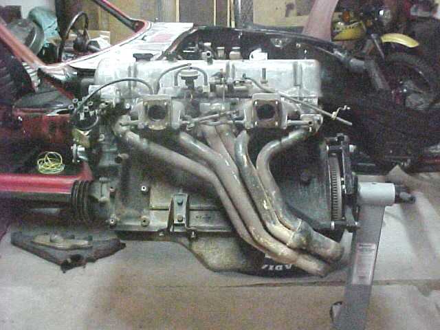

I got my header from a junk yard for $50. It's a 6 into 2 header like the ones from Motorsport Auto. I had to have a collector made up for though.
Here is a good shot of my header before I put the engine back in the car. This was almost one year ago to the day!
