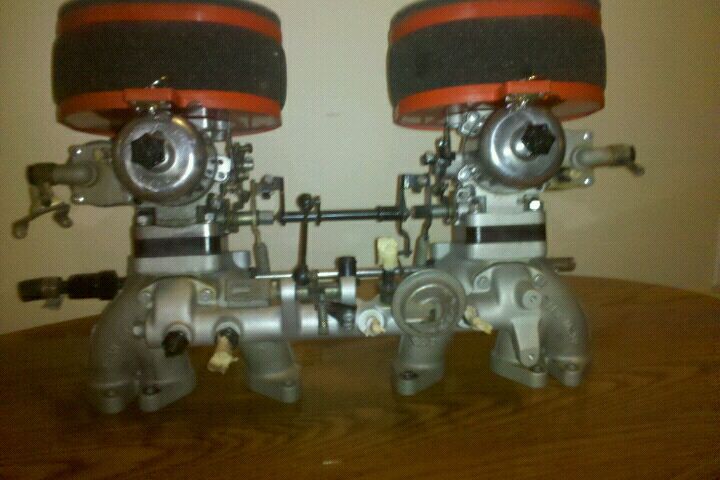

Ok, hopefully this pic will work out better.. And as far as my screen name goes that's the name of the car haha. (It's a long story) But I will check the spark plugs and see what's going on with them and Ill do them one at a time this time LOL.. I really don't want the 4-barrel, I would love to put these carbs on like they were originaly supposed to.. So if ya'll can tell me if I have everything then I can get rid of the old carb.. :) thanks!
[ATTACH]40508[/ATTACH]
From what I can tell you are pretty complete. You can compare to some of the photos on our web site and/or buy the JUST SUs dvd and follow it through the process. we can come up with any of the litle pieces you may be missing.

The Carb's pictured are S.U.'s manufactured under license by Hitachi.
