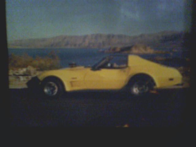

I have done this with my 74 corvette in the past (on the west coast) and the shop gave my car $1500 worth of work/paint for $800.
This is just what I did for my driver/toy not show car paint just looking damn good at a fair price. All said and done I had about $1800. total in the redo for the body and glass. If you are wanting tint on your glass this is the time with it out. Here again less money if they dont need to deal with the whole car.
