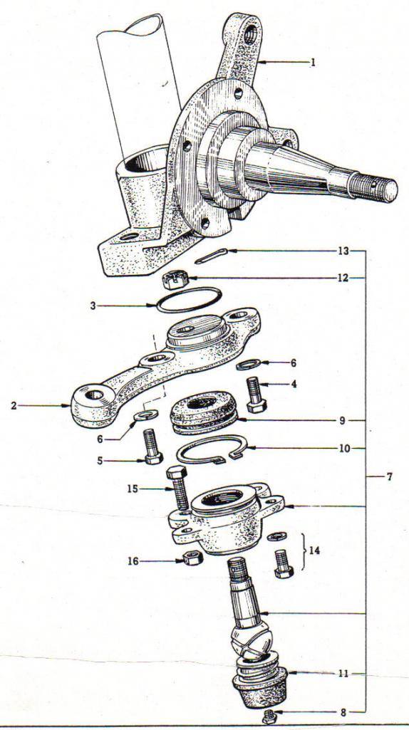

Geezer is the dust cover #9 on your picture? If it is do you know where I can get one or the whole ball joint?
Yes #9 is the dust cover. The dust covers come already on the ball joints when you buy them. Depending on your budget you can buy new balljoints from the Nissan parts counter or from a dozen other aftermarket parts supply houses. I would expect the OEM part to be the highest priced and also the one with the longest life expectancy but most of us opt for one from an alternate supplier.

The only rubber in that area would be the "O" ring that is on the steering knuckle arm (#3) and the dust boot John pointed out (9) in this illustration.
Bringing back an old thread here, where can I find the full illustration that geezer attached to post #3? I don't see it in my FSM and I'm interested in the components' names. Or the shortcut method: what are the official terms for items #1 and #2?
