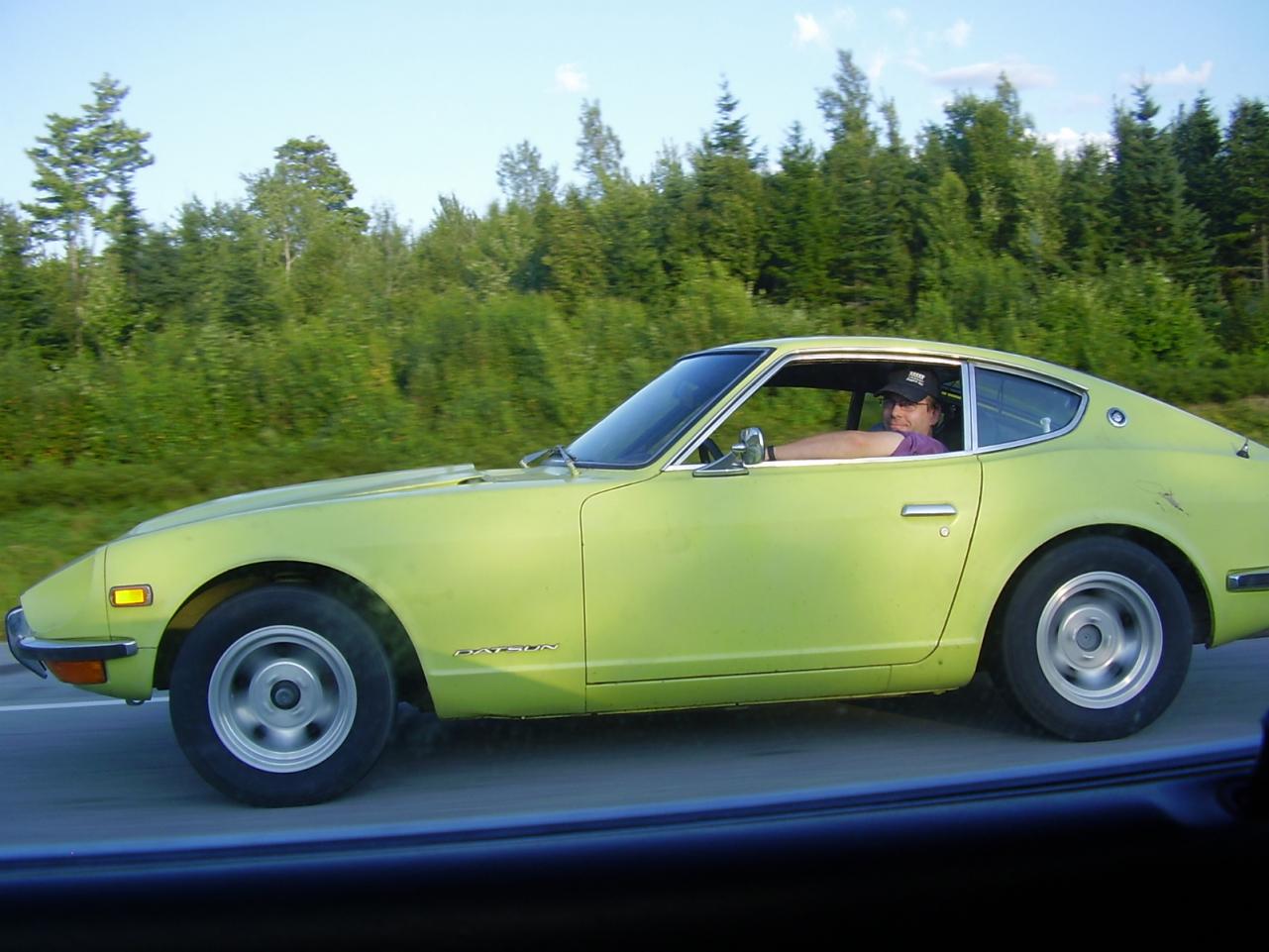

For early cars, I'm very fond of 919 (yellow), 918, 903 (blue) or the 905 (red) of my car. But your blue interior is only good with white or blue.
More info on color choices can be found at http://zhome.com/History/colors.html
Thanks Arne, I've got that on my colour chart, like the name too! you don't know of a car I could see a picture of in that colour do you? Unfortunatly there was nothing much left of the blue interior and I have black one like new, I will get some 904 mixed up and try it. Thanks for the link!
I like that 112!
