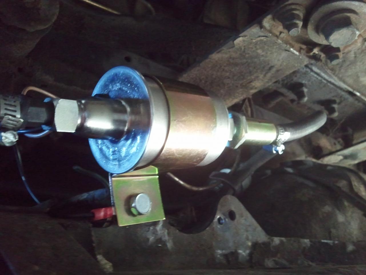

In fact, having delt with this type pump before on my previous Z purchase I am fairly certain it is an injected Z pump that has been installed.
Here's a picture of the fuel pump that is installed.
picture.php?albumid=393&pictureid=2773
Edited by EverRude
Added picture
You can use high pressure pump - NO PROBLEM - - the Holly regulator is most likely FINE. The question is which springs are in that regulator. That regulator is available in either LOW or HIGH pressure versions - and the only difference is which relief springs you are using.
If the pump is putting 9 psi on its outlet - that's fine!! Fix the regulator!! The rebuild kits are about $15.00 as I recall. The kit contains both high and low pressure springs...
BTW - the pump pictures looks a lot like this
http://www.holley.com/12-802-1.asp
Note also that the above pump comes with pressure regulator 12-803 4.5 to 9 psi. Regulator 12-804 is 1 - 4 psi. They are the same body - just different relief springs.
See: http://www.holley.com/types/Fuel%20Pressure%20Regulators%20-%20Carbureted.asp
Don't waste your money buying a new pump - when the one you have is working. I've ran an electric pump on my 72 Z since 1975 and only had to replace it once in 35 years. Mechanical pumps fail just as often, and they don't keep the fuel lines pressurized.

Well I did get that new pump. Replaced lines and added prefilter to pump. Didn't need to do anything to restrict return line because that return is tiny. Too tiny IMO. Anyways I now have 3psi pressure at the carbs according to the inline guage.

That other fuel pump was a holley. Was so dirty I couldnt read the label till I got it off and cleaned it. The new one is much much quieter anyways. Much prefer it. I'll keep the holley for potential future upgrades.
