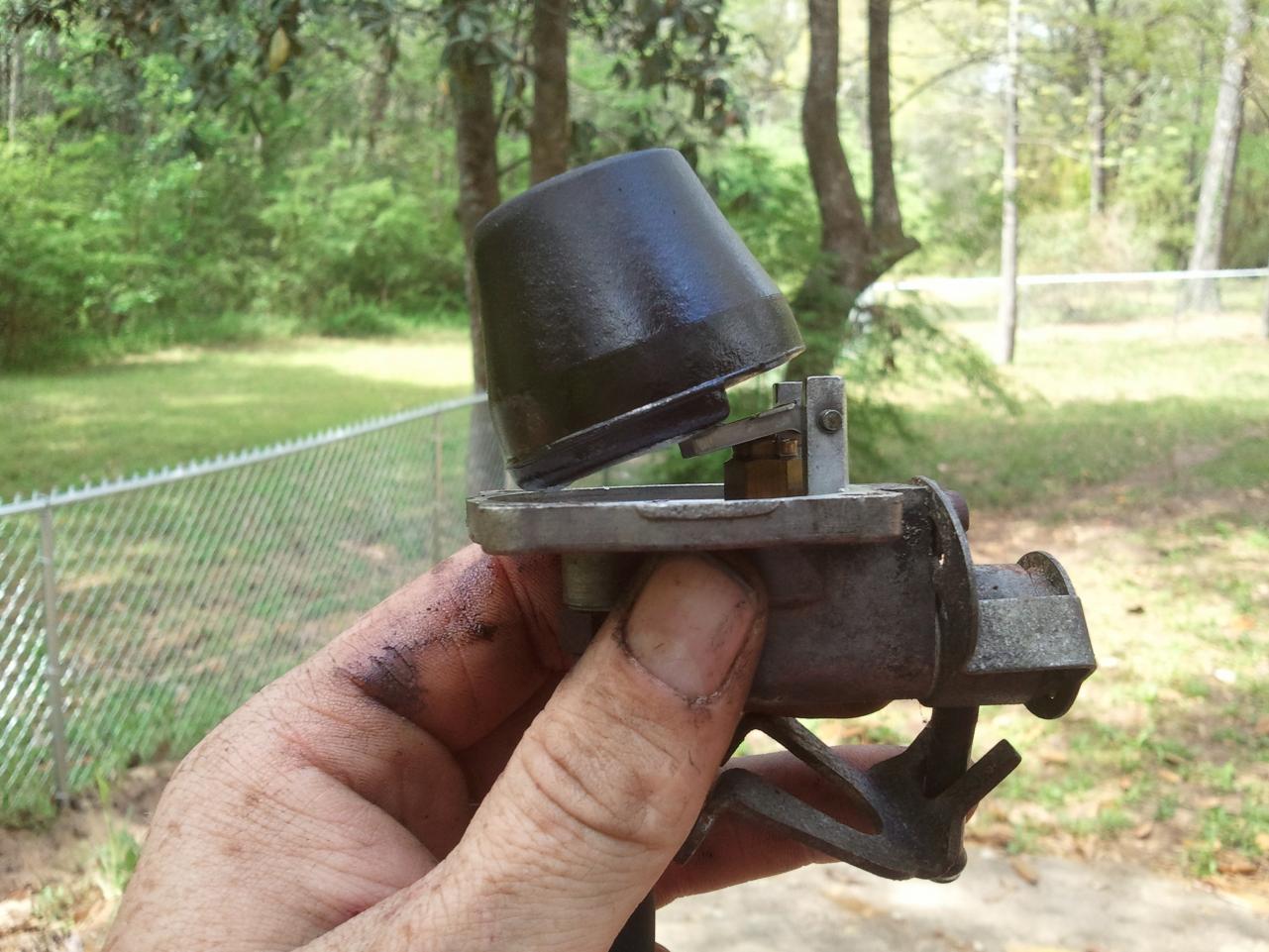

Carbs wouldn't tune. Pulled float bowls and discovered the floats were maxed out high. Car would run faster if I raised the cylinder while she idled. Running extremely rich. Including a pic of the float levels below. Now I need new gaskets before I can continue. Should have thought of this when I ordered the Unisyn amd Just SU dvd. Didnt want to buy whole rebuild kit though it could use it. But shoulda atleast bought float gaskets.

Got my float gaskets in. Thanks Bruce. Nice to see you guys were really awesome about tossing gaskets into a envelope and just charging me for a stamp rather than tossing them and a big box like some places and charging me twice the price of the gaskets for shipping and handling an uneccessary box.
Adjusted floats and installed. Sat down in car ready to crank her over and got nothing. Battery was dead. Dang it. Coulda sworn I disconnected that thing. Never good idea to leave a battery in an old car connected for days knowing it'll just be sitting there. Especially one with known wiring issues.

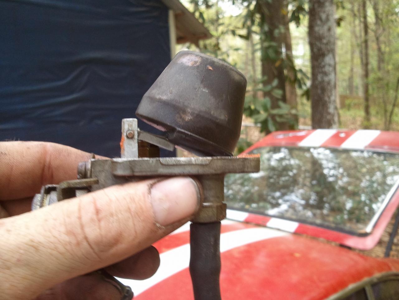

While tweaking I noticed as before the aft carb was doing all the work. The front carb seemed to have no effect. I pull the forward float. Dry. Apparently the float adjustment I made is a bit excessive for that float. It shuts off the needle valve and allows no fuel in.
Is the float hieght the same for the original needles and his ball valve or are the needles set at a different height?
