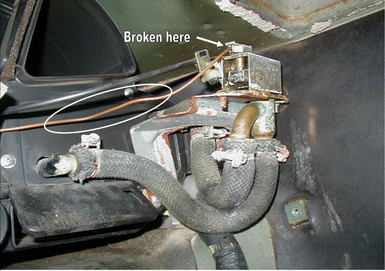

HELP - MY PROBLEM/QUESTIONS??? - my heater was eliminated by the previous owner who looped the heater hose from the water pump to the block -and bypassed the heater coil all together - in researching further w/ helpful steps from this sites threads I did a total teardown and diagnosed a few problems under the dash - it appeared that the curvy heater hose was replaced by a straight one that made a kink in the hose dis-allowing the anti-freeze to flow freely creating a leaky weak spot around the valve - besides 2 clamps not being placed correctly - so all in all the previous owner got lazy and just eliminated the heater - i had the heater coil re-tinned (no leaks) - checked all the vacuum tubes - replaced all the 5/8 heater hoses w/ new - in putting everything back together i snapped the copper hosing off the stem (photo attached) - i took the stem out and carefully re-bored w/ drill bit
QUESTIONS -
1) - the stem where the copper hosing is attached - it seems to have no relavancy as a valve and appeared to be just welded to the top of the stem - can i just re-weld to existing hole w/o worrying if the hollow copper tube is flowing correctly ? what does this stem/hollow tube do??
2) In reading a few threads i found that a few have eliminated the heater valve w/ another one from other vehicles and/or just replaced w/ a gate valve in the engine compartment - & when u want heat u just turn on the valve - but i see no diagrams & it seems as if im back to square one w/ no flow to the heater coil - i am not the one to "jerry rig" but to stick to the OEM parts - but do want heat anyway possible
Any input/photos/diagrams would be appreciative

Since most of these cars through the past two decades, mine included, are fair weather drivers, the coolant sits in the core and valves and makes corks. Remove, clean, install repeat, on all components outside the engine system.
