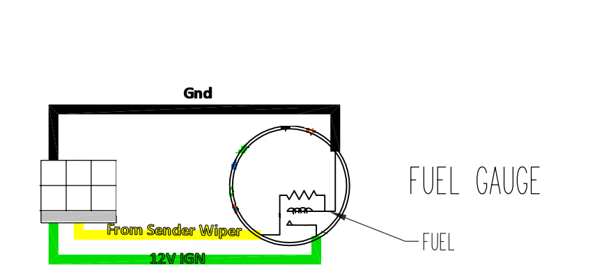

Here are schematics for the fuel sender and the gauge.
If you have the wires reversed then you may get the problem as the sender wire (yellow) may ground when you connect the sender to the tank <<<<watch out for sparks when you do this!!!>>>>
