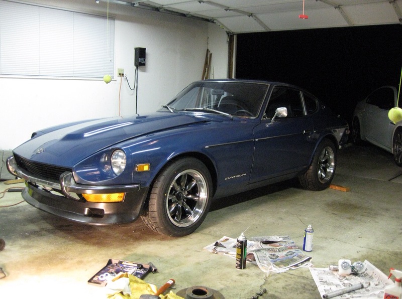

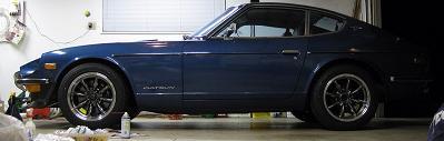

Here are some pics.
First two pictures are of my first '70 Z w/ Tokico Shocks/Springs, Rota RB-R +10 offset 16x8 and Type I Airdam from MSA. 225/50/16 Falken Azenis RT615K FRONT AND REAR.
Second picture is of my current '72 Z w/ Tokico Shocks/Springs, Rota RB-R +10 offset 16x8 and 80's airdam (basically same as a stock set up because I use stock valance). 215/45/16 Falken Azenis RT615K Fronts and 225/50/16 Rears.
