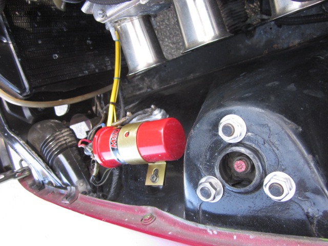

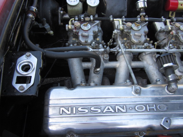

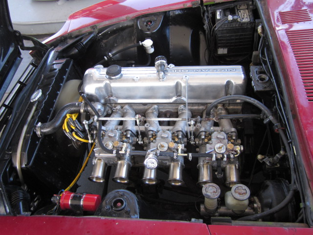

OK, I can assist you with this topic.
1. Remove any overspay from parts.
2. Clean the parts (Sand Blast is prefered) and then replate or paint.
3. Replace nuts and bolts with correct washers.
This will refresh your engine bay! These are "before" pictures.
